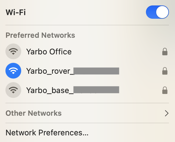

Connect your laptop Wi-Fi to the Rover’s hotspot (e.g., Yarbo_rover_XXXX
Default password: 87654321

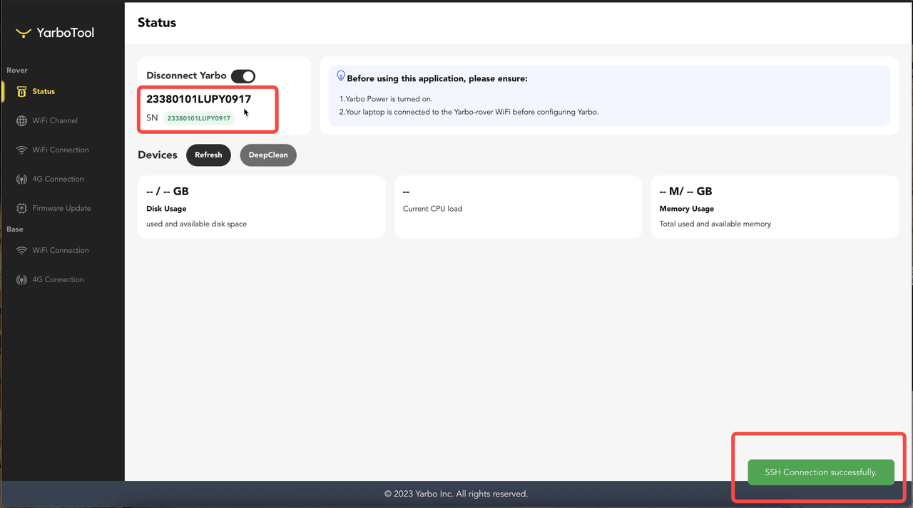

- Open Yarbo Tool.
- Enable “Connect Yarbo.”
- Verify the serial number shown matches your Rover.

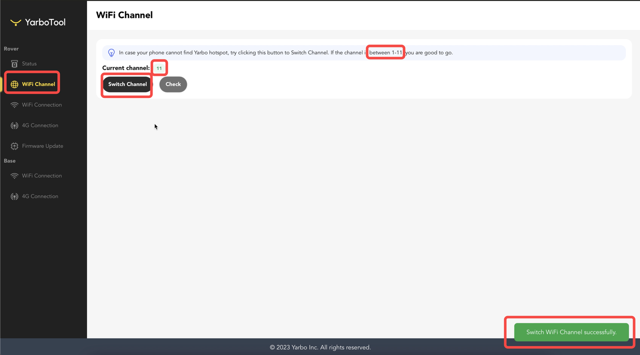

- From the left menu, select Wi-Fi Channel.
- Click Switch Channel and confirm the channel is between 1–11.
⚠️ Note: Loading time may be long or the interface may appear stuck. If so, check that Wi-Fi remains connected.

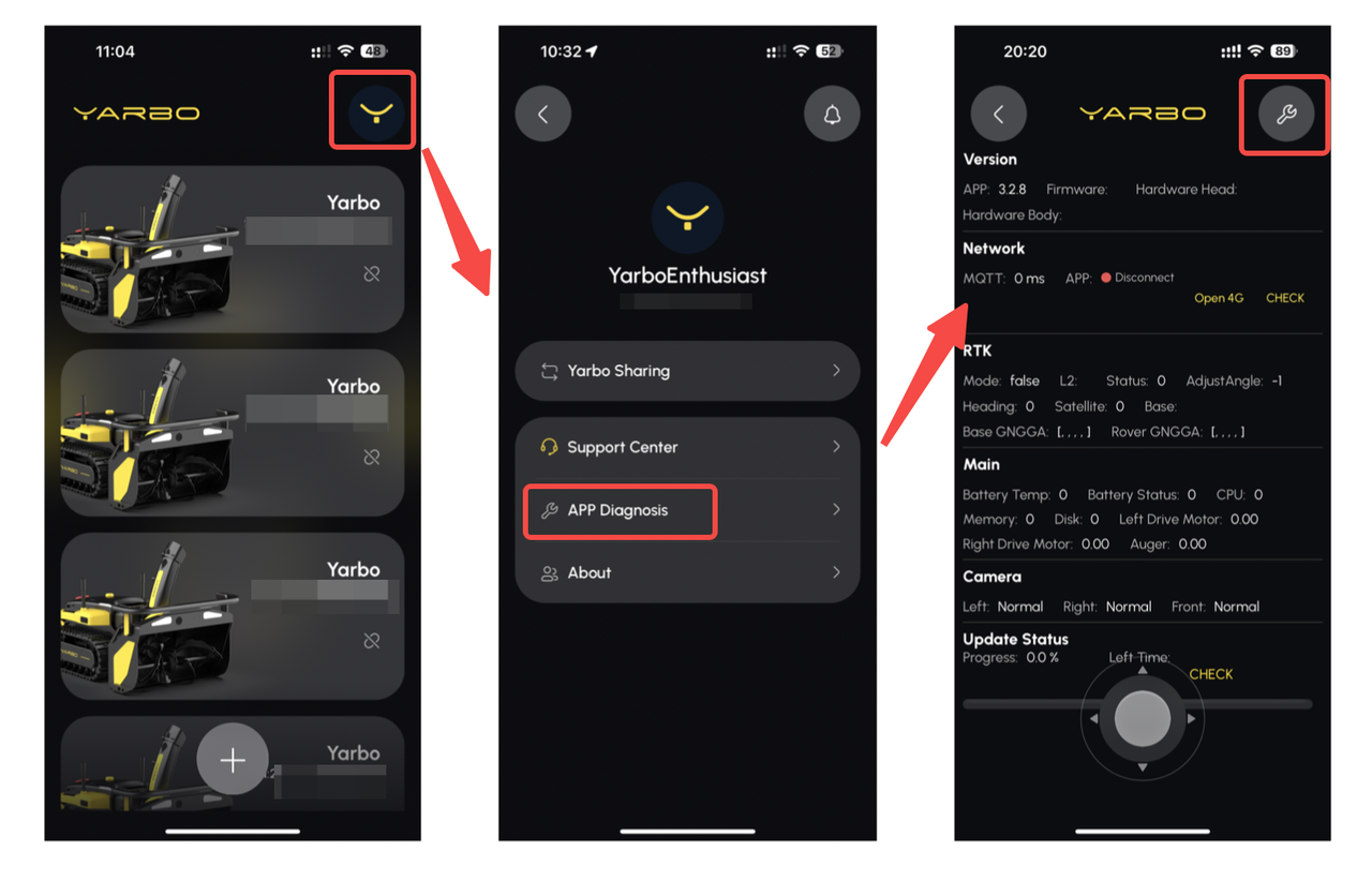

- Log in to your Yarbo account.
- From the Account homepage, select App Diagnosis.
- Click the settings icon to open Yarbo Fix.

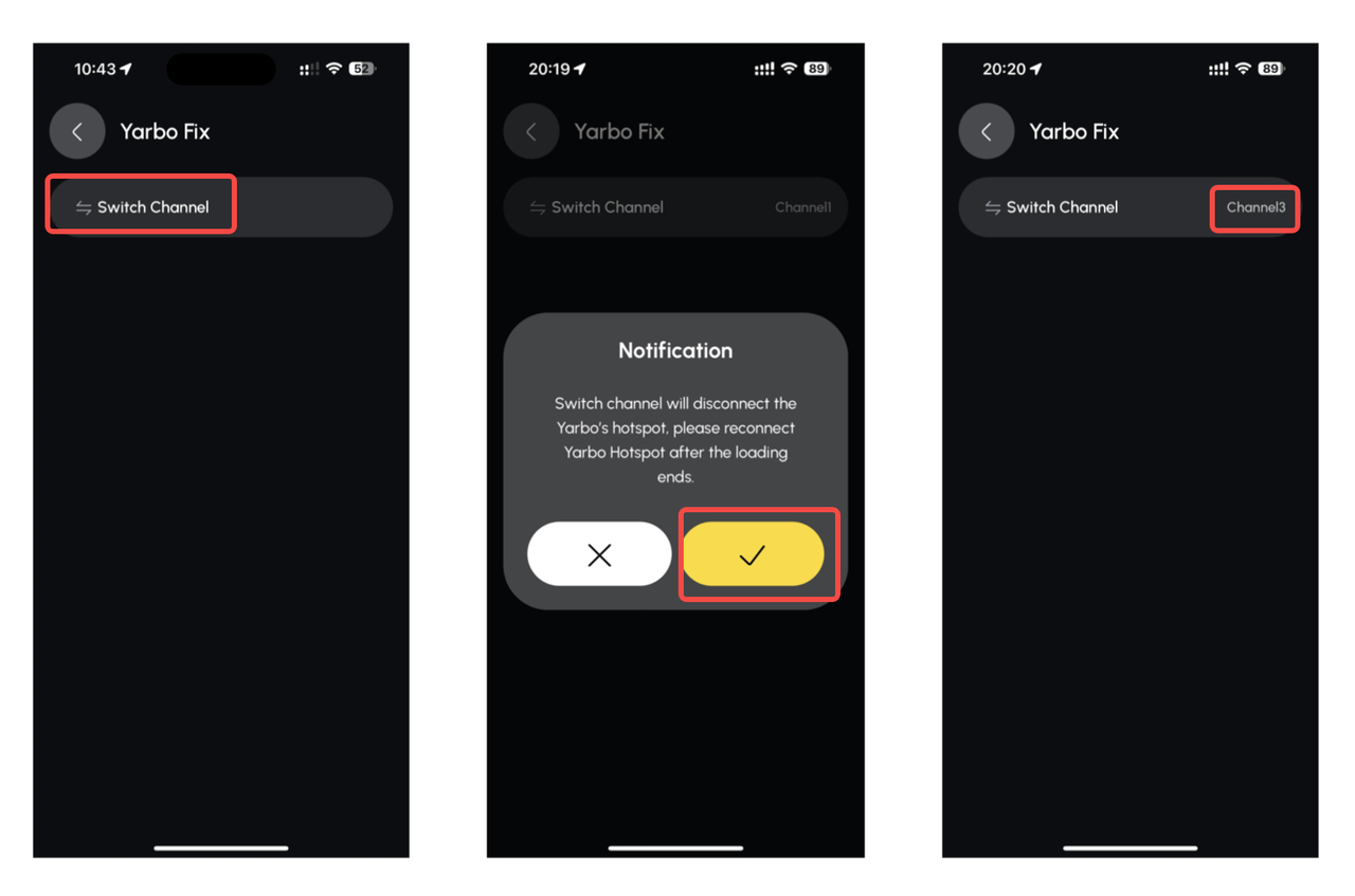

- Select Switch Channel.
- Confirm the action by clicking the ✅ checkmark icon.
- Wait for the page to load.
- A notification will confirm the channel was switched successfully.
