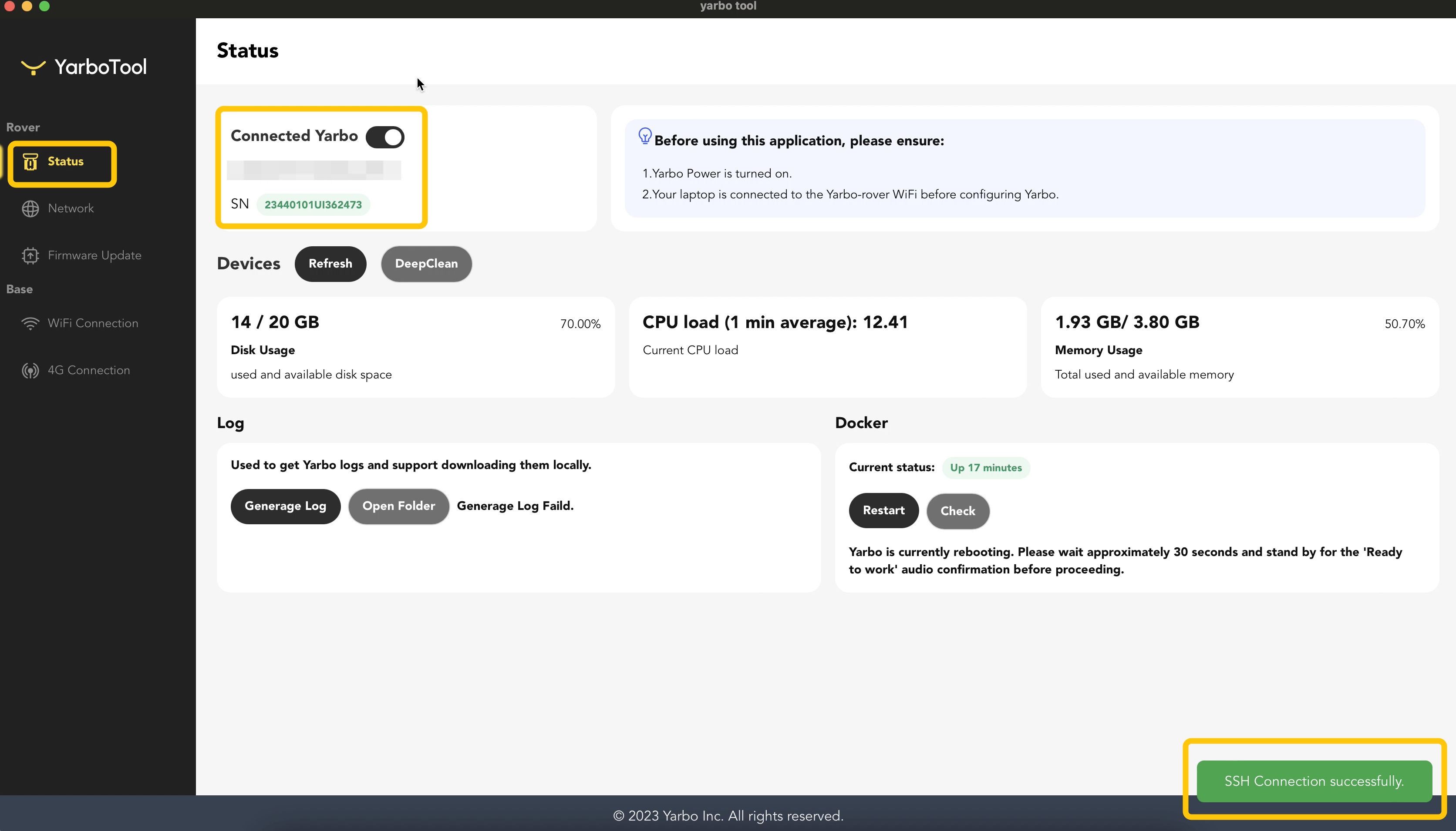

Install the latest Yarbo Tool on your laptop.

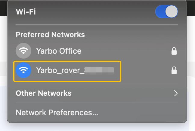

Connect to the Rover’s hotspot (e.g., Yarbo_rover_XXXX
Default password: 87654321

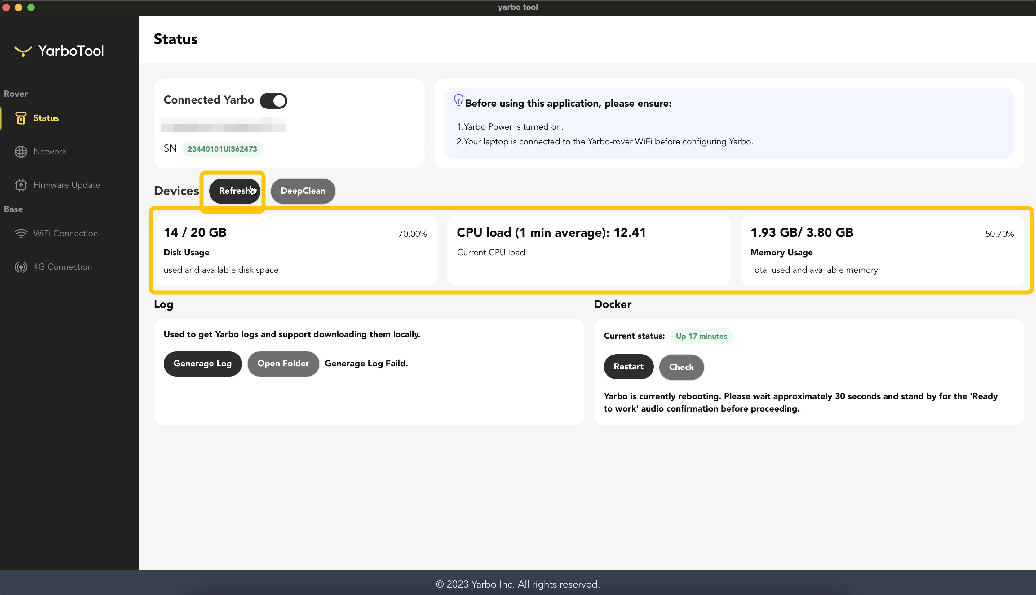

Open Yarbo Tool → “Connected Yarbo”.
Confirm the serial number matches your Rover unit.

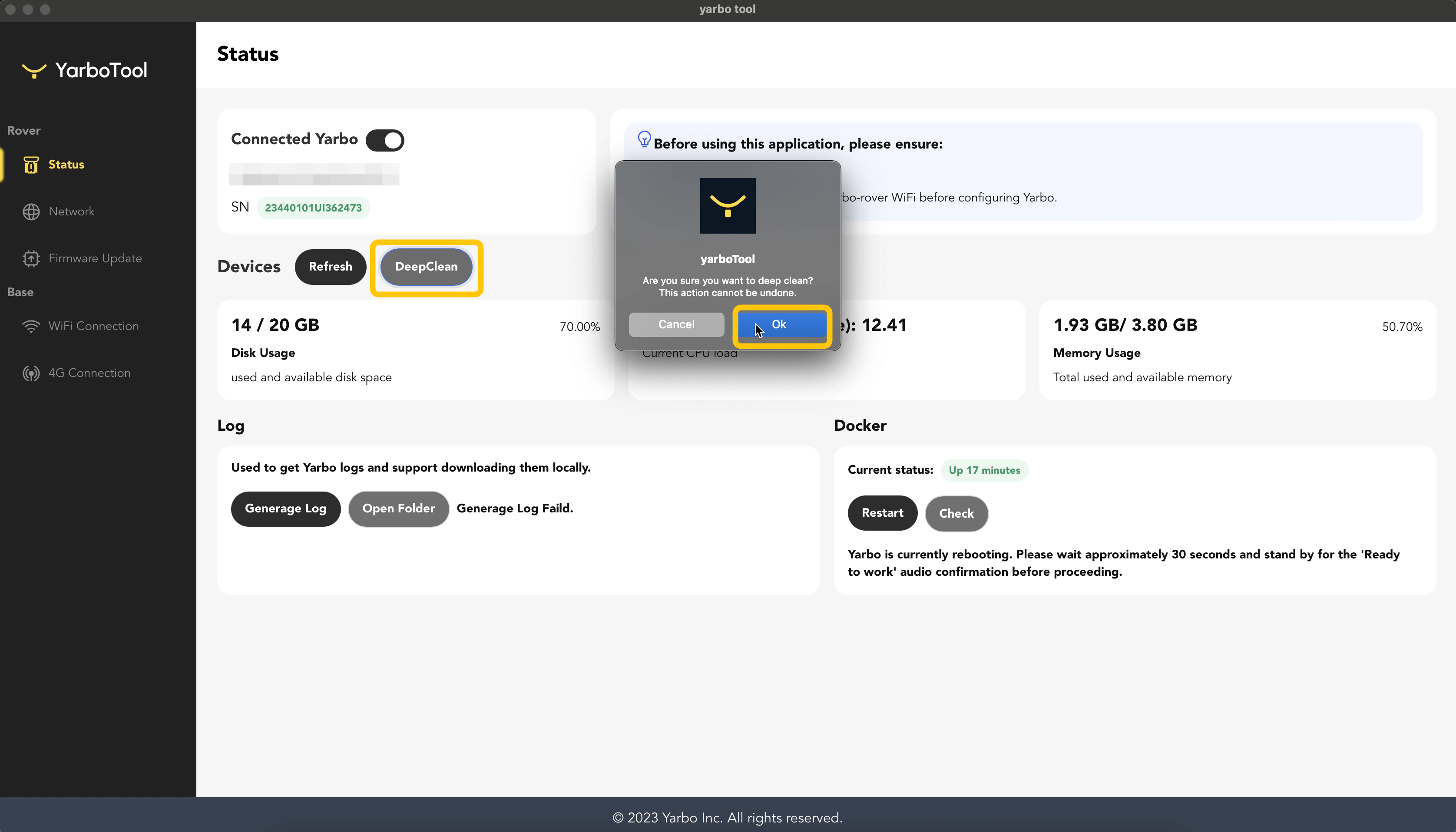

Click Refresh to review system resource usage.
Deep Clean
Select Deep Clean → Confirm OK .
Clears cached data to free storage and improve performance.
Select Generate Log .
Exports diagnostic data for technical support.

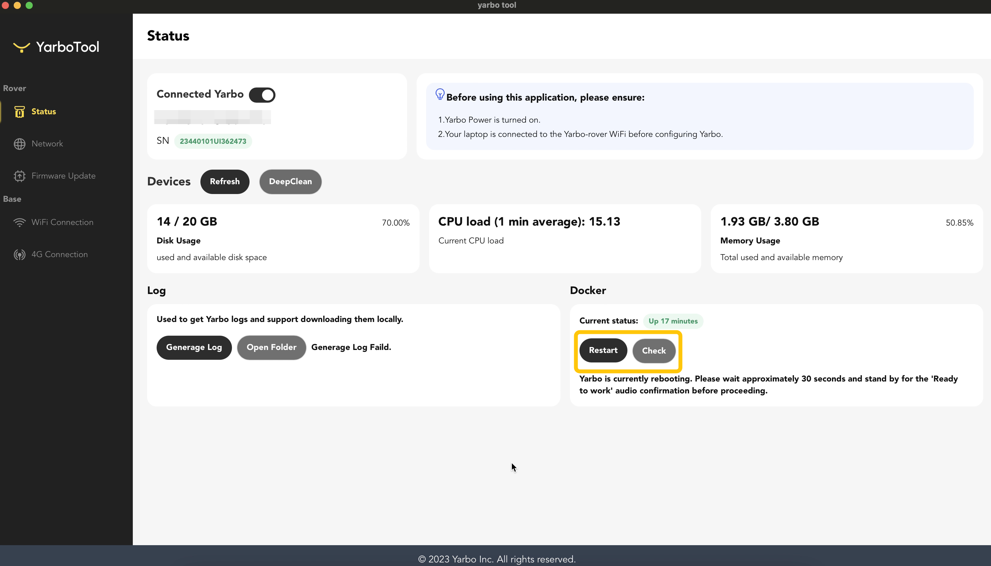

Click Restart to reboot Rover software.

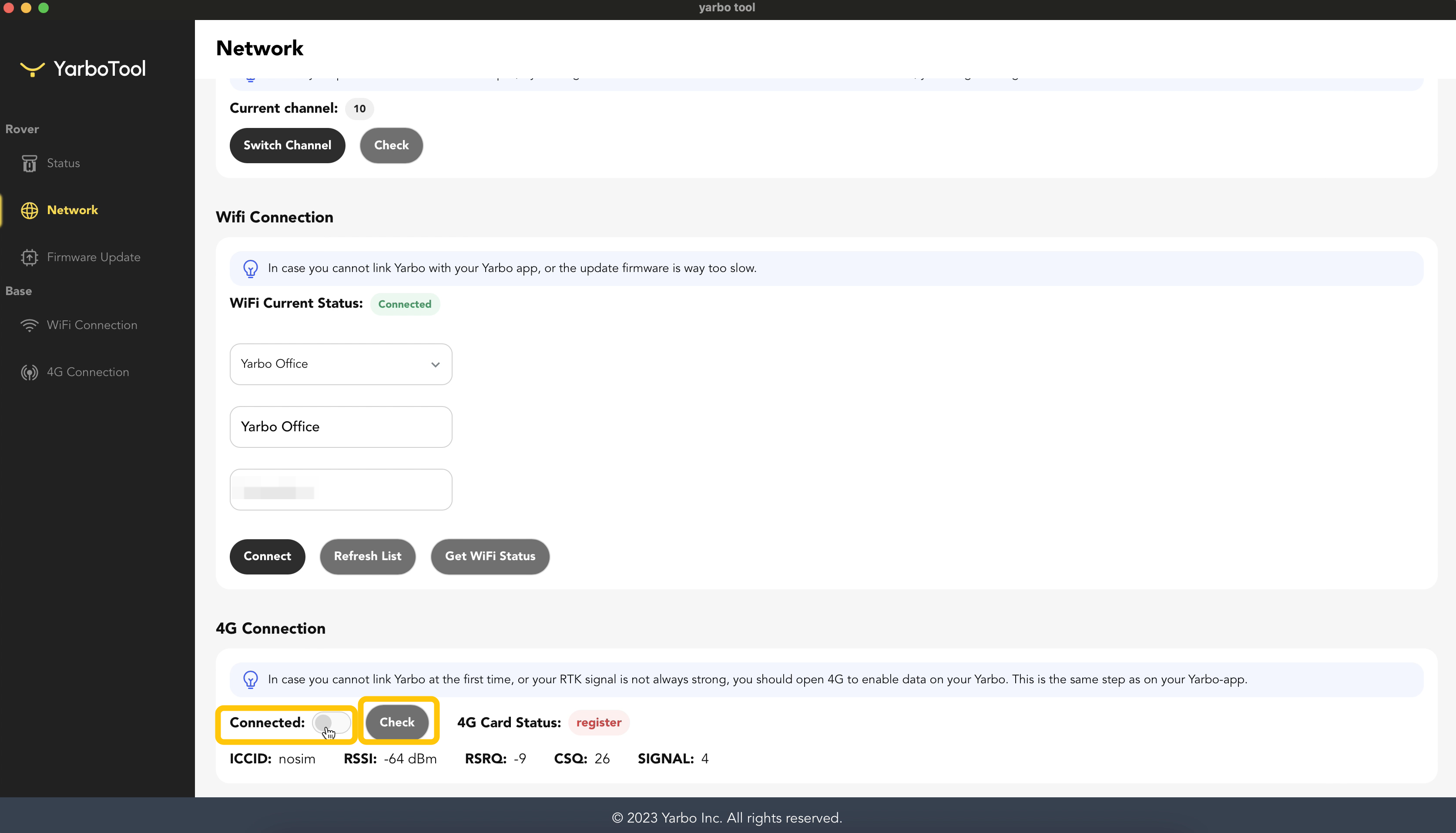

Note: The loading time may be long or the interface may be stuck, please check whether the Wi-Fi is disconnected.

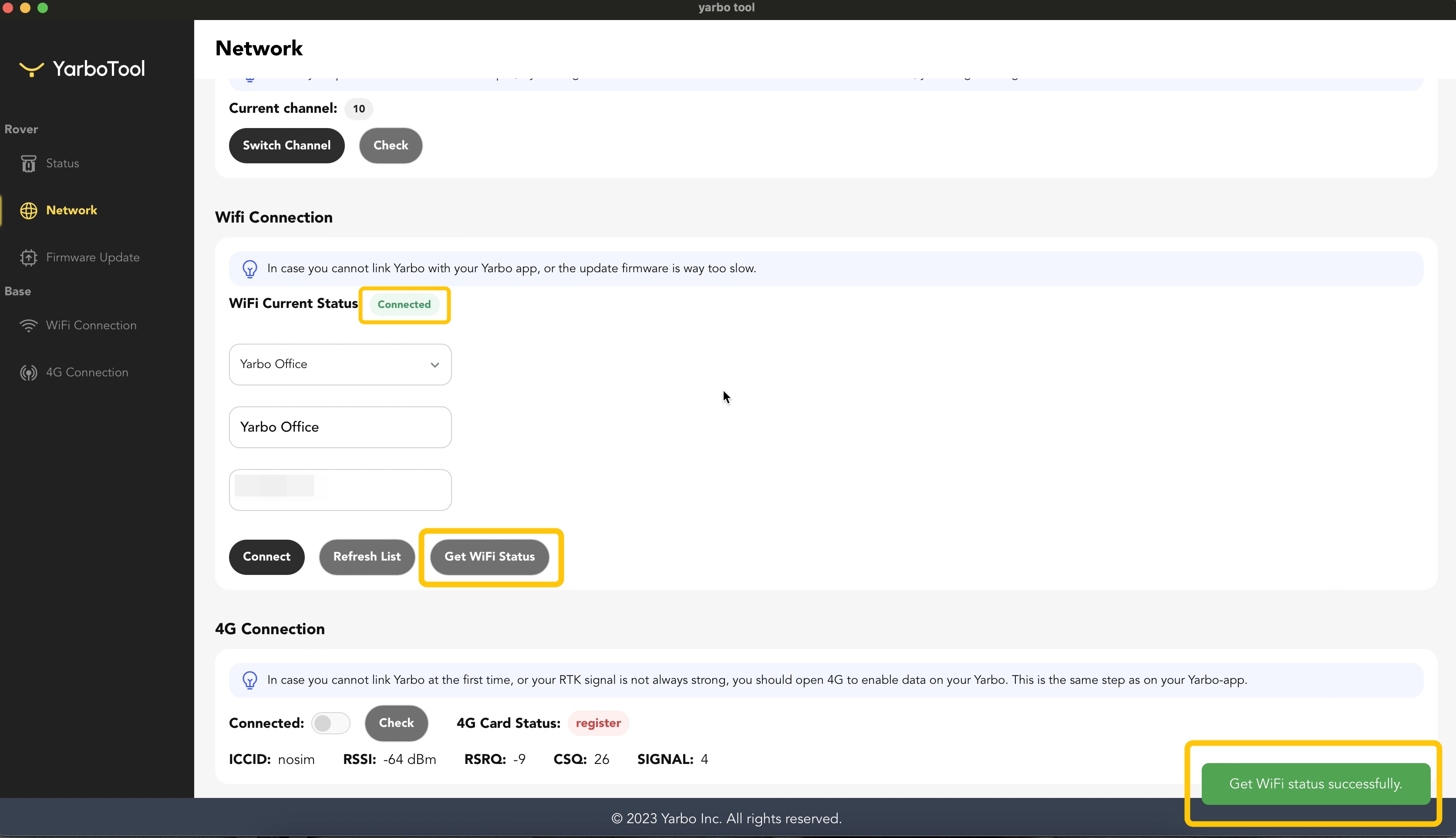

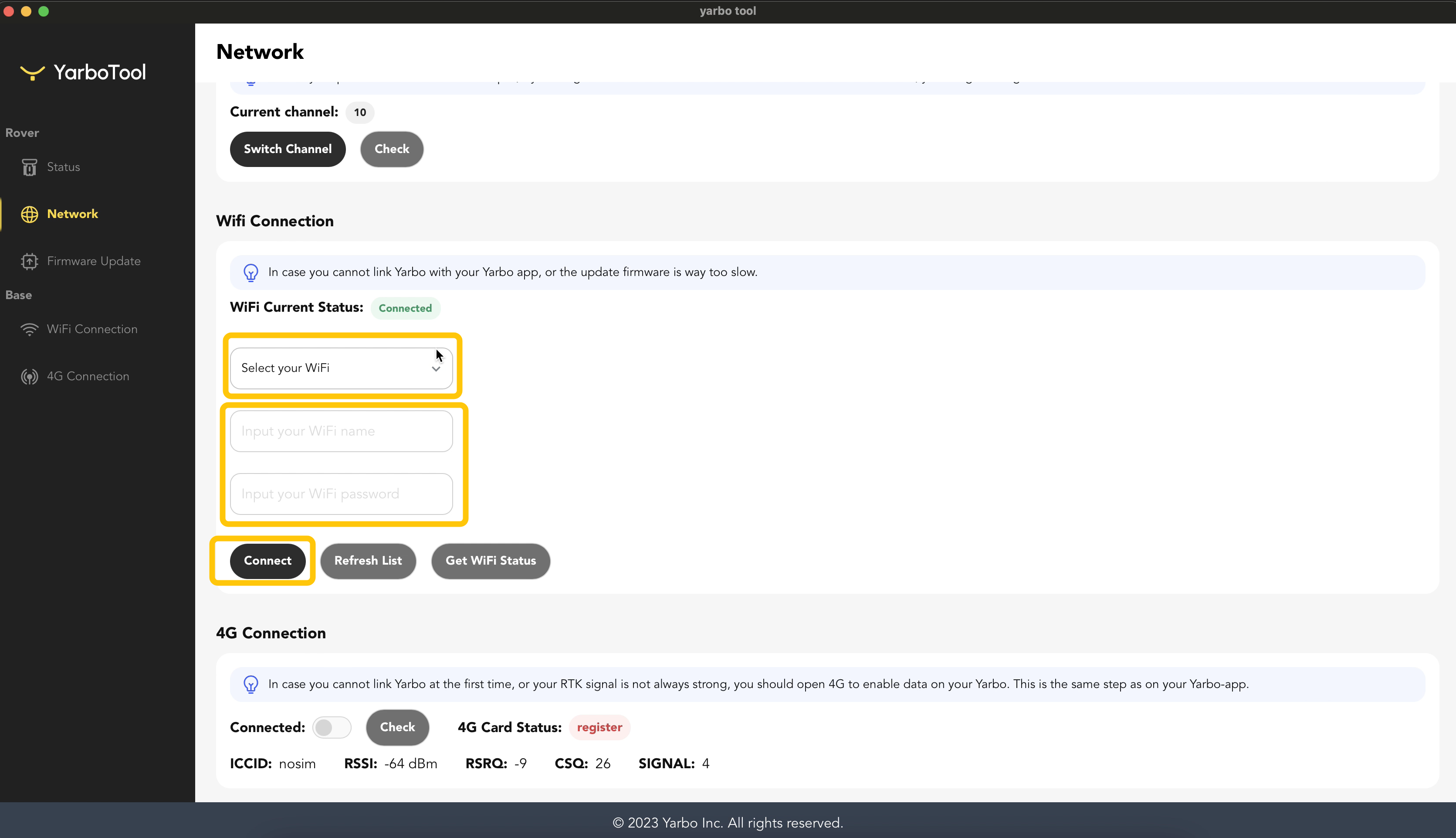

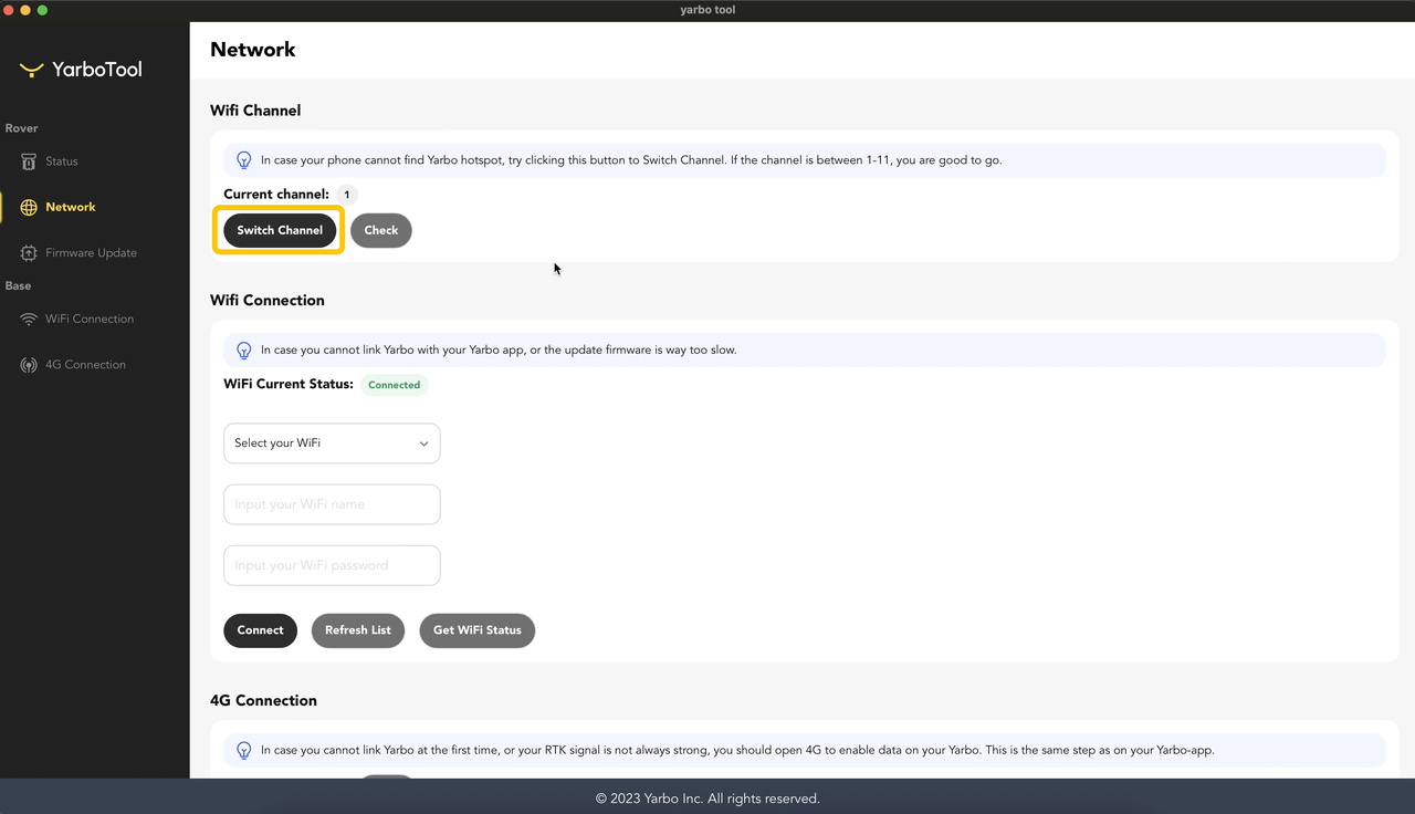

Go to Network → Wi-Fi Connection .
Choose SSID from dropdown or manually enter SSID + password.
Select Connect → Confirm status shows “Connected”.
Once connected, select the "Get WiFi Status " button to confirm the connection status. If the Wi-Fi connection is successful. The Wi-Fi Current Status will be displayed as "Connected ".

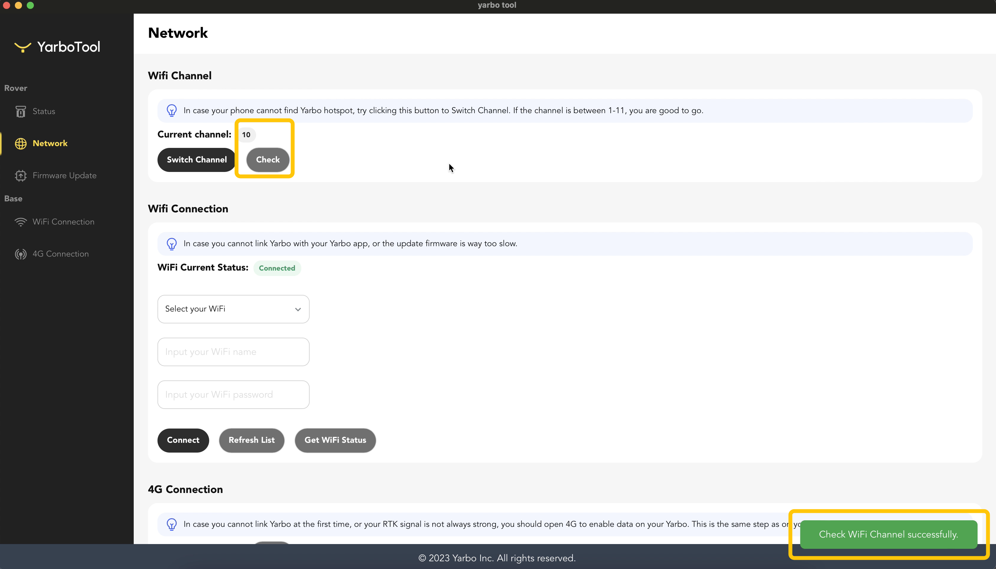

In Network → Switch Channel , ensure channel is 1–11.
If stuck, check Wi-Fi stability.
Navigate to 4G Connection .
Enable toggle → Select Check to view connection details (ICCID, RSSI, RSRQ, CSO, Signal).

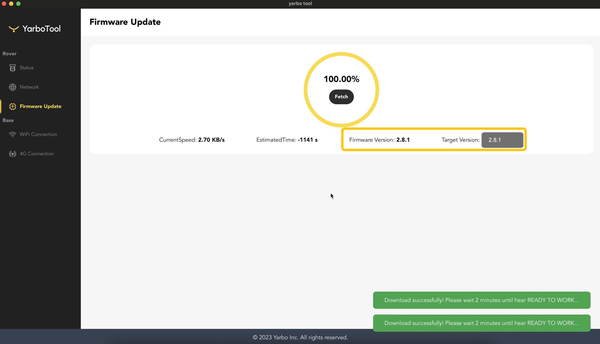

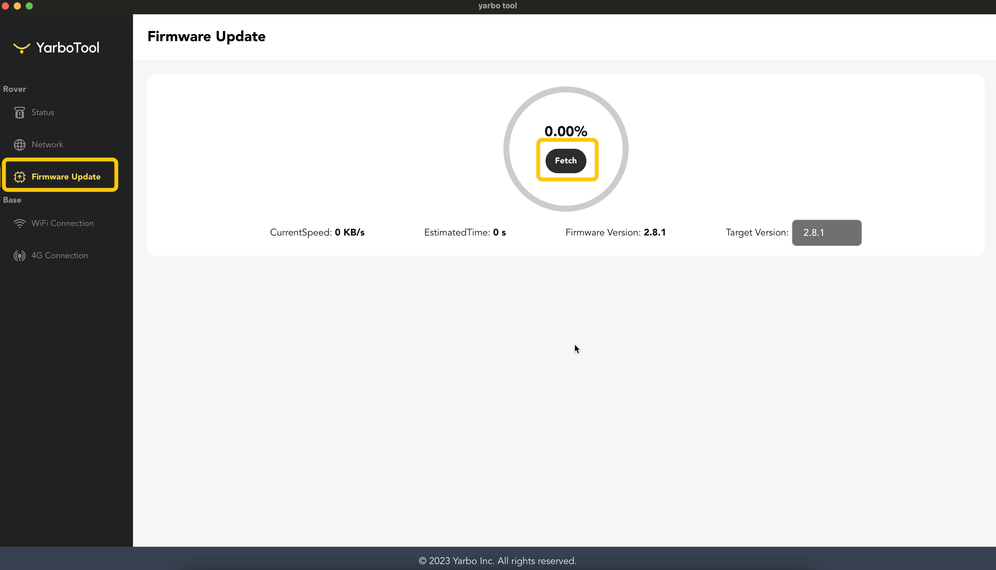

Go to Firmware Update .
Confirm Fetch = 100% to ensure latest firmware installed.

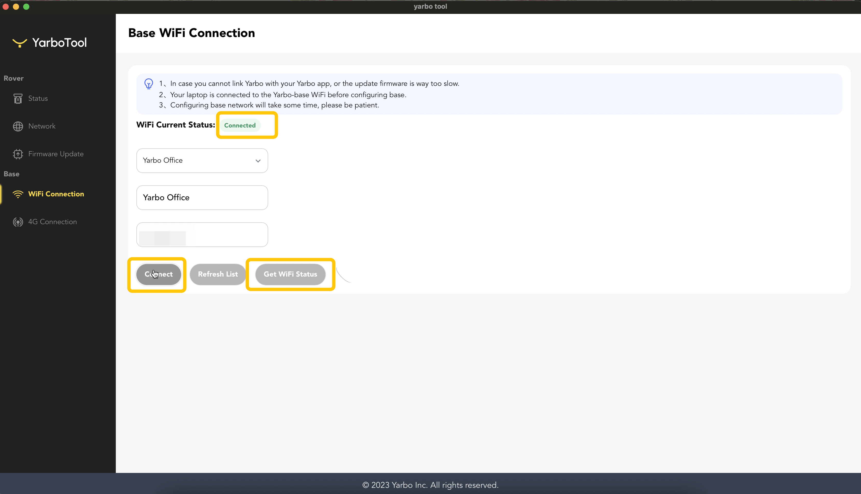

Install Yarbo Tool on your laptop.
Connect to Base hotspot (e.g., Yarbo_base_XXXX
Select SSID from dropdown or manually enter SSID + password.
Click Connect → Confirm status shows “Connected”.

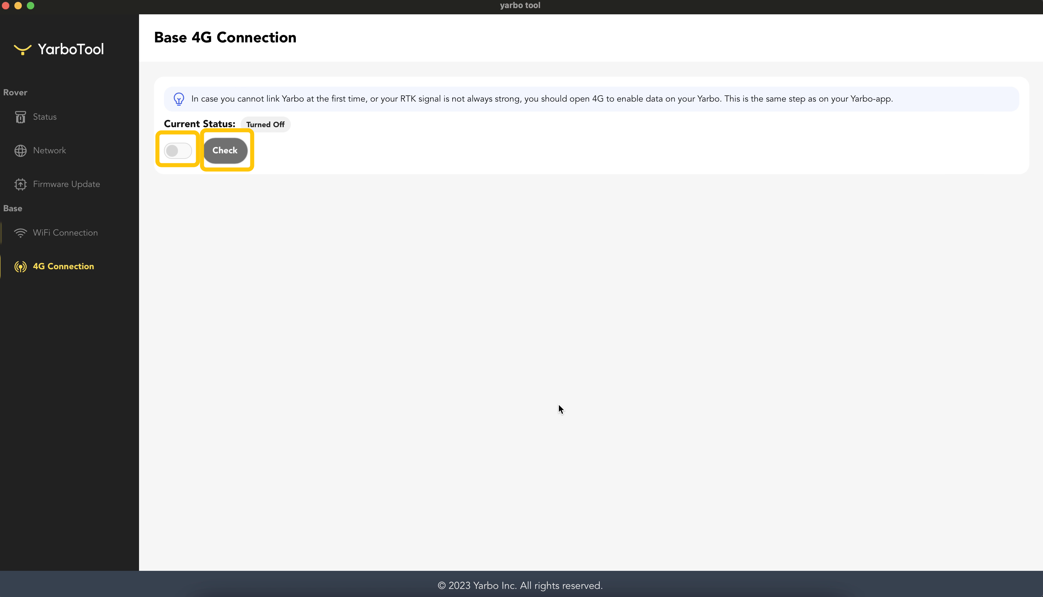

Enable 4G Connection → Click Check for status details.
