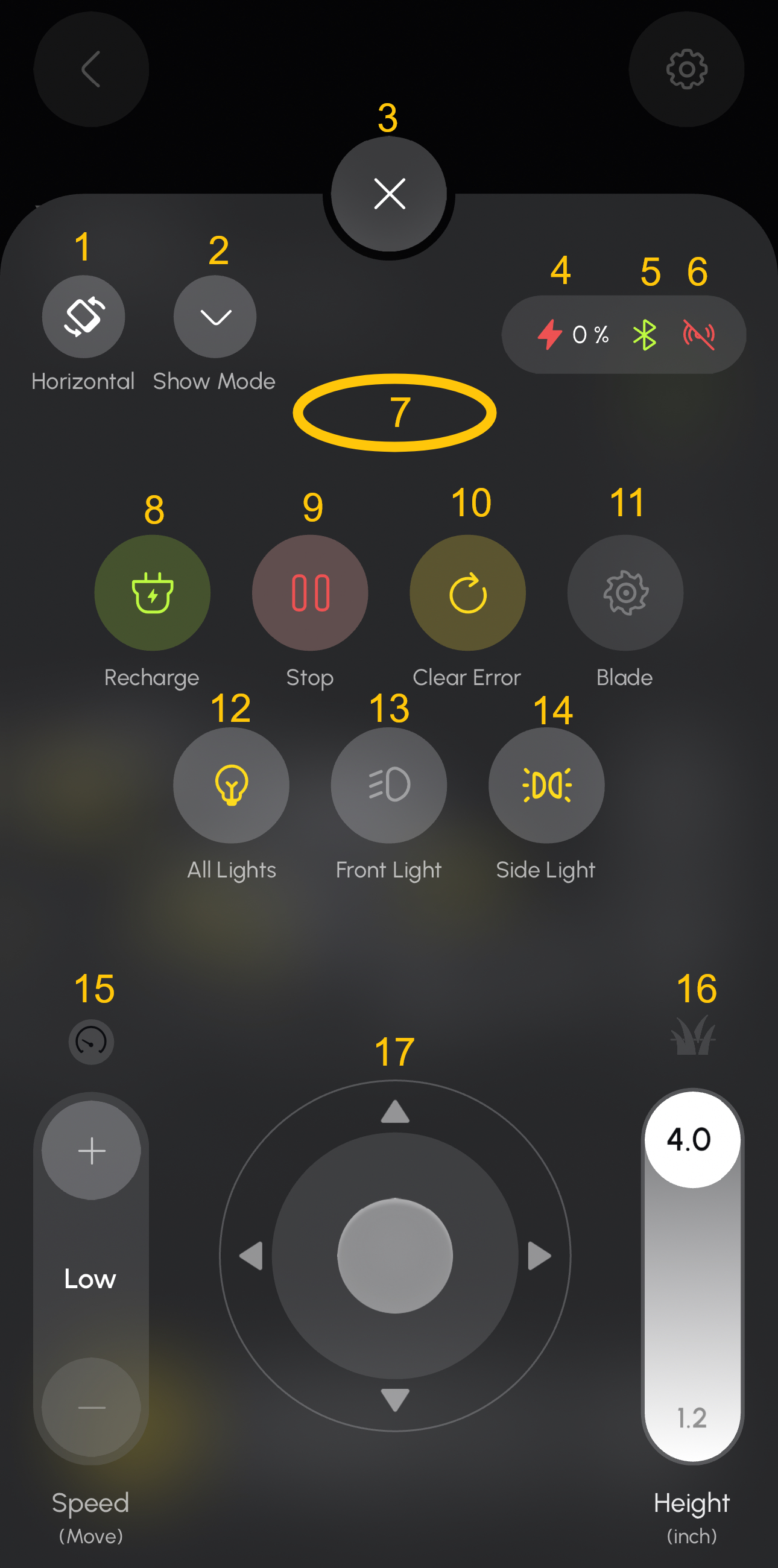

The Yarbo App Controller gives you full control over your Yarbo and allows you to operate it conveniently using your mobile device. Understanding each button and function is key to maximizing Yarbo’s efficiency. Let’s dive into the features and how you can use them to enhance your experience.

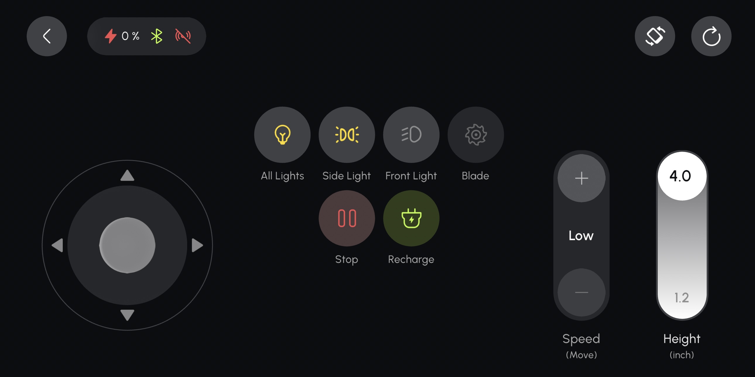

This button allows you to toggle between horizontal (landscape) mode and vertical (portrait) mode for the app interface. Tap the button to switch to the orientation that best suits your needs.

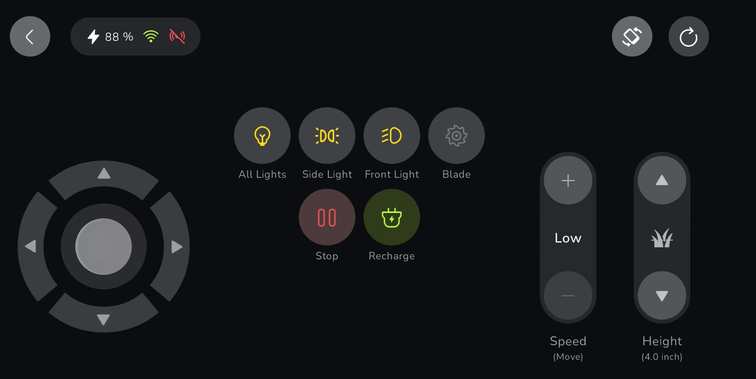

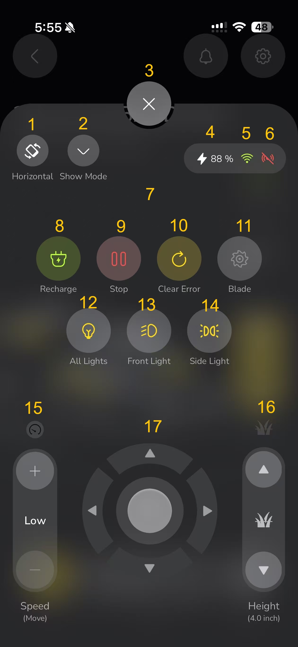

This icon indicates Yarbo’s current connection status and the type of network it is using. The icon will change based on whether the device is connected via Bluetooth, HaLow, Wi-Fi, or 4G cellular.
This button allows you to turn the blade on or off. Tap the button to activate the blade when you’re ready to operate Yarbo, and tap again to deactivate it when not in use. Always ensure the blade is off when performing maintenance or making adjustments for safety.
This button lets you switch between low speed and high speed modes. Use low speed for better precision in challenging areas and high speed for faster operation in open spaces. Choose the appropriate speed based on your terrain and mowing conditions.
Use this slider to set the blade height for mowing. Keep in mind that setting the blade below 2.7 inches may increase the risk of potential damage. Adjust accordingly based on your lawn conditions to ensure optimal performance and durability.
