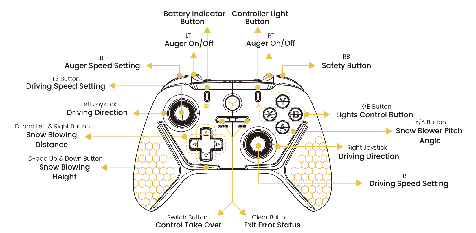

¶ Driving and Speed Controls
Left Joystick : Controls the driving direction of Yarbo (with safety button RB pressed).
Right Joystick : Also used to adjust driving direction for more precise maneuvers (with safety button RB pressed).
L3&R3 Buttons (Press Left&Right Joystick) : Adjust Driving Speed.
D-pad Up and Down : Adjust the Snow Blowing Height .
D-pad Left and Right : Control the Snow Blowing Direction .
Y/A Button : Set the Snow Blower Pitch Angle
¶ Auger and Blower Controls
LB Button : Control the Auger Speed Settings for better snow management.
LT and RT Buttons : Press and hold both LT and RT until the auger starts or stops.
¶ Safety and Light Controls
RB Button : The Safety Button , providing an additional layer of operational security.
X Button : Lights Control Button to turn on all the lights on yarbo.
B Button : Head Lights Control Button to turn on the head lights on yarbo.
¶ Control Status and Error Handling

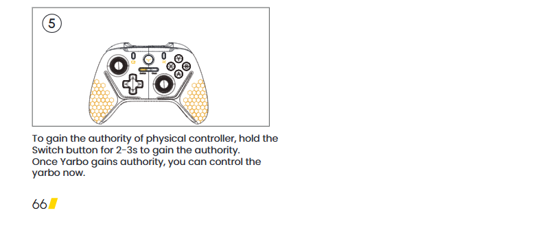

Switch Button : Control Takeover —use this to switch manual control over to the physical controller.
Clear Button : Exit Error Status —if the system encounters an error, press this button to clear the status.
¶ Battery and Indicator Controls
Battery Indicator Button : Check Yarbo’s battery status at any time.
Controller Light Button : Turn on the controller’s lights for better visibility during night or low-light operations.
Press and hold both LT and RT until the auger starts or stops spinning, then release.
Use the D-pad to adjust the height and distance of the snow blower’s output.
Press Y/A to set the snowblower pitch angle for more precise snow control.
Use the Left or Right Joystick to steer Yarbo smoothly along the driveway or pathways.
Press L3 or R3 to access the speed settings menu and adjust Yarbo’s speed based on your needs.
Only when the RB button is pressed can the unit be controlled for walking.

Press the Switch Button to take over control access from App controller.
