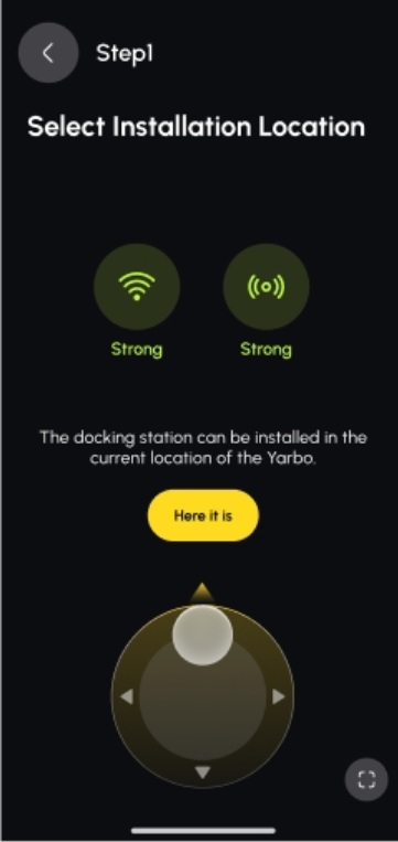

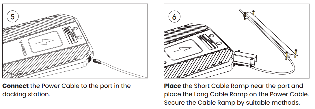

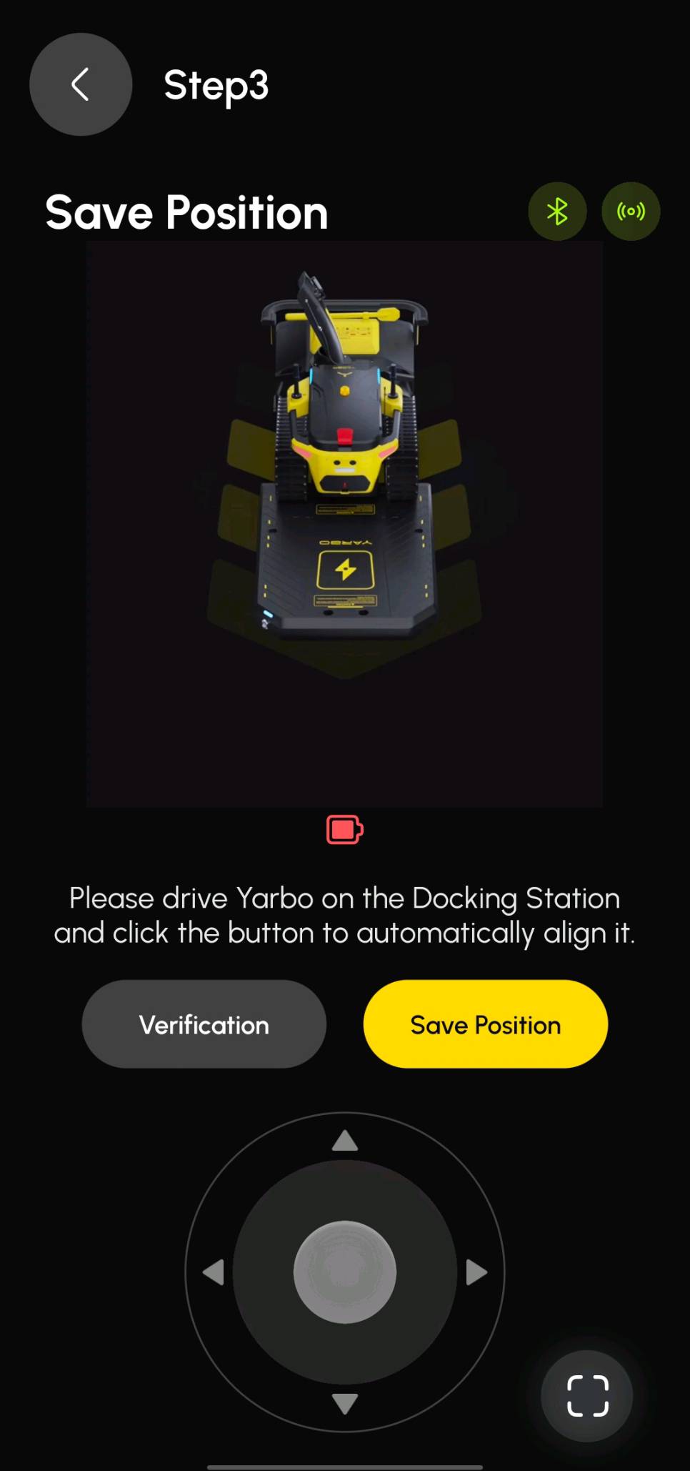

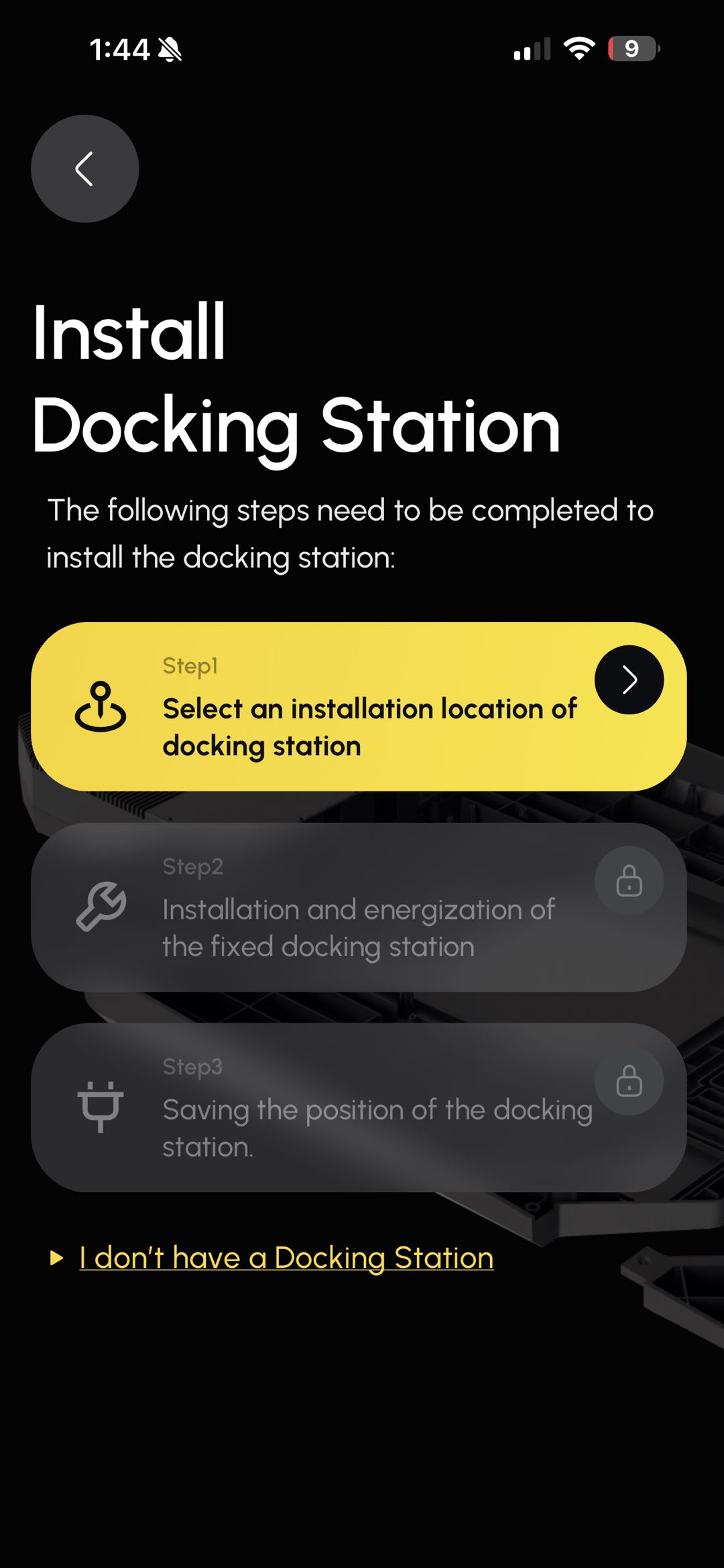

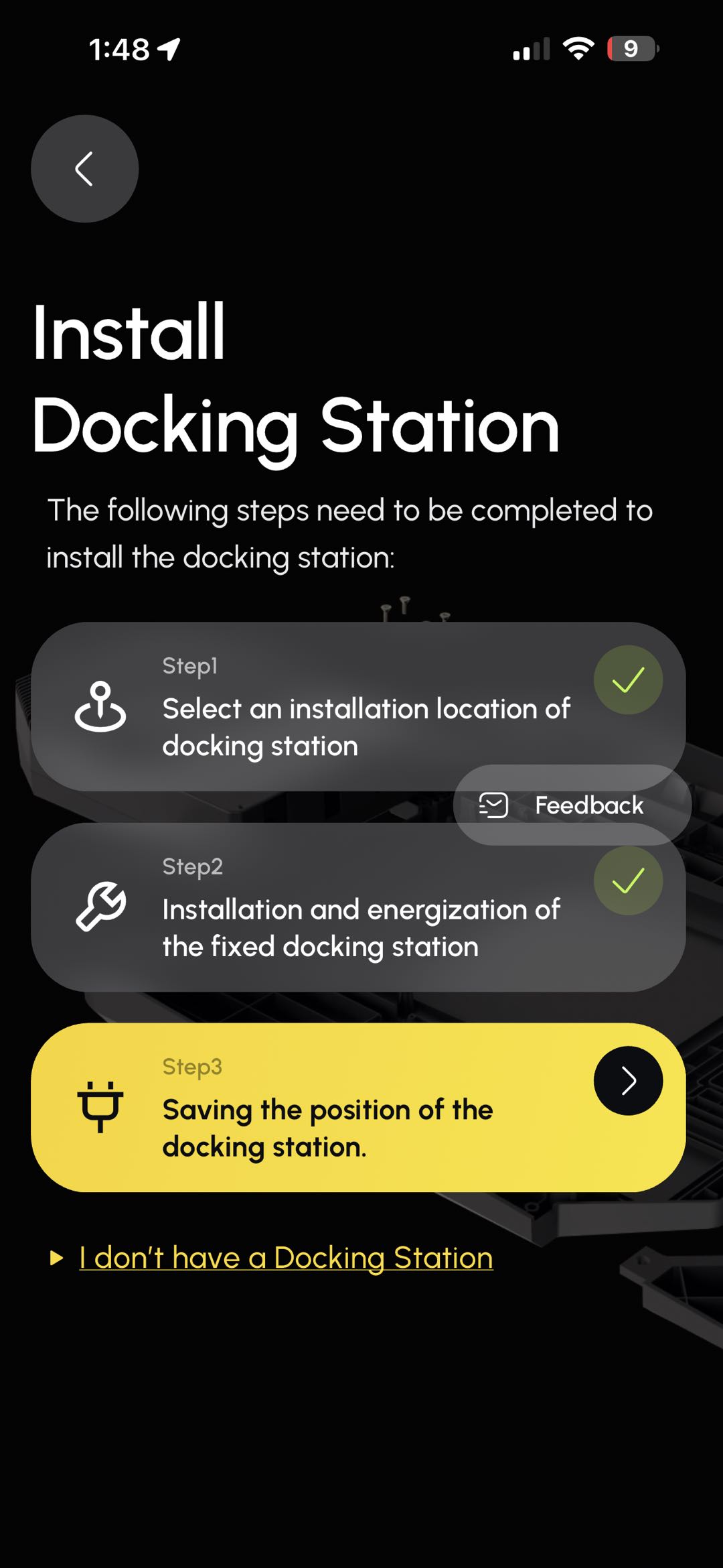

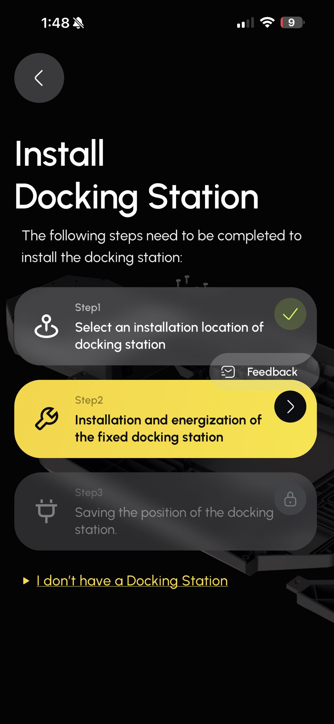

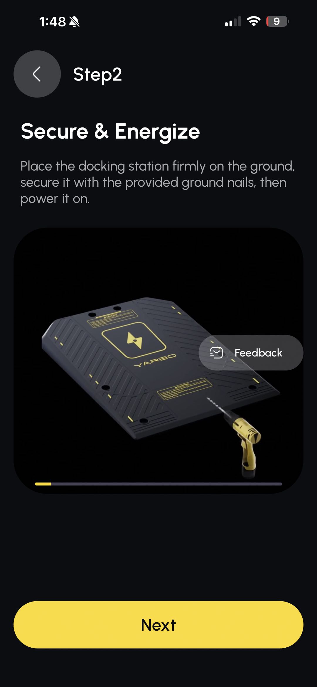

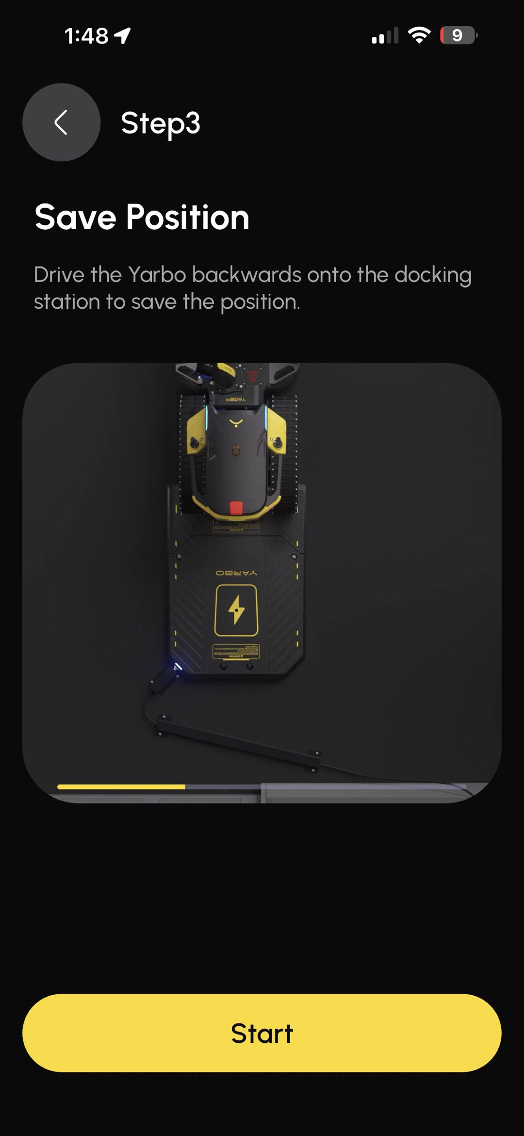

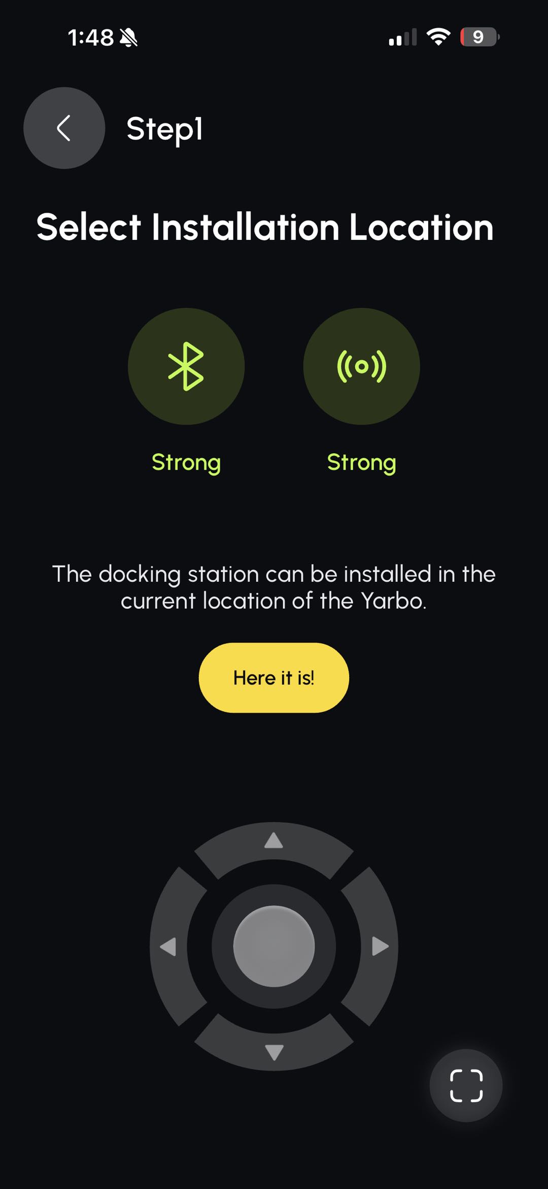

This guide provides step-by-step instructions for setting up your Docking station, along with key considerations to ensure Yarbo maintains a wonderful charging base for wireless charging. You’ll also learn how to seamlessly reinstall your Docking station to a new location if needed. Follow these guidelines to ensure Yarbo’s optimal performance, wherever you choose to deploy it.

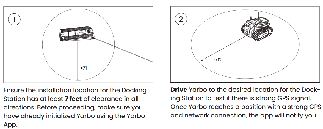

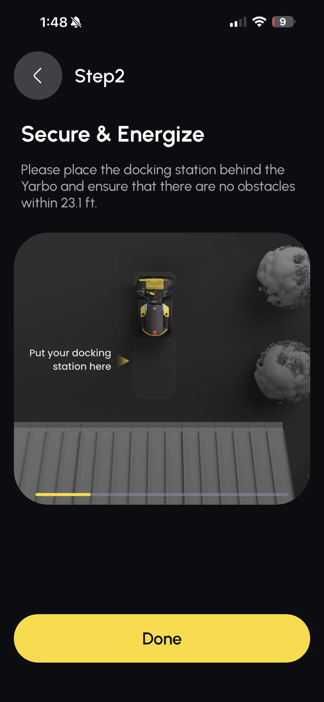

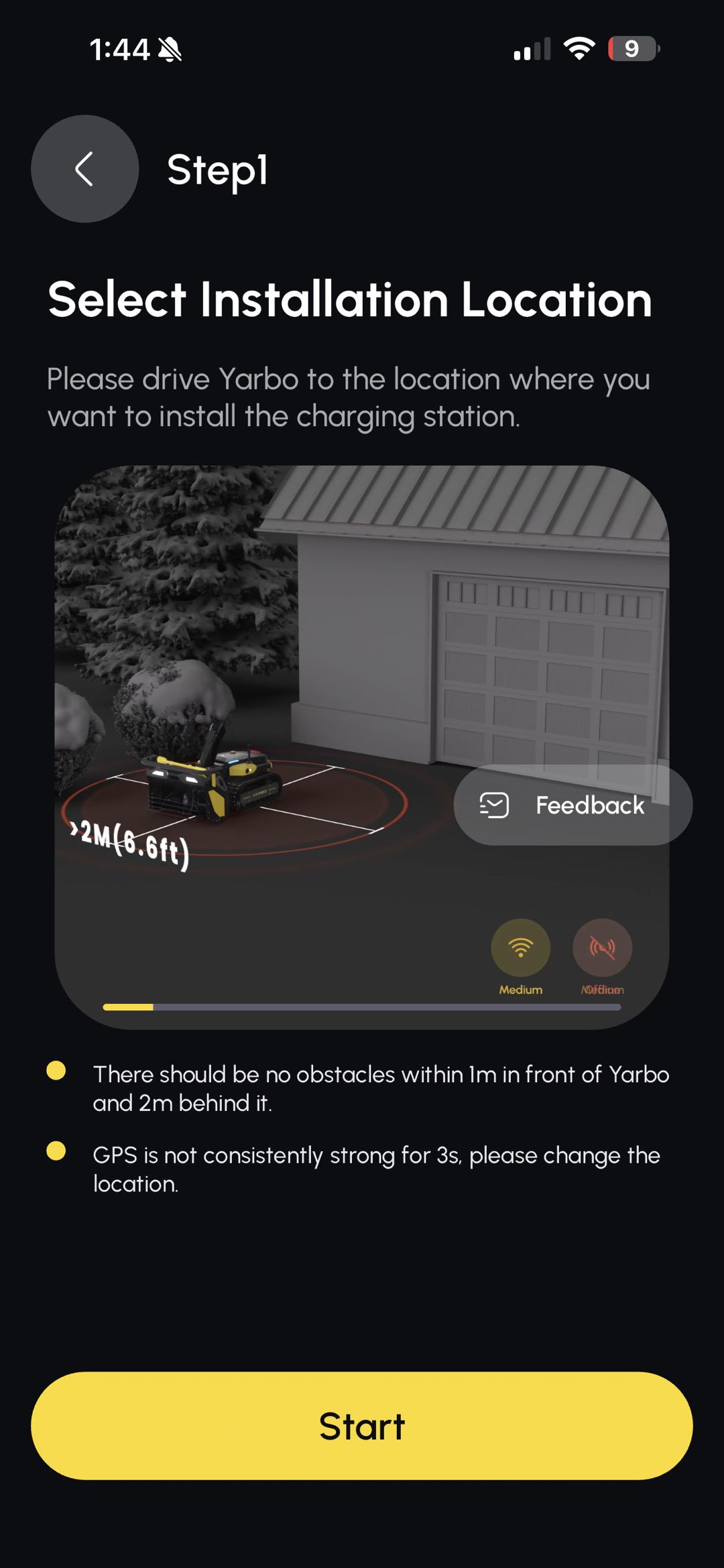

The key consideration when installing the Docking Station is to ensure it has at least 7 feet of clearance in all directions. This is essential for optimal wireless charging experience.

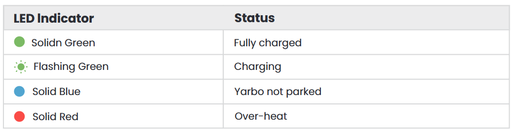

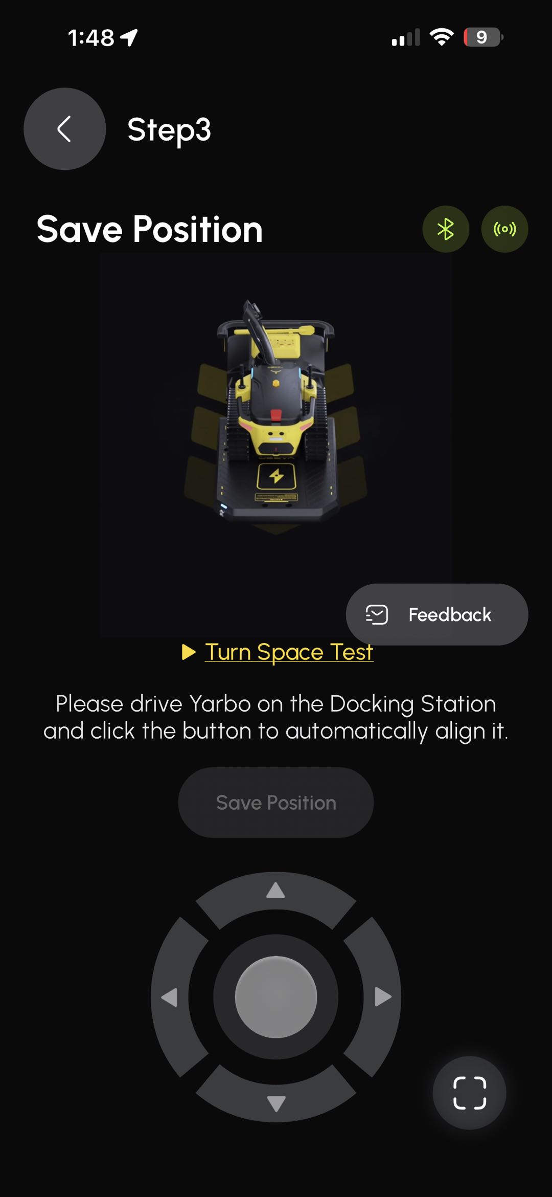

To ensure the best wireless charging experience, make sure that the light on the docking station should be solid blue to be ready to charge.you can also refer to the sheet below to confirm the status of Docking Station.
