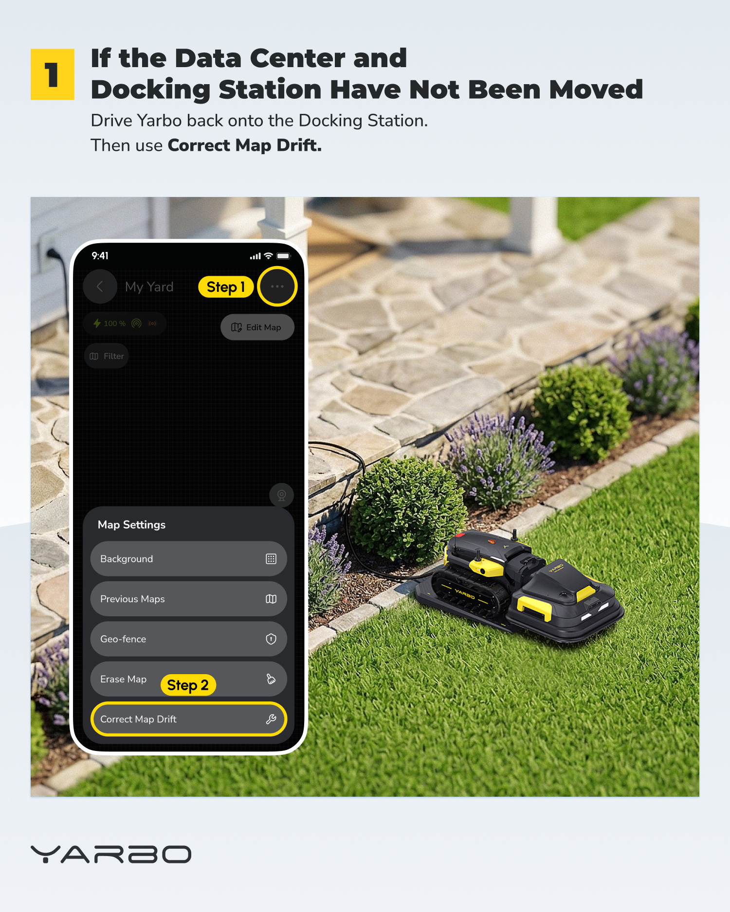

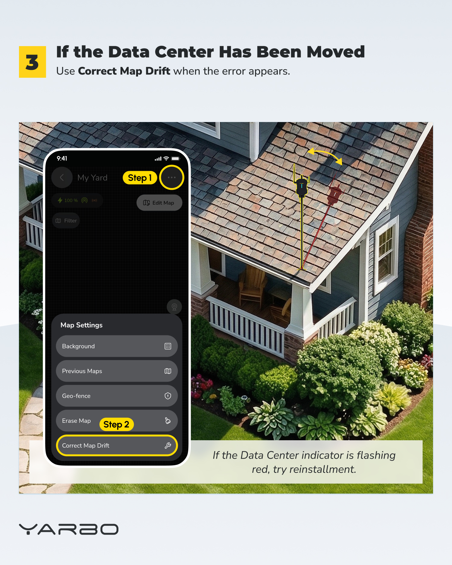

If Yarbo is charging under good GPS conditions, but the system detects that the charging position does not match the location recorded on the map, a Map Drift error may appear.
📍Path: My Yard → three-dot icon (top right) → Correct Map Drift
Important: Only use Correct Map Drift when a Map Drift error appears in the app.
