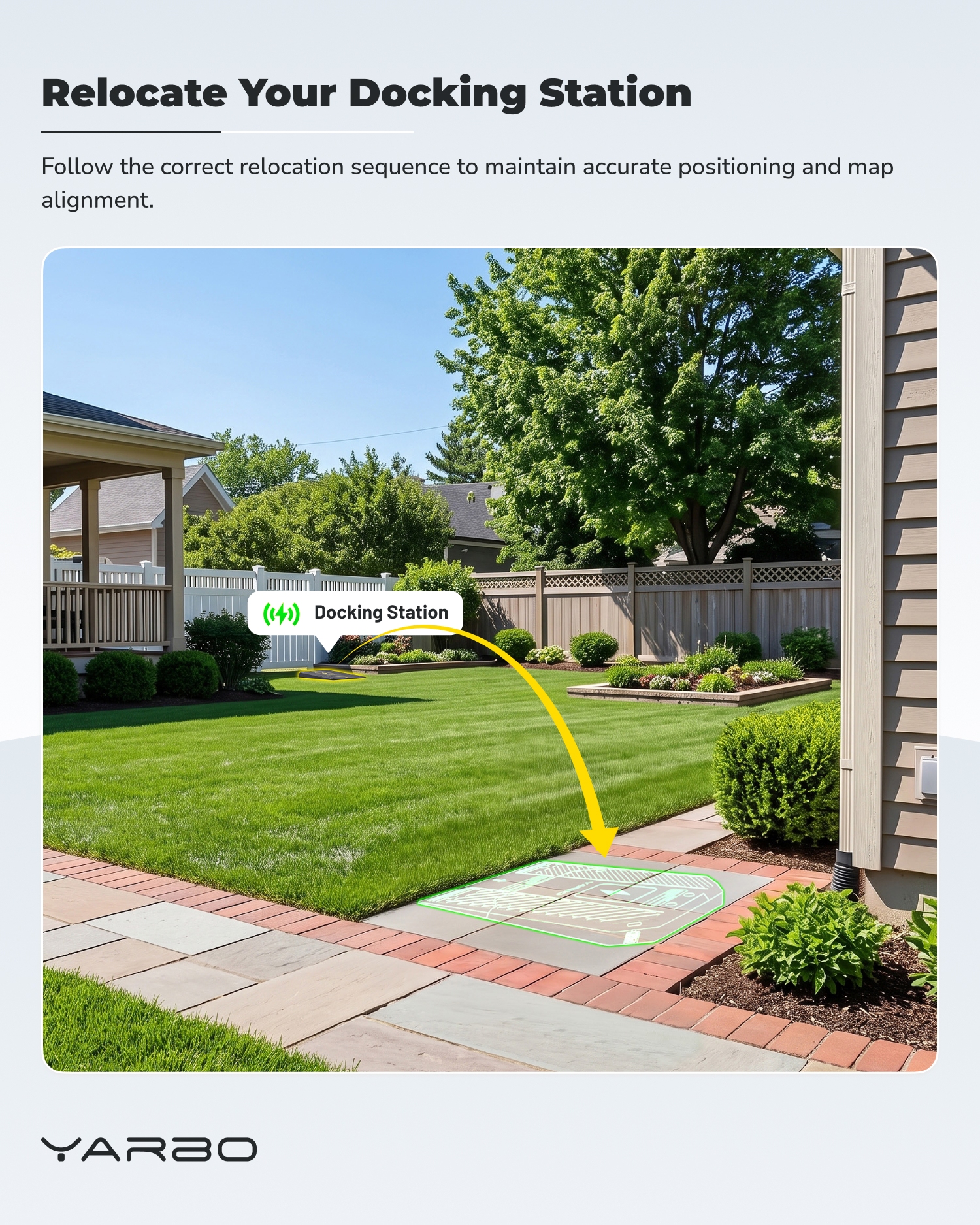

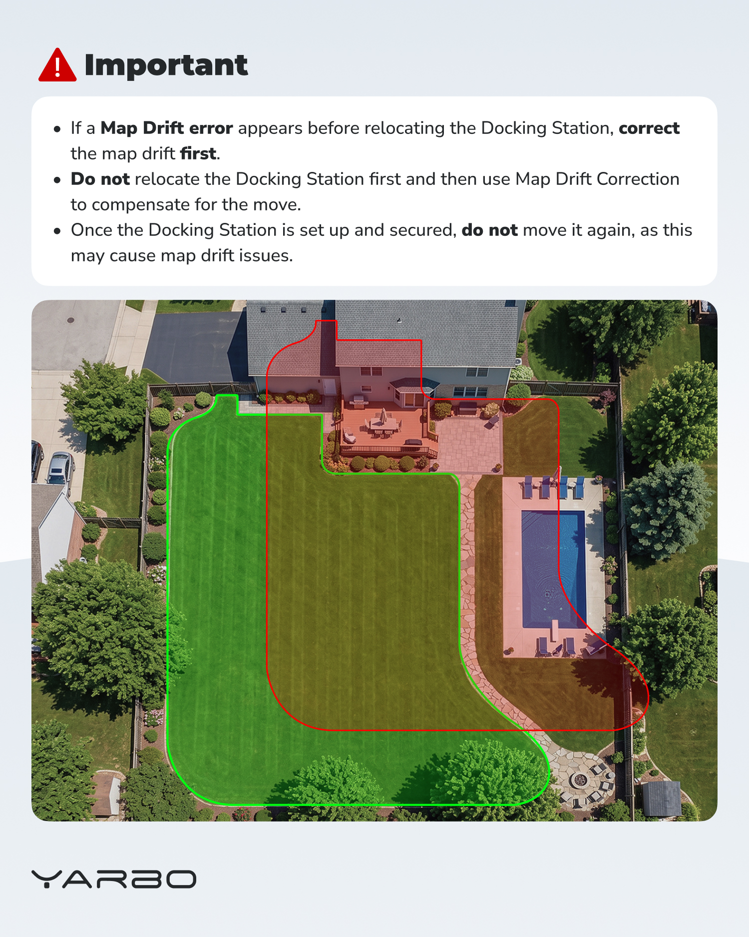

⚠️ If the App is showing a Map Drift error, correct the map drift before relocating the Docking Station. Do not relocate the Docking Station first and then use Map Drift Correction to compensate for the move.

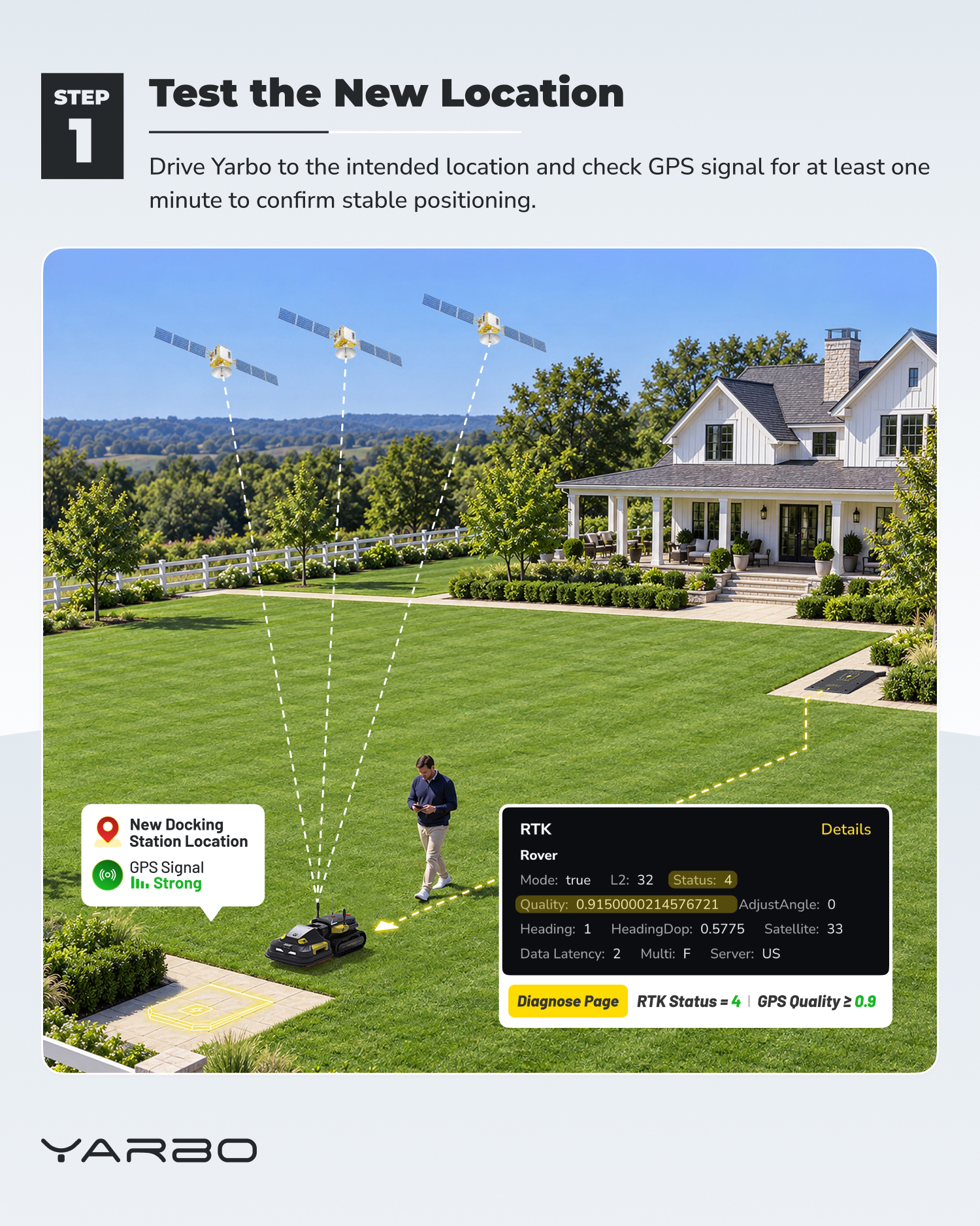

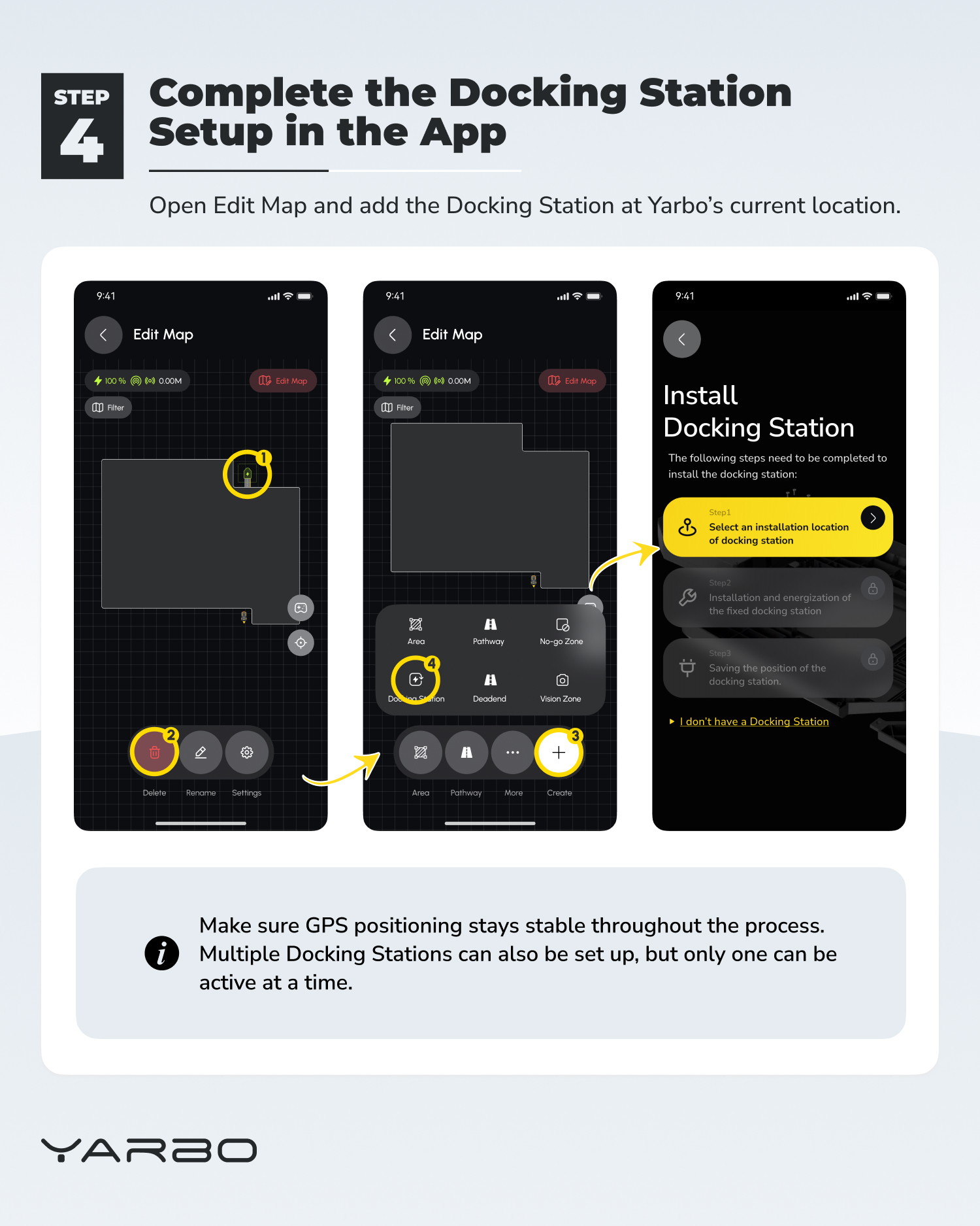

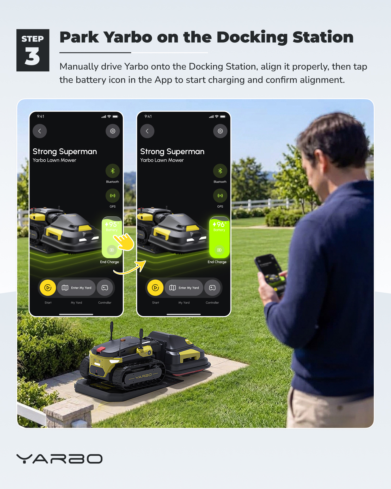

TEST FIRST. MOVE SECOND. SET UP LAST.
