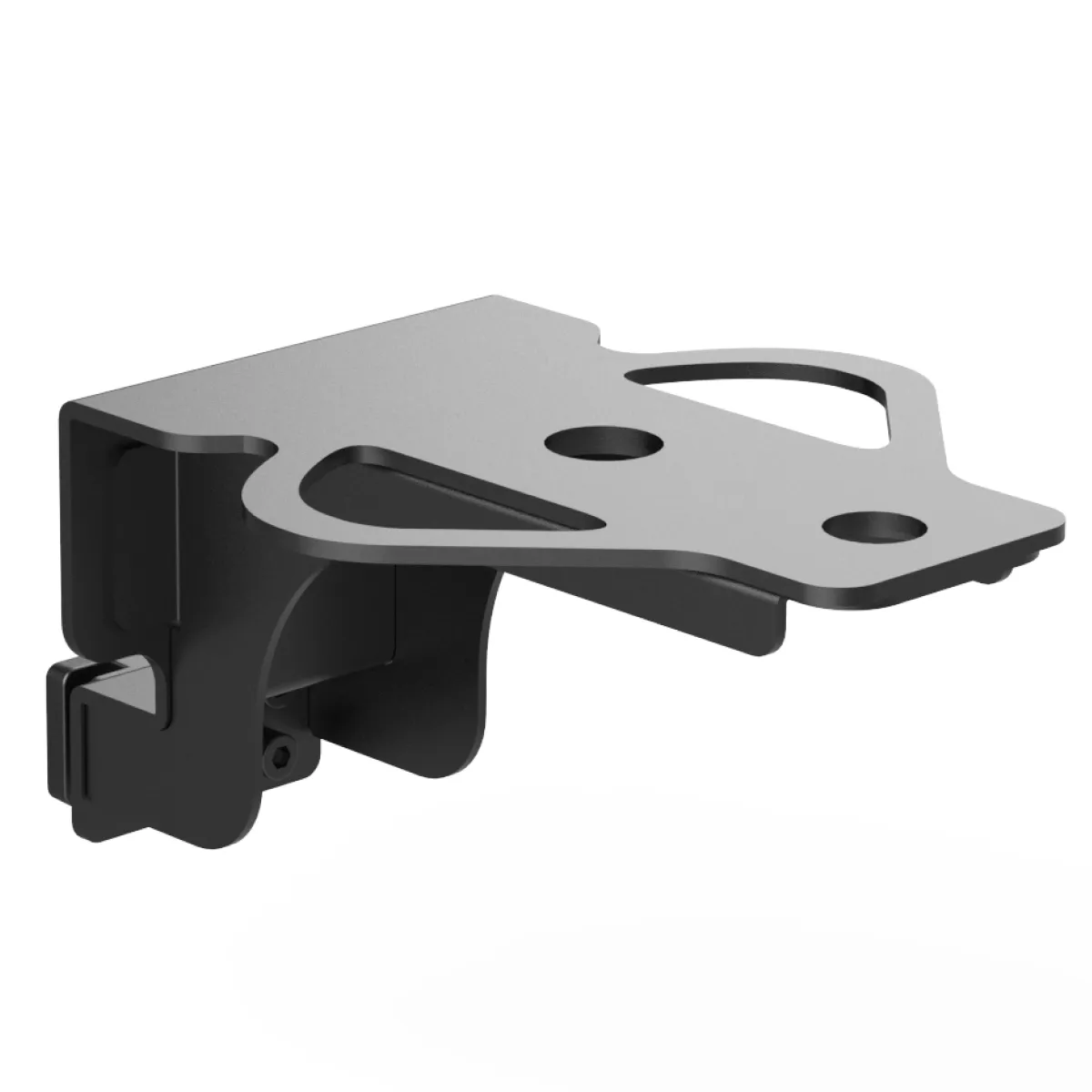

Yarbo now supports a wide range of towing tasks using two tow-hitch configurations:
Standard Tow Hitch (Core-mounted) — 2024 version

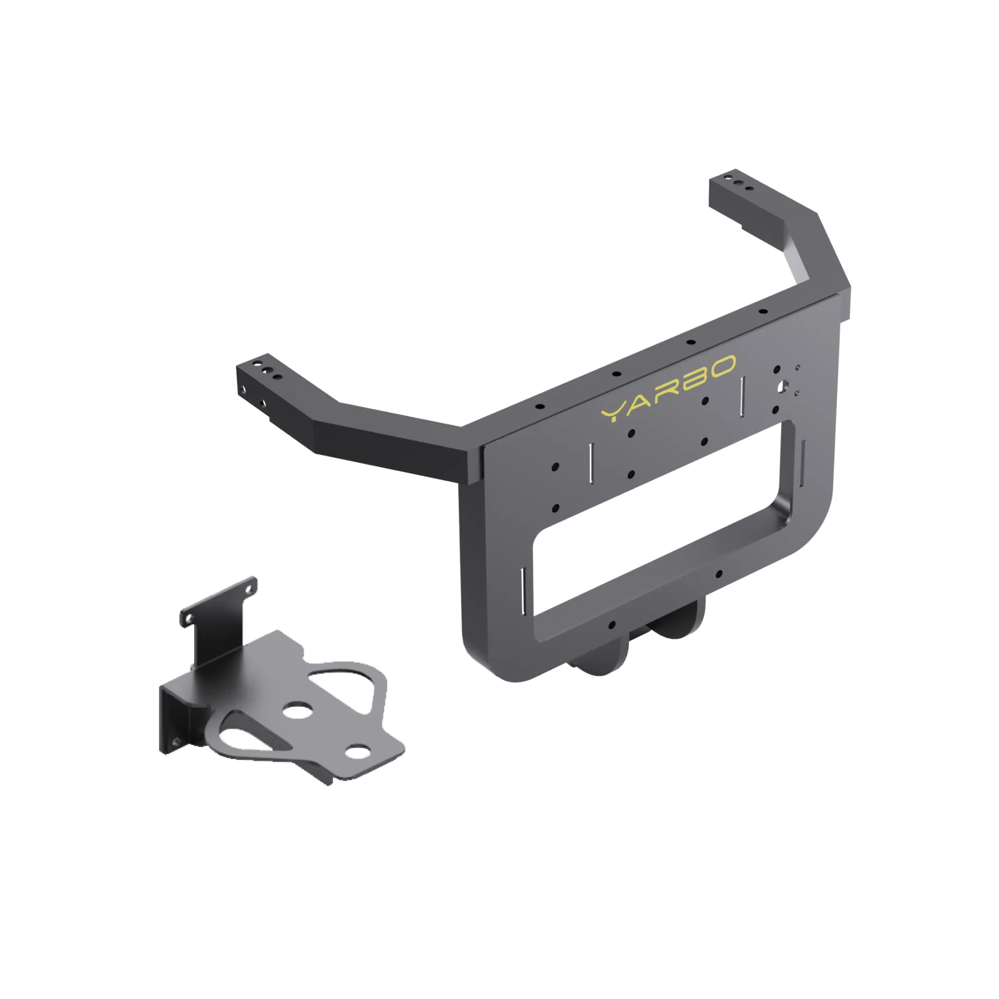

Tow Hitch + Back Brace Mount — 2024 upgraded configuration
Note: The two Tow Hitch versions are not interchangeable . The Standard Tow Hitch (Core-mounted) cannot be mounted on the Back Brace Mount, and the Tow Hitch designed for the BBM cannot be mounted directly on the Core.

The Back Brace Mount:
Reinforces the entire rear structure
Supports up to 300 lbs tongue weight
Greatly improves towing stability

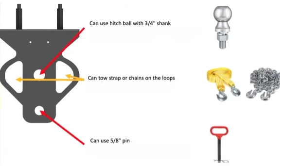

3/4" shank hitch balls
1-7/8" or 2" ball sizes
5/8" trailer pin
Tow straps / chains through side loops
