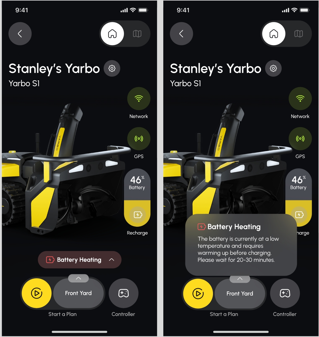

Battery heating is fully managed by the Battery Management System (BMS):
No manual action is required from the user.
The primary purpose of battery heating is to:
No.
During the heating process, current work plans are not interrupted
Once heating is complete, Yarbo automatically resumes normal operation, including charging and any subsequent scheduled tasks
No. Currently when battery is self-heating, manual control is not allowed.
However, in the future releases, user will be allowed to manually control Yarbo during the battery heating process.
Yarbo’s battery is equipped with a Battery Management System (BMS)
When the battery temperature is detected as too low, the BMS automatically initiates heating
Heating continues until the battery reaches a suitable operating temperature, after which it stops automatically
