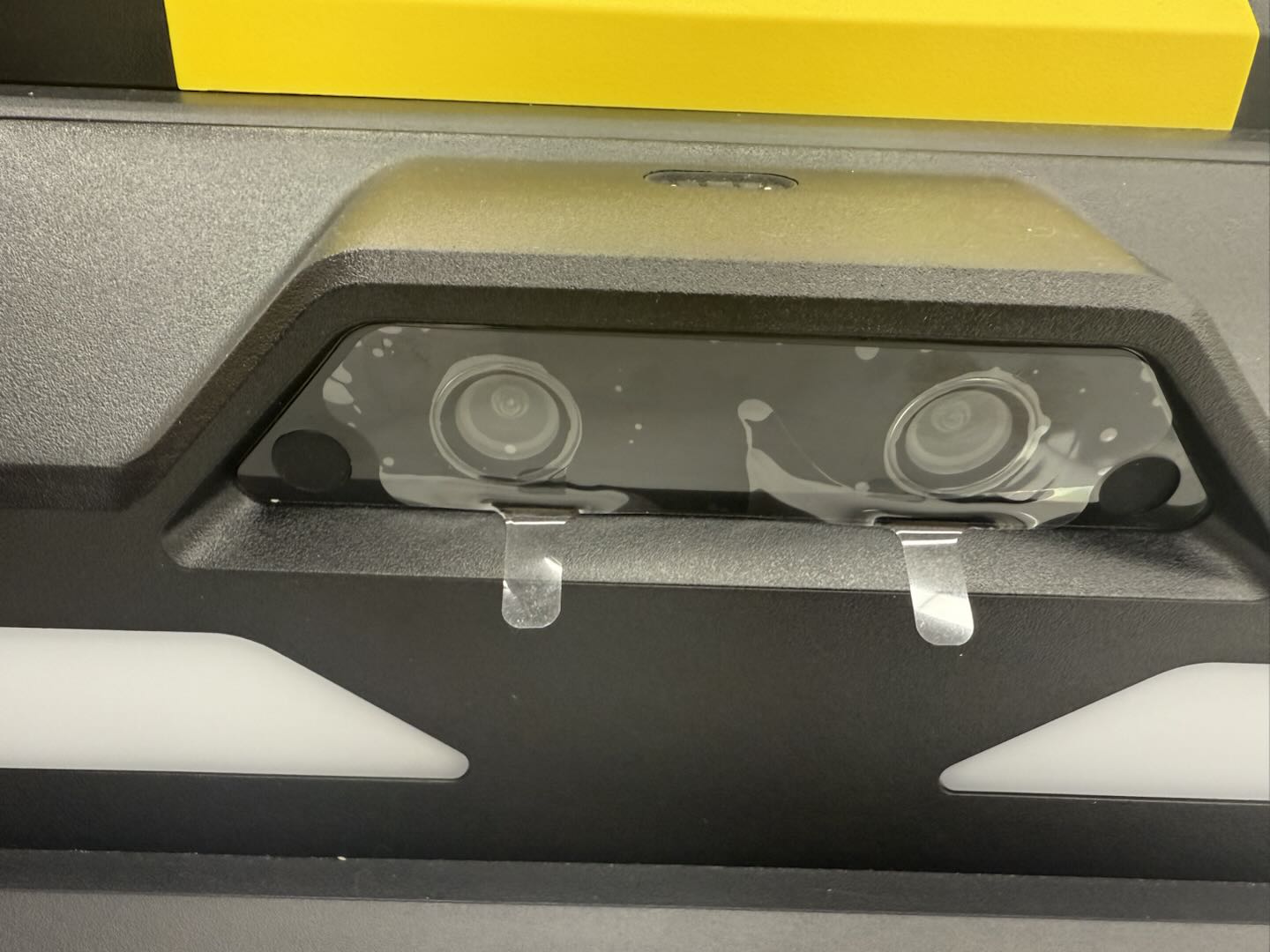

We’ve received multiple reports of obstacle avoidance not working properly on some units. After investigation, the root cause in many cases was the camera lens protective film not being removed during installation.
The transparent film blocks the vision of the obstacle avoidance cameras.
This can lead to false detection, failure to detect obstacles, or navigation errors.
It directly affects user experience and product performance.

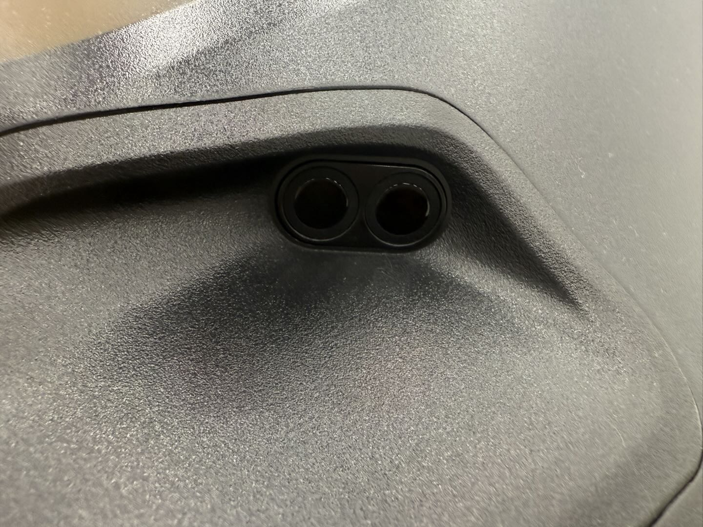

After removing the film, wipe the lens gently with a clean microfiber cloth if needed.
