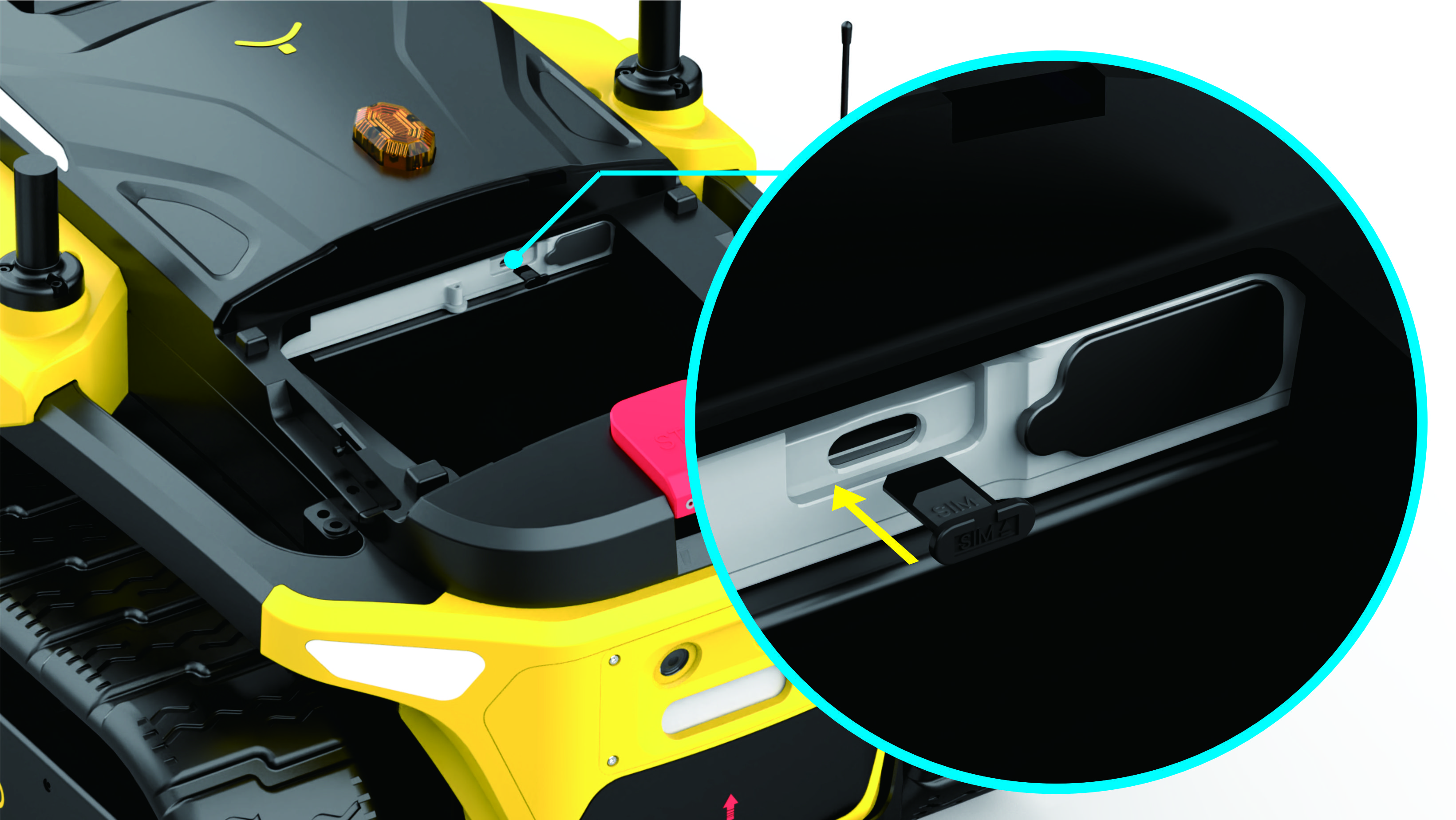

The SIM card is installed inside the rover, located within the battery storage compartment.
By default, Yarbo provides 2GB of free data per month. For most users, this is sufficient. However, if you rely heavily on 4G connectivity and prefer to use your own SIM card or data plan, you can replace the pre-installed SIM.
Note
Ensure your SIM card is activated and supports data-only plans.
If Yarbo fails to connect to 4G after inserting your SIM, check with your mobile provider to confirm compatibility.
