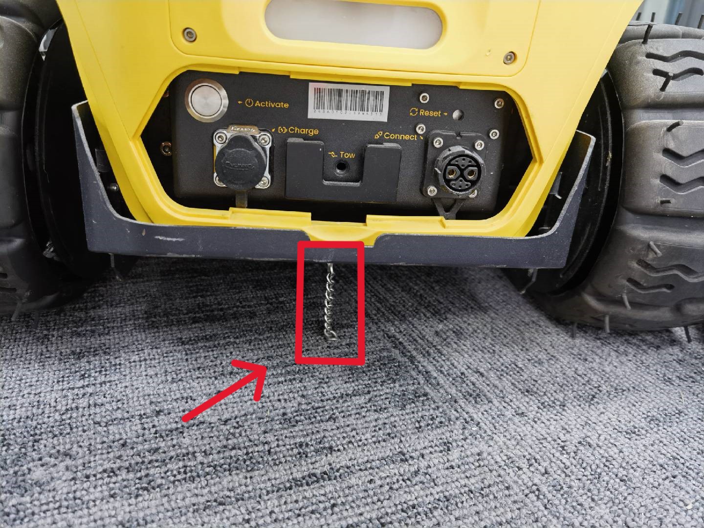

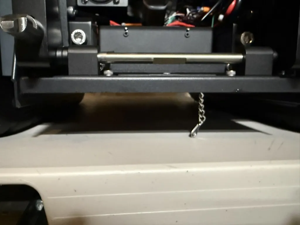

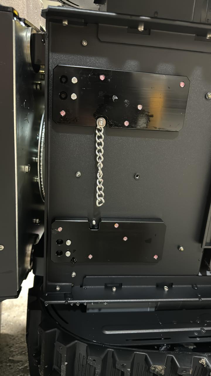

As you can see, there is a metal chain at the front or rear of Yarbo core which hangs naturally perpendicular to the ground. It is designed to discharge static electricity.
During operation—especially in dry or dusty environments—static buildup can occur. This chain stays in contact with the ground to safely release static electricity, helping to prevent potential interference or damage to the machine’s electronic components and ensuring greater stability and safety during use.
