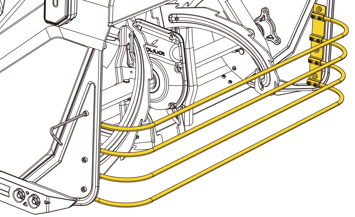

¶ The Snow Blower Protection Fence : Integral to Our Triple-Layer Safety System
The Snow Blower Protection Fence enhances our Triple-Layer Safety System, which includes side cameras, a front camera, millimeter-wave radars, and a bumper. It not only protects your feet from the spinning auger but also shields the auger from hard obstacles during automated operations, ensuring safe and efficient performance.

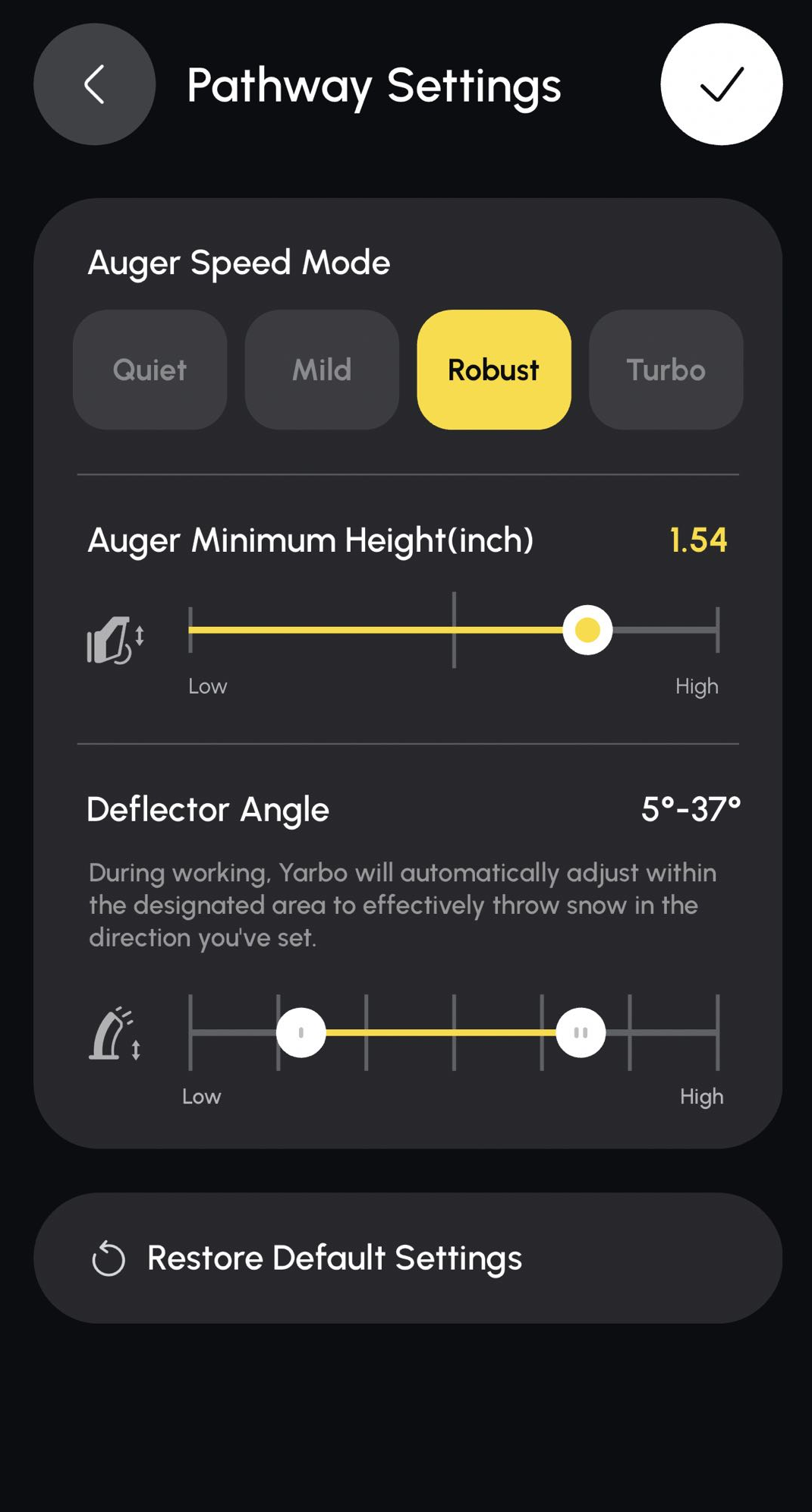

Default Auger Angle Setting: In default mode, the Snow Blower’s auger angle is set to the lowest position while following a pathway. If you need to adjust the auger angle separately, you can do so after drawing the pathway by entering the Work Plan edit mode. Navigate as follows:
Main page -> Work Plan -> Modify -> Pathway -> Setting Page.
Secure Installation of the Snow Blower Guard: Before operation, ensure that the protective guard on the Snow Blower module is securely installed. We highly recommend not removing the Auger Cage, as it is essential for safe operation.
