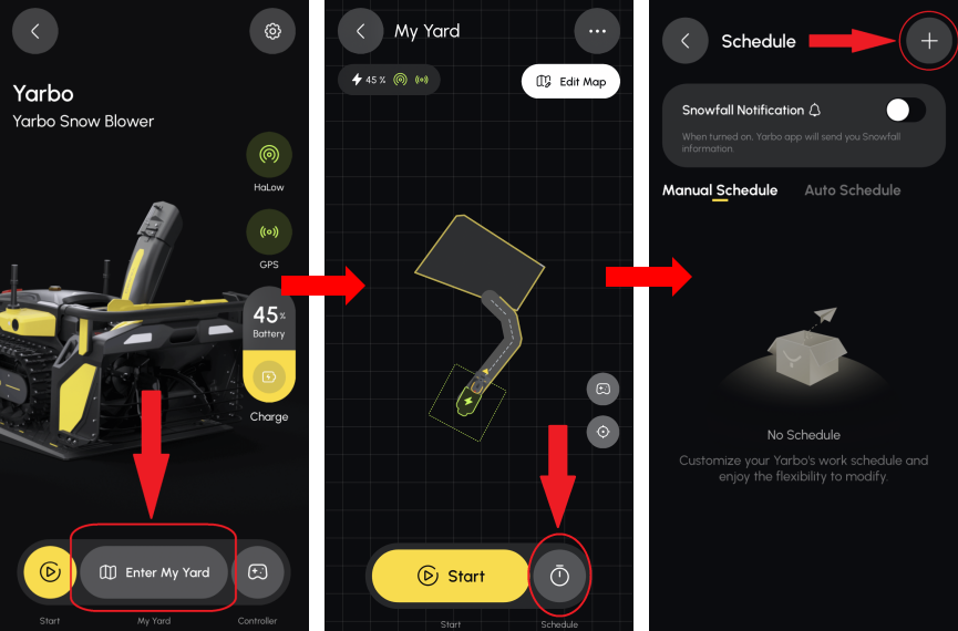

To access the schedule settings, start by selecting "Enter My Yard" on the map page. Once on the My Yard page, navigate to the menu below and click on "Schedule." This will take you to the schedule settings, where you can create a work schedule for automated task execution.

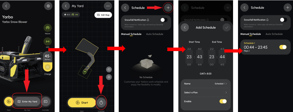

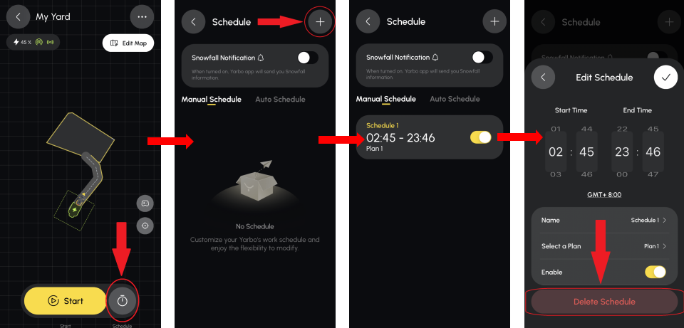

Step 1: To initiate the scheduling process, navigate to the Map page and click on "Schedule" Within the My yard, locate the "Schedule" feature.
Step 2: On the Schedule page, click the "+" button in the top-right corner of the page to begin creating a schedule for a designated plan.
Step 3: Set the "Start Time," "End Time," and Your local time zone for the work schedule. This allows Yarbo to execute the plan accordingly.
Step 4:Next, select a plan from the plan list.
Step 5: Once satisfied with the schedule settings, save the plan to enable the Yarbo to automatically execute the work plan according to the defined schedule.
