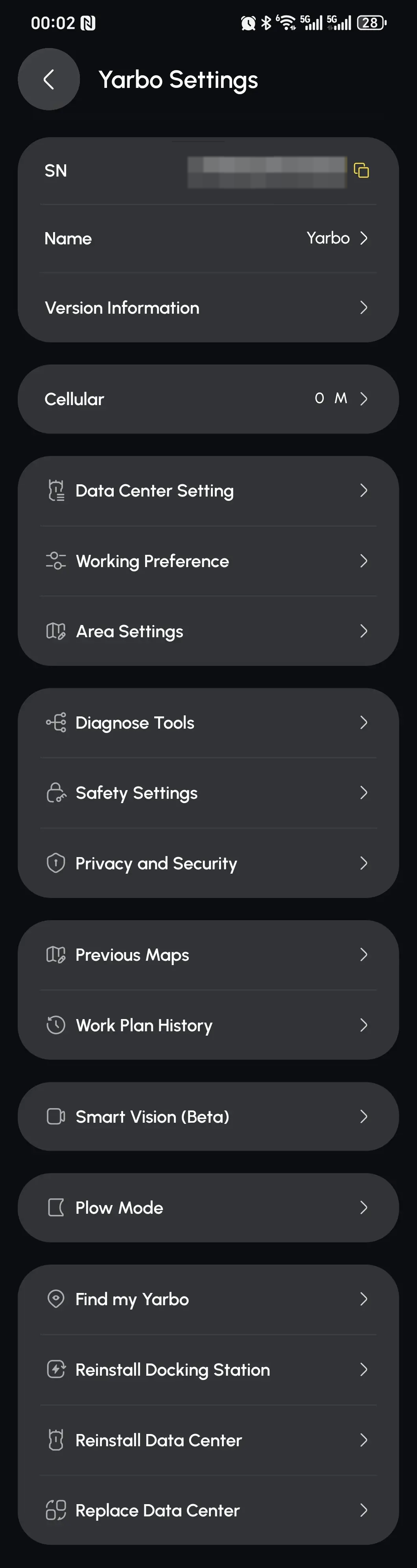

The Serial Number (SN) is a unique identifier for your Yarbo.
Tip : When contacting support, please share this SN to help our support team assist you effectively.
The Name of your Yarbo can be customized by clicking on it.
Personalize your Yarbo by giving it a name that fits its role in your yard.
Shows the current version of your Yarbo app and the version of your yarbo's firmware.
Click on it to check if you are using the latest app version . Keeping the app updated ensures you get all the latest features and improvements.
Tip : You can download the latest version from the Play Store or Apple App Store .
The Cellular option lets Yarbo use 4G connectivity . This is useful when Wi-Fi isn’t available for Yarbo’s operations.
The Yarbo app will connect to your data centre via Bluetooth so that you can check various information about your dc.
Set Yarbo's Moving Speed and other work plan settings here.
Customize how Yarbo operates during its work plans by selecting options like speed and other preferences.
Area Settings allow you to adjust various work areas:
Area settings, Pathway settings, and Sidewalk settings can be configured to suit your landscape.
Use Diagnose Tools to check the current status of Yarbo, including odometry calibration, Wi-Fi diagnostics, and more.
You can also shut down or restart Yarbo and upload Yarbo logs here, which can be helpful when troubleshooting.
Safety Settings include:
Controller Child Lock : Helps prevent unintended use.
Pedestrian Detection : Enhances Yarbo’s safety during operation.
Warranty Management and Battery Info are also available for your reference.
¶ 10. Pivacy and Security
Geo-fence: The geo-fence that can be drawn around the home, you will receive a notification if Yarbo exits the Geo-fence.
Warranty Management: You can check the warranty dates of your Yarbo Core and your modules here.
Battery Info: Here you can check the basic information about the battery (battery type, voltage, capacitance, operation temperature) with notices and warnings.
Save current maps or restore previous maps in this section.
This feature is useful for reusing old mapped areas and for backup purposes.
Check Yarbo’s work plan history to review previous work sessions and see what’s been completed.
View Yarbo’s webcam feed through SmartVision .
Note : If Yarbo is using 4G , to prevent you from incurring additional data usage, you will not be able to use smart vision to view the camera images.
Use this setting to switch to Plow Mode if you have the plow module attached to Yarbo.
This allows Yarbo to plow snow effectively during winter.
Find My Yarbo helps you locate Yarbo, the RTK base station , and even your own location .
This feature ensures you can always track Yarbo’s whereabouts and the base station for convenience.
If you need to change the location of your Docking Station , use this setting to reinstall it.
Important : Reinstalling the docking station will delete any connected pathways.
Reinstall Data Center can reset the map reference point for your yarbo, which will effectively avoid map drift problems.
Use this feature when installing a new Data Center or after your Data Center has been moved.
Replace Data Center can also be used to re-pair the Data Center with Yarbo.
Caution : Re-pairing the Data Center will erase all map data —use this option carefully.
