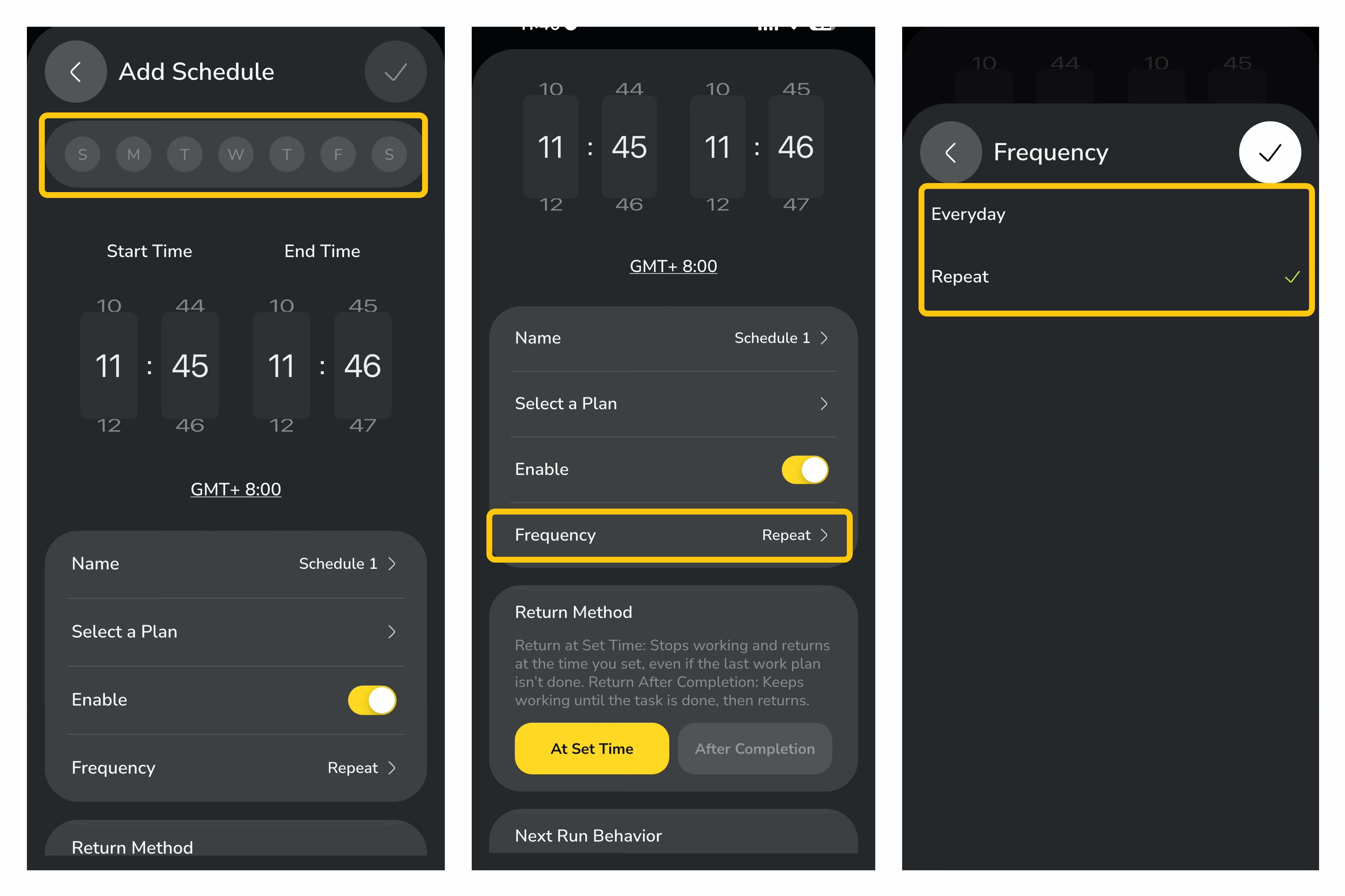

Step 1: On the Schedule page, click the "Add" icon to begin creating a schedule.
Step 2: Set the "Start Time" and "End Time“ for the scheduled cleaning. This establishes the time frame during which the Yarbo will autonomously execute its cleaning plan.
Step 3: Next, select a plan from the plan list. Once you have selected a plan, you can turn on the "Enable" option based on your preference, ensuring that the schedule automatically repeat every day within the sepcified time period.
Step 4: Once satisfied with the schedule settings, save the plan to enable the Yarbo to automatically execute the work plan according to the defined schedule.
When setting up your schedule Frequency, you have two options:

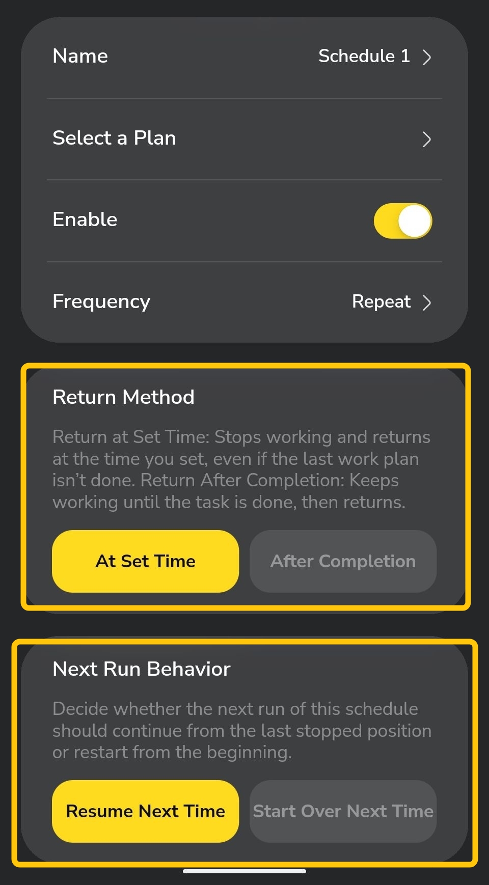

Yarbo allows you to continue unfinished tasks in your next scheduled run. This is achieved through the Return Method and Next Run Behavior settings.
