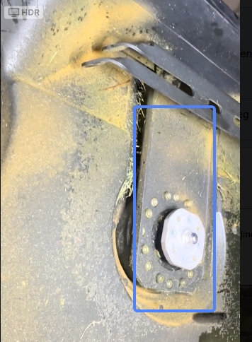

Inspect for grass buildup or debris around the cutting discs. Clean thoroughly.
If you haven’t removed the blade guard yet, consider removing it to reduce grass accumulation and improve maintenance access. Refer to this Blade Guard Removal video tutorial.

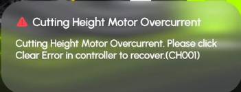

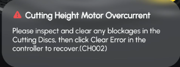

Open the Yarbo App controller and tap the Clear Error button.
If the issue persists or CH002 error pops up, proceed to CH002 troubleshooting.
