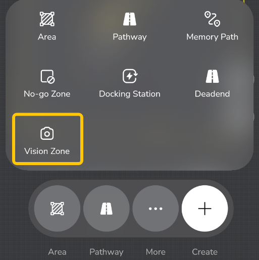

| Go to Edit Map → Create → Vision Zone. |

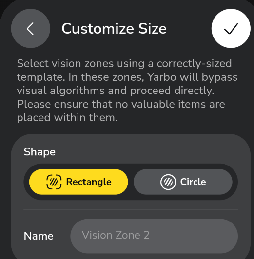

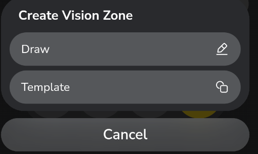

Choose one of the following methods:

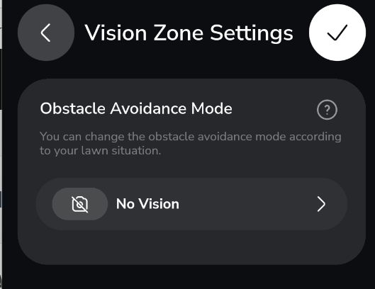

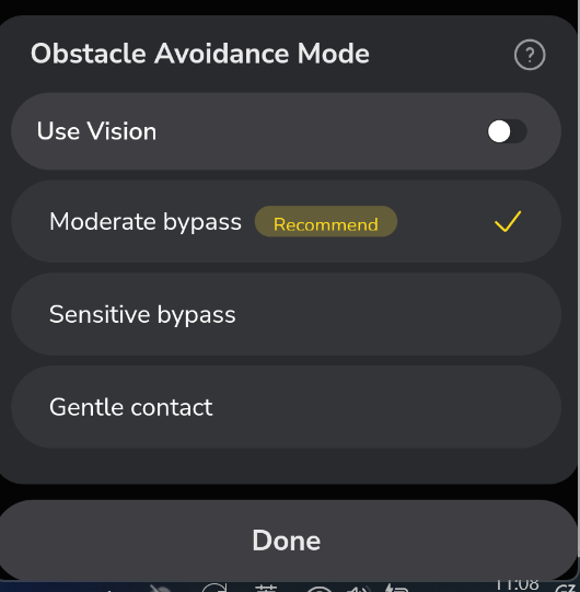

Once drawn, tap Next to configure the obstacle avoidance mode for that Vision Zone.

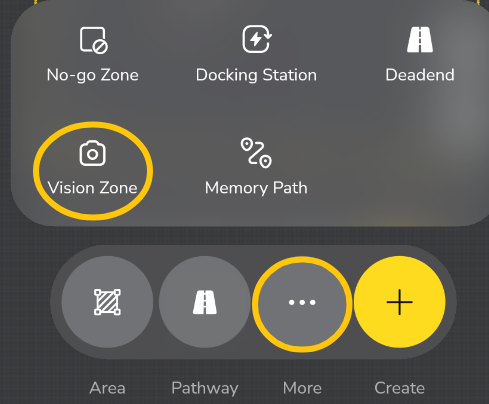

| From the map editing interface, tap More → Vision Zone. |

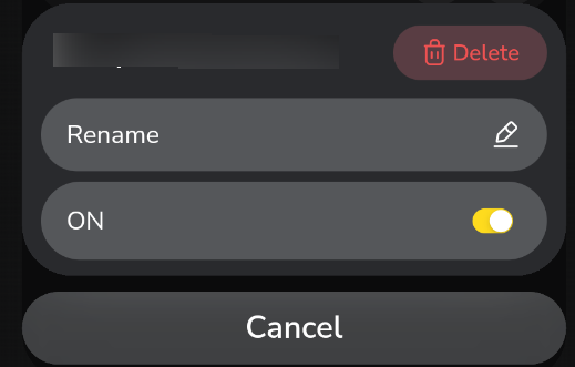

Here you can:
Note: All previous No-Vision Zones will be automatically converted into Vision Zones with the “Use Vision” setting disabled.
| Mode | Behavior |
| With Vision Enabled | Yarbo uses its cameras to detect obstacles early and slows down as it approaches them. When close enough, it makes gentle contact using the bumper and then navigates around smoothly. |
| With Vision Disabled | Yarbo ignores visual input in this zone and relies only on bumper sensors to detect obstacles. It will physically touch objects before deciding how to navigate around them. |
