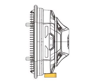

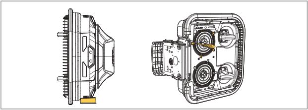

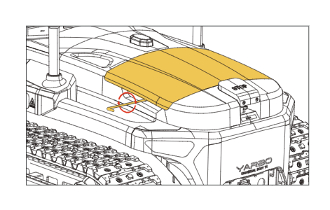

Before Cleaning: Detach the lawn mower from the universal body. Raise the mower from the side and place it on the Module Vertical Stand (refer to the picture below).
Areas to Avoid Spraying: Do not spray water directly onto the connection port where the cable is plugged into the mower, or the two expansion ports on either side.

Raise the lawn mower from the side and place the lawn mower on Module Vertical Stand, please refer to the picture shown below.

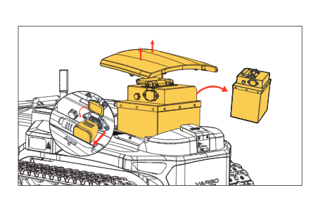

Ensure that Yarbo is switched OFF and disconnects the battery when performing the above maintenance tasks.
