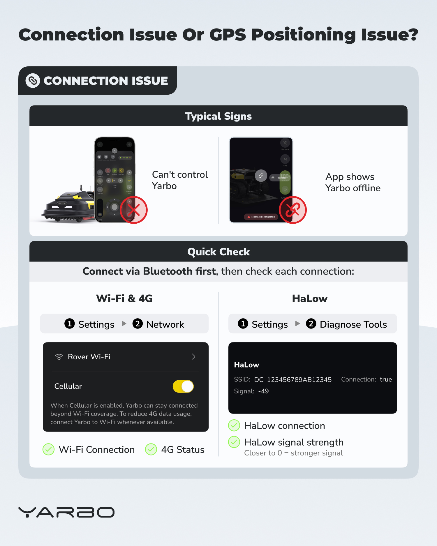

🛰️ How to tell a GPS issue from a connection issue
🔄 How GPS and communication work together
💡 Tip: Good GPS alone isn’t enough. The Core and Data Center also need a stable connection so positioning correction data can be transmitted properly.
