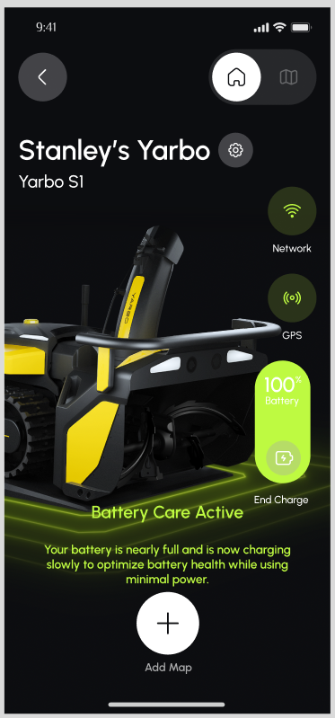

Yarbo’s Battery Management System includes over‑charge protection, so it’s safe to leave the unit plugged in and charging on its docking station between jobs.When the actual battery level exceeds 90% but the app displays 100%, your Yarbo is in trickle charging mode.
