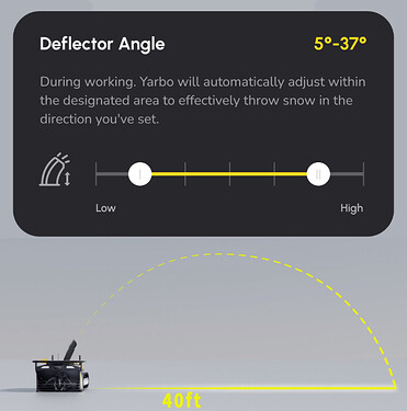

The Deflector Angle controls how far Yarbo throws snow through the discharge chute.
During operation, Yarbo automatically adjusts within your selected angle range to achieve the most effective snow-throwing trajectory.
The adjustable range is -5° to 50°.
| Scenario | Recommended Angle | Description |
| Small or Restricted Areas (e.g., near walls or narrow driveways) | -5° to 5° | Keeps snow close and minimizes scattering into unwanted areas. |
| Long Throwing Distance (e.g., open driveways, large yards) | 40° to 50° | Maximizes distance to efficiently blow snow farther away from the cleared path. |
| Dynamic Auto Adjustment | -5° to 50° | Allows Yarbo to automatically adjust the deflector angle based on its position and proximity to boundaries, providing the best throwing distance for each section. |
For wet or heavy snow, avoid setting the deflector angle too low.
➤ Low angles (close to -5°) increase the risk of chute clogging, especially with dense snow.
➤ Instead, raise the deflector angle to improve discharge flow and prevent blockages.
Experiment with different angles depending on snow depth, density, and space constraints for the best overall results.
