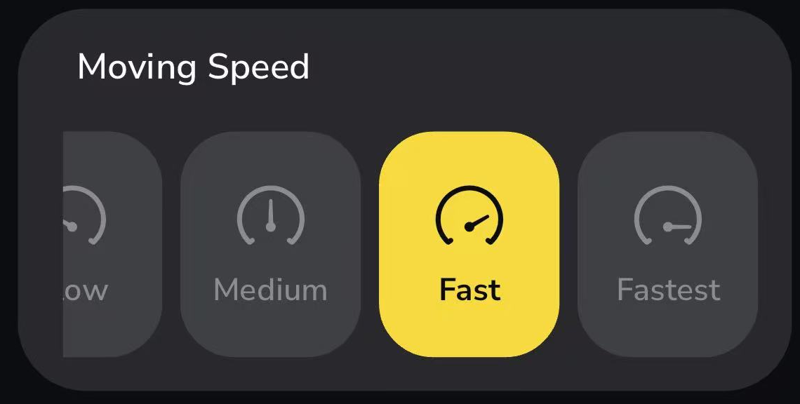

The Moving Speed setting controls Yarbo’s travel speed during snow clearing.
Faster speeds help reduce total working time, while slower speeds allow for more precise and thorough snow removal—especially useful for wet or compacted snow.

The patrol (return) speed follows your general Moving Speed setting in the Work Preferences page. Adjusting Moving Speed will automatically change patrol speed as well.
