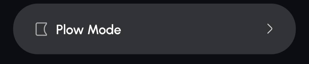

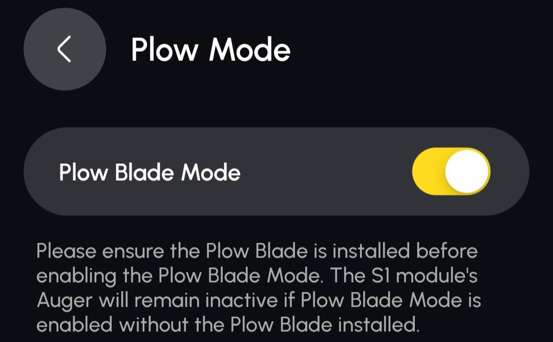

After the plow blade has been installed, find the Plow Mode button in Yarbo Settings, click the Plow Mode button to enter the Plow Mode settings, and turn on Plow Blade Mode in the Plow Mode settings.

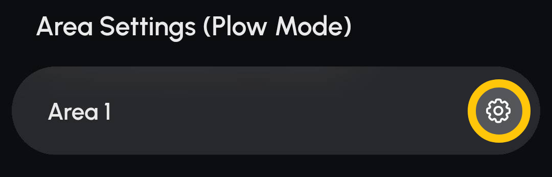

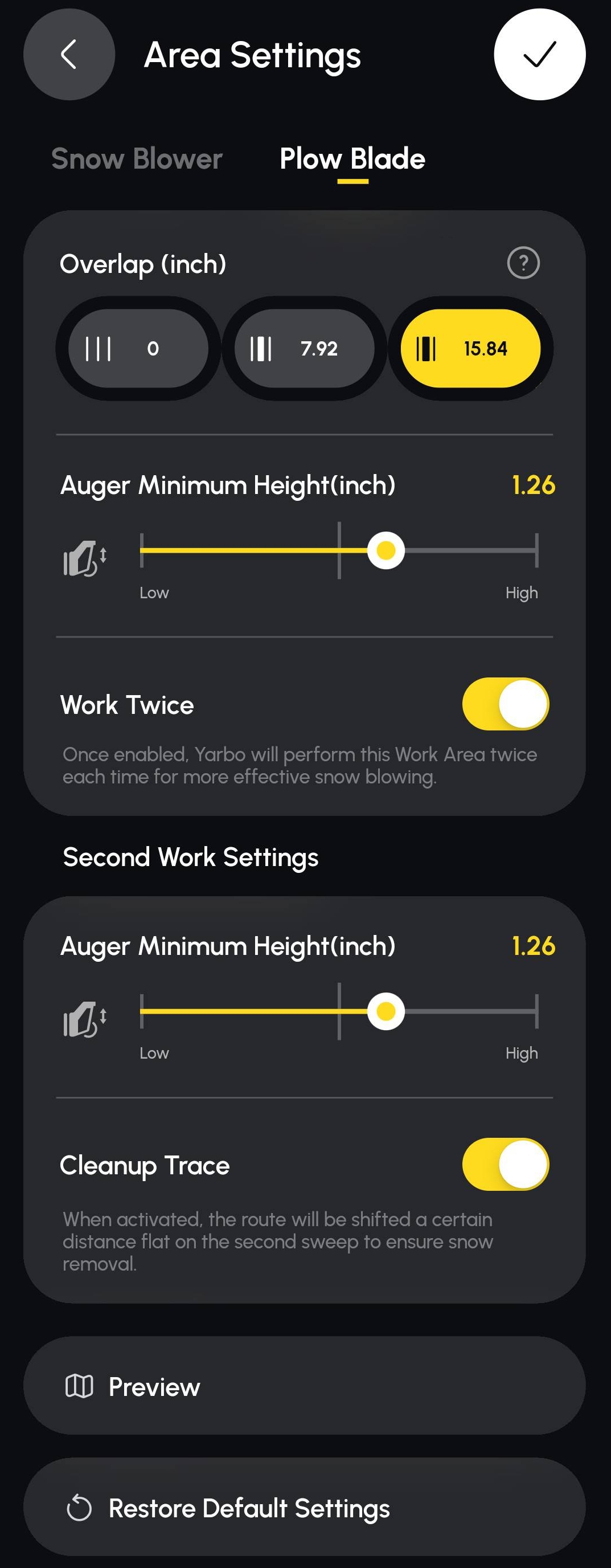

Click the Settings button to enter Area Settings, You can make the corresponding settings here, the settings are the same as the snow blower Area settings(Please draw additional maps to use Plow Mode.
