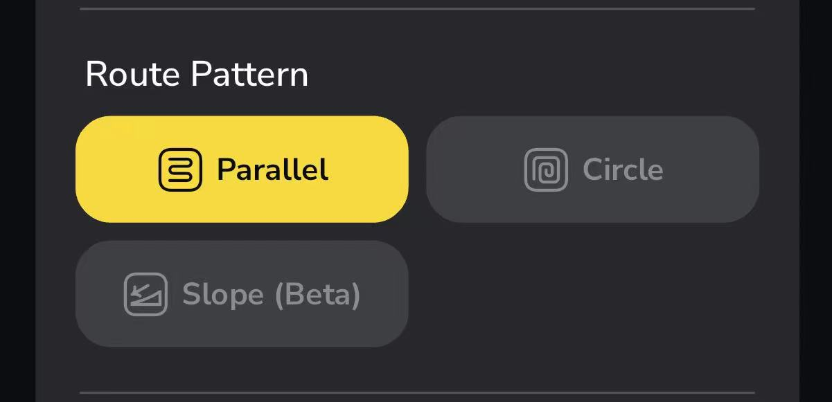

The Route Pattern determines how Yarbo moves across the working area.
Each pattern is designed for different surface conditions — from flat driveways to steep inclines — helping you achieve better coverage, traction, and efficiency.
A simple and efficient pattern where Yarbo moves back and forth in parallel lines across the working area.
This pattern is ideal for flat and open spaces, ensuring clean, uniform snow clearing.
An automated spiral route generated by Yarbo’s algorithm.
Depending on the area’s layout, the route may start from the outer edge and move toward the center — or from the center outward — for smooth, continuous coverage.
Yarbo’s Slope Pattern is an intelligent routing algorithm specifically designed to handle inclined driveways and ramps safely and efficiently.
This mode prioritizes downhill clearing to prevent slippage, reduce strain, and improve traction.
How It Works:
Best For: Sloped driveways, ramps, or areas with significant elevation changes.
Advantages:
| Pattern | Ideal Terrain | Coverage Style | Key Advantages | Recommended Use |
| Parallel | Flat, open areas | Straight lines | Efficient, predictable | Standard driveways |
| Spiral | Irregular or wide areas | Inward or outward spiral | Smooth flow, fewer turns | Large open zones |
| Slope | Sloped or uneven driveways | High-to-low passes | Prevents slippage, saves energy | Inclined driveways or ramps |
