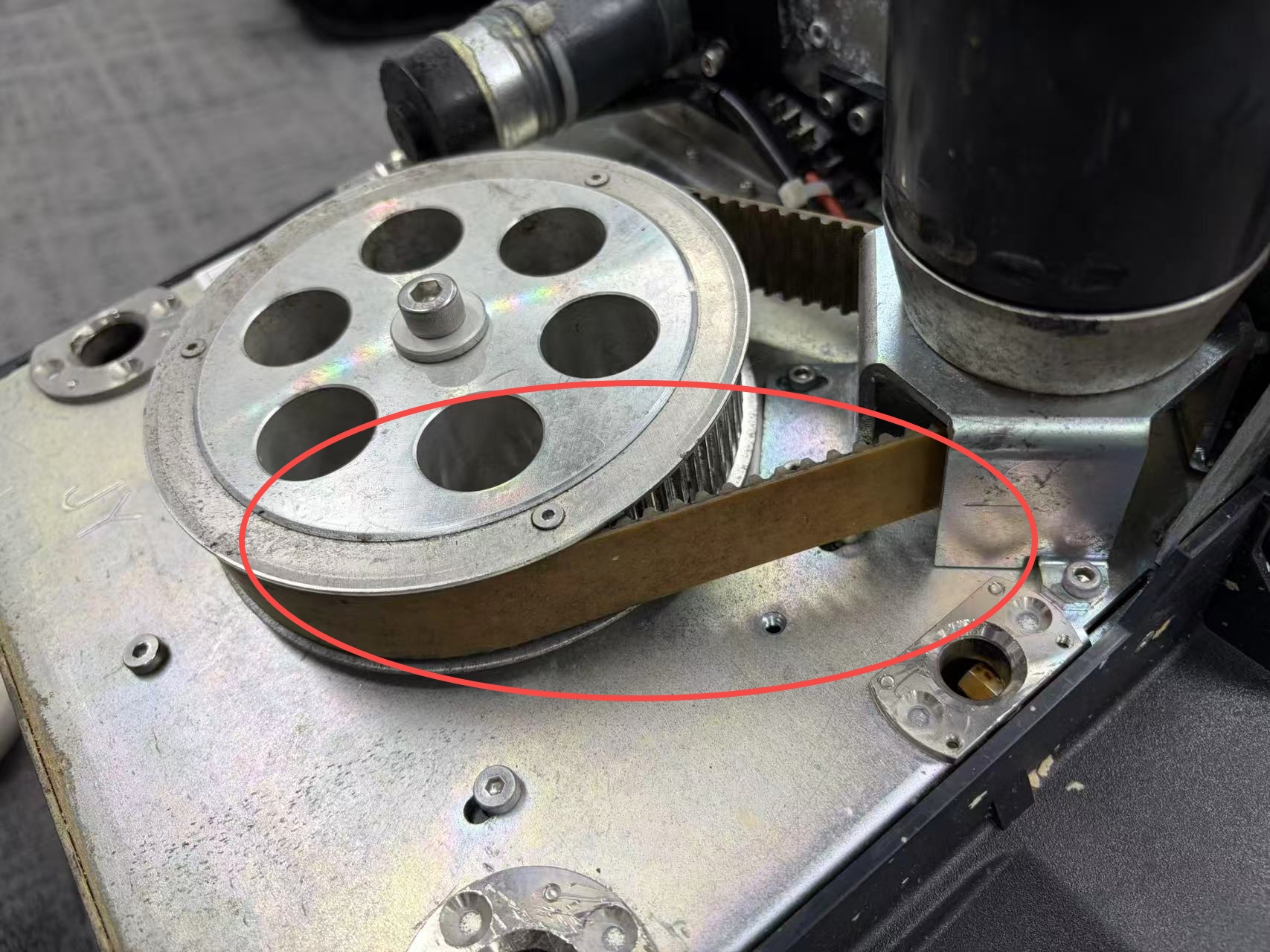

At this time, the belt used in the Yarbo Snow Blower Module is not classified as a consumable part, and it is not listed for sale in the official store. Please reach out to support if you have encoutered issue with snow blower belt.
The Snow Blower Module uses the following timing belt:
Model: S5M-25-515
This information is provided for identification and reference purposes only.
| Item | Specification |
| Belt type | Synchronous (timing) belt |
| Pitch type | S5M |
| Pitch | 5 mm |
| Belt width | 25 mm |
| Pitch length | 515 mm |
| Number of teeth | 103 |
| Code Section | Meaning |
| S5M | Synchronous belt with 5 mm pitch |
| 25 | Belt width in millimeters |
| 515 | Total pitch length in millimeters |
The belt specification is shared to help users identify the correct component when discussing service or support cases.
Interchangeability, and sourcing are not covered in this article.
