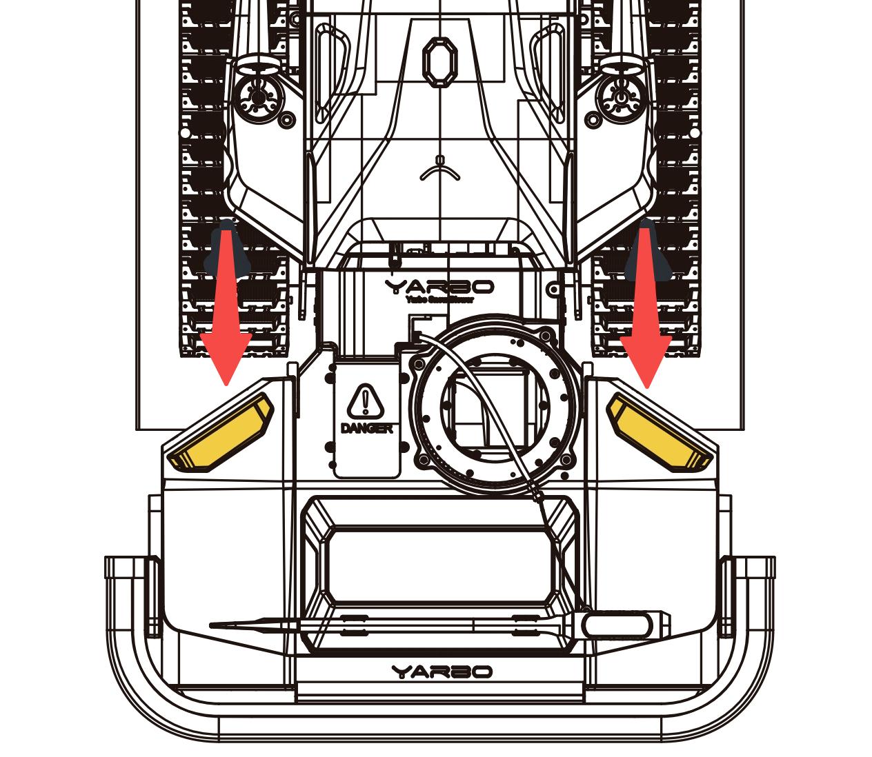

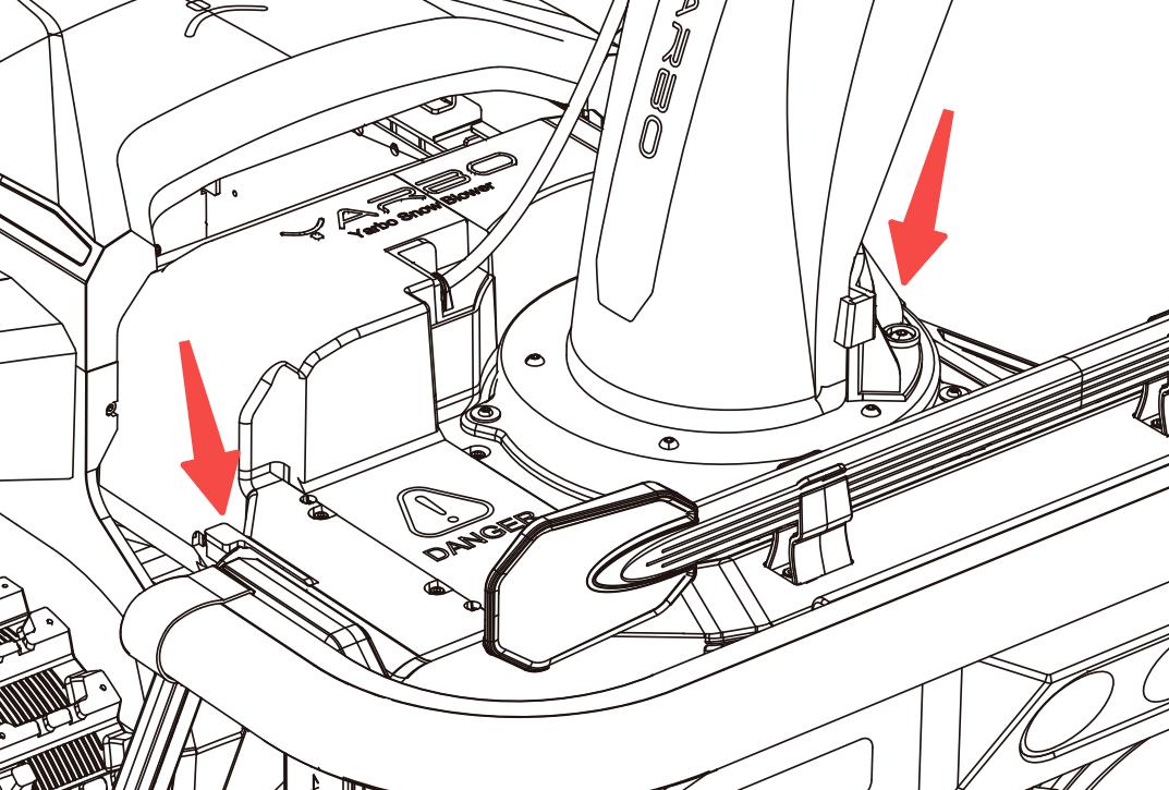

First, locate the two latches connecting the Snow Blower Module to the Yarbo Core body (as shown in the image). Lift these latches to disengage the lock, putting the module in a removable state.
These latches need to be lifted to release the locking mechanism, enabling the module to be detached safely.

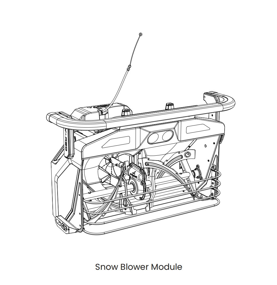

Firmly grip both handles on the sides of the Snow Blower Module. Gently lift and detach the module from the main body of the Yarbo Core, ensuring the protective cover with the Yarbo logo becomes fully visible.
Ensuring that the protective cover with the Yarbo logo becomes visible once detached.

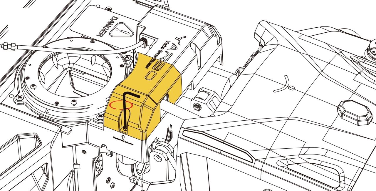

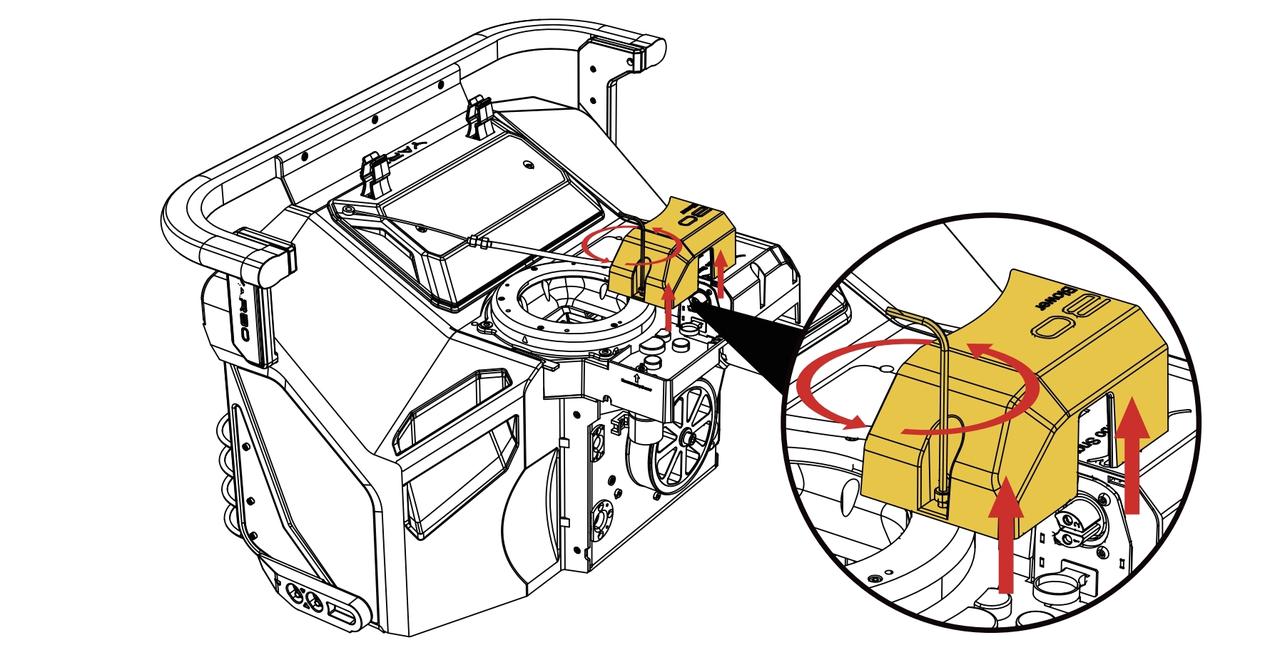

Use Allen Key #2 to unscrew and remove the protective cover that shields the power cable connection, as shown in the diagram. Ensure screw is loosened and the cover is completely detached before proceeding.
Unscrew and remove the protective cover

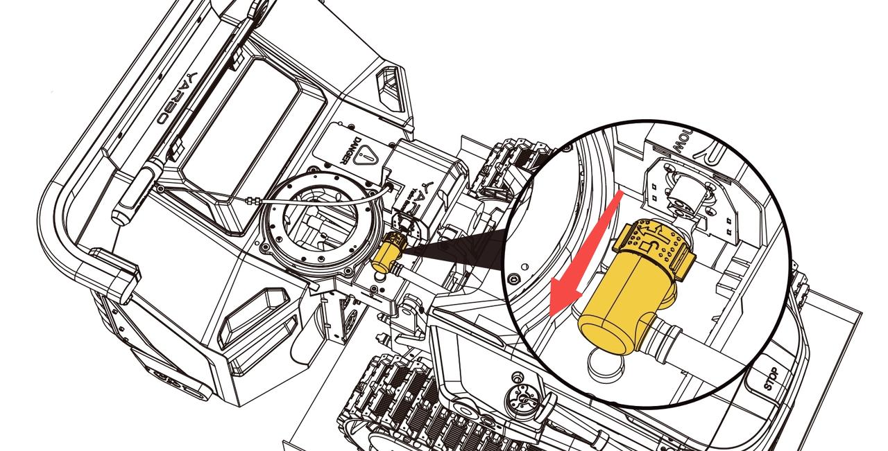

To disconnect the power cable, first grip the circular ring at the connection point (the part highlighted in the image). Gently twist the ring to unlock the cable from its secured position. Once unlocked, carefully pull the cable out.
Twist the locking ring, ensuring no excessive force is applied to avoid damage.
