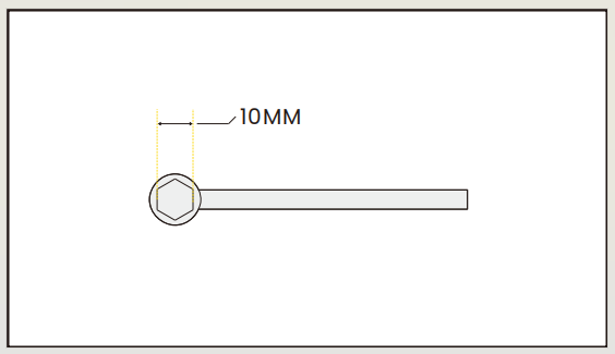

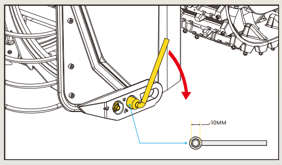

Using a 10mm hex socket screwdriver to remove the four bolts on the left and right sides of the snow blower head’s skid shoes.

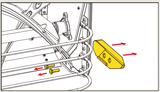

After removing the bolts, you can take the Skid Shoes off the snow blower module. Please handle with care and avoid forcing the removal to prevent damage to other components.
