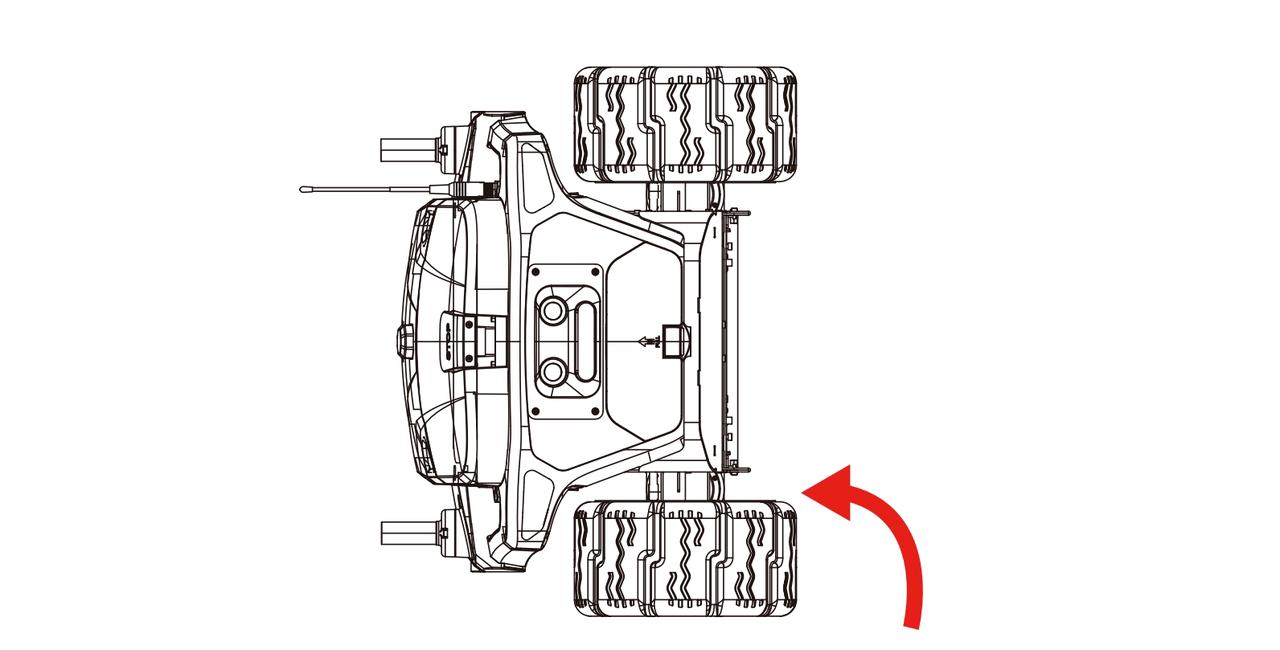

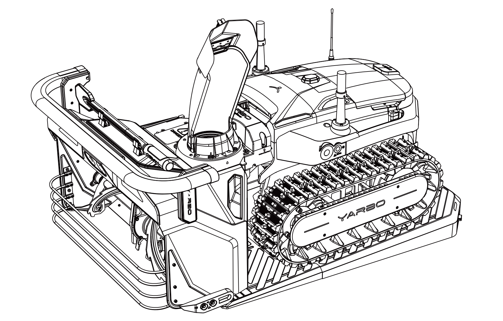

Begin by removing the Snow Blower Module or any other attachments connected to the Yarbo Core, as per the disassembly instructions provided in the module-specific guide. Once all modules are removed, flip the Yarbo Core so that the side with the track faces upward and is perpendicular to the ground. This position will make it easier to access and work on the track assembly.

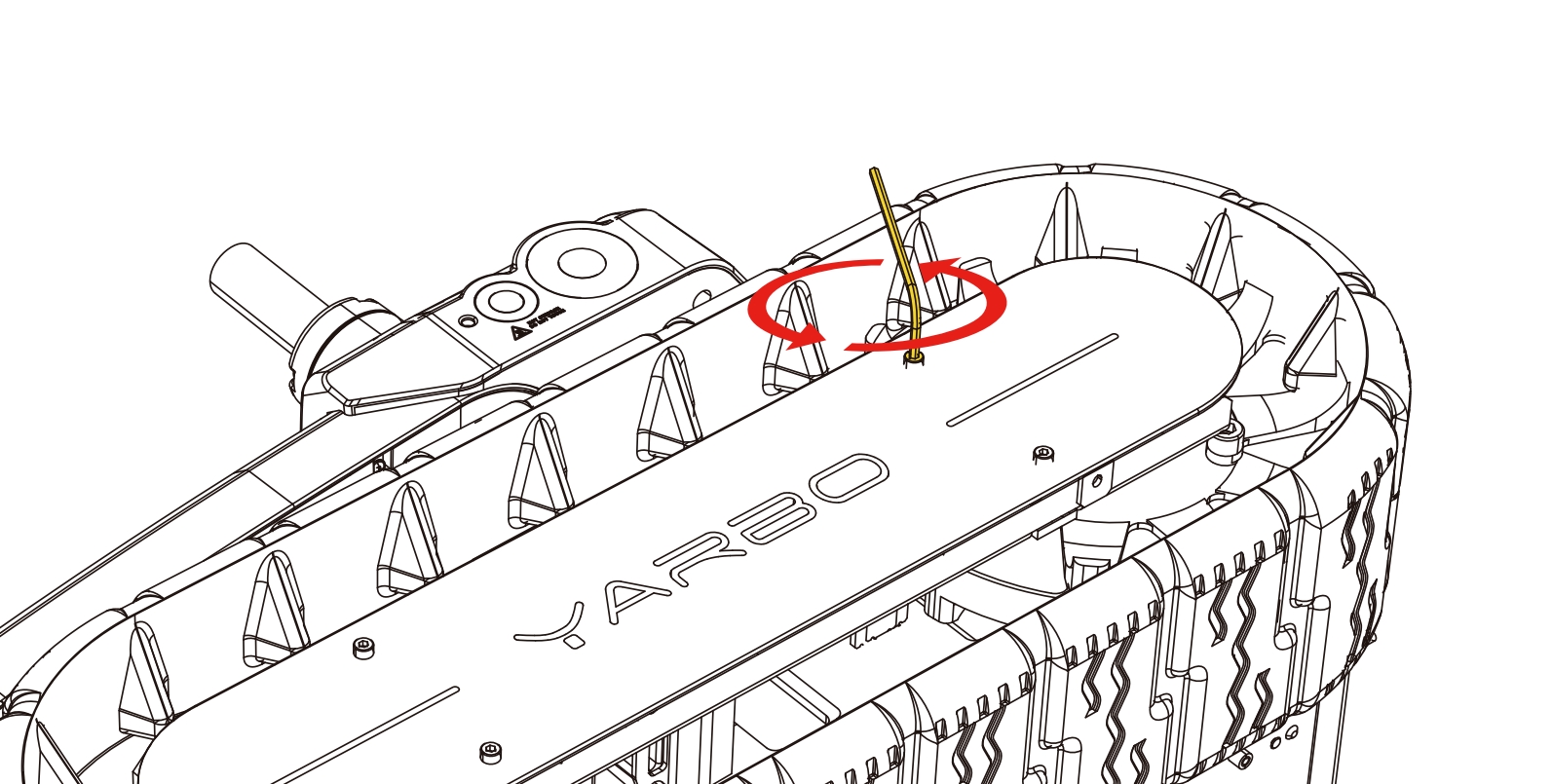

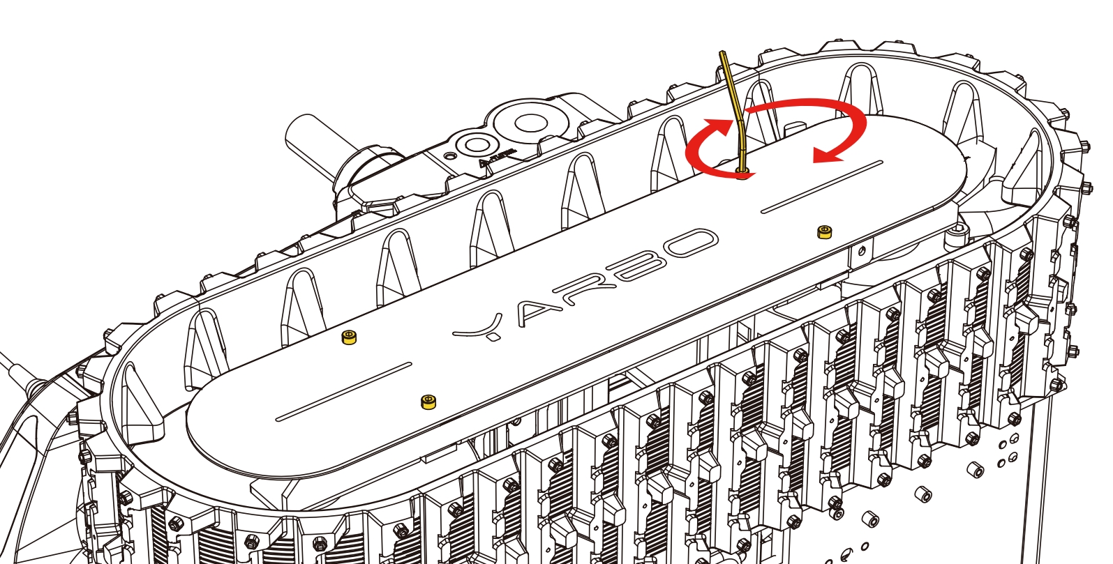

Using Allen Key #2, unscrew and remove the side panel that covers the track assembly. Ensure all screws are completely loosened and store them safely for reinstallation later.

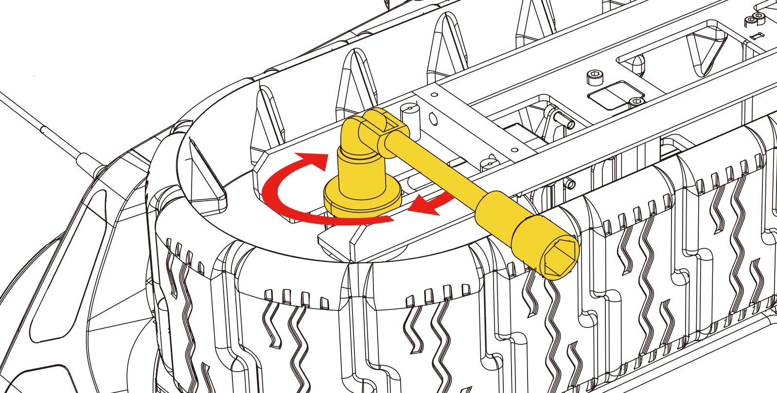

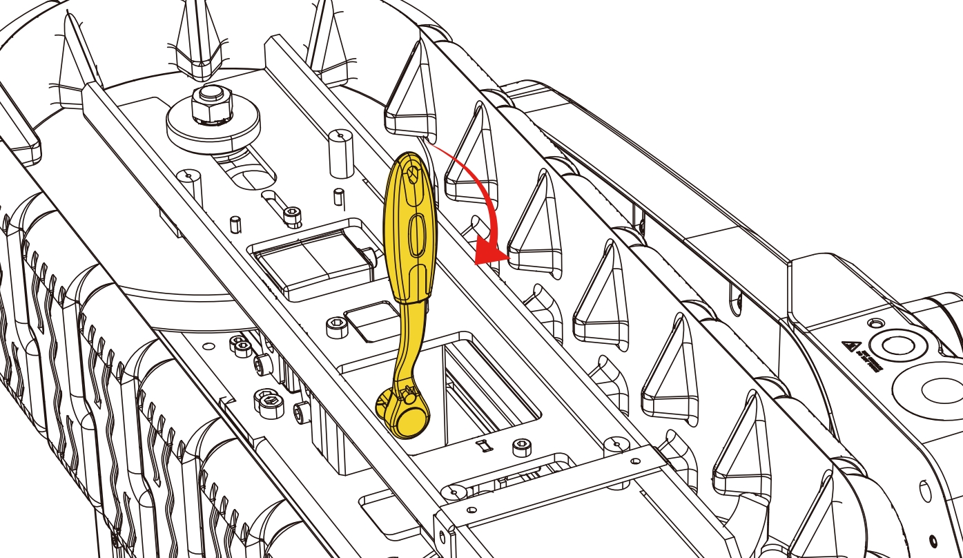

Using an L-shaped socket wrench, carefully loosen the screws, securing the track fixing structure. At this stage, avoid fully removing the screws, as this step is intended to remove the nuts.
This will allow some flexibility for the next steps.

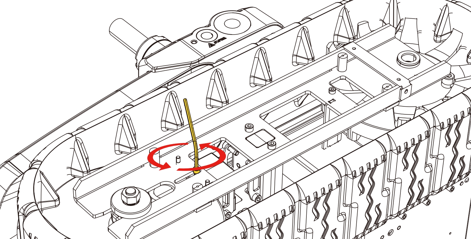

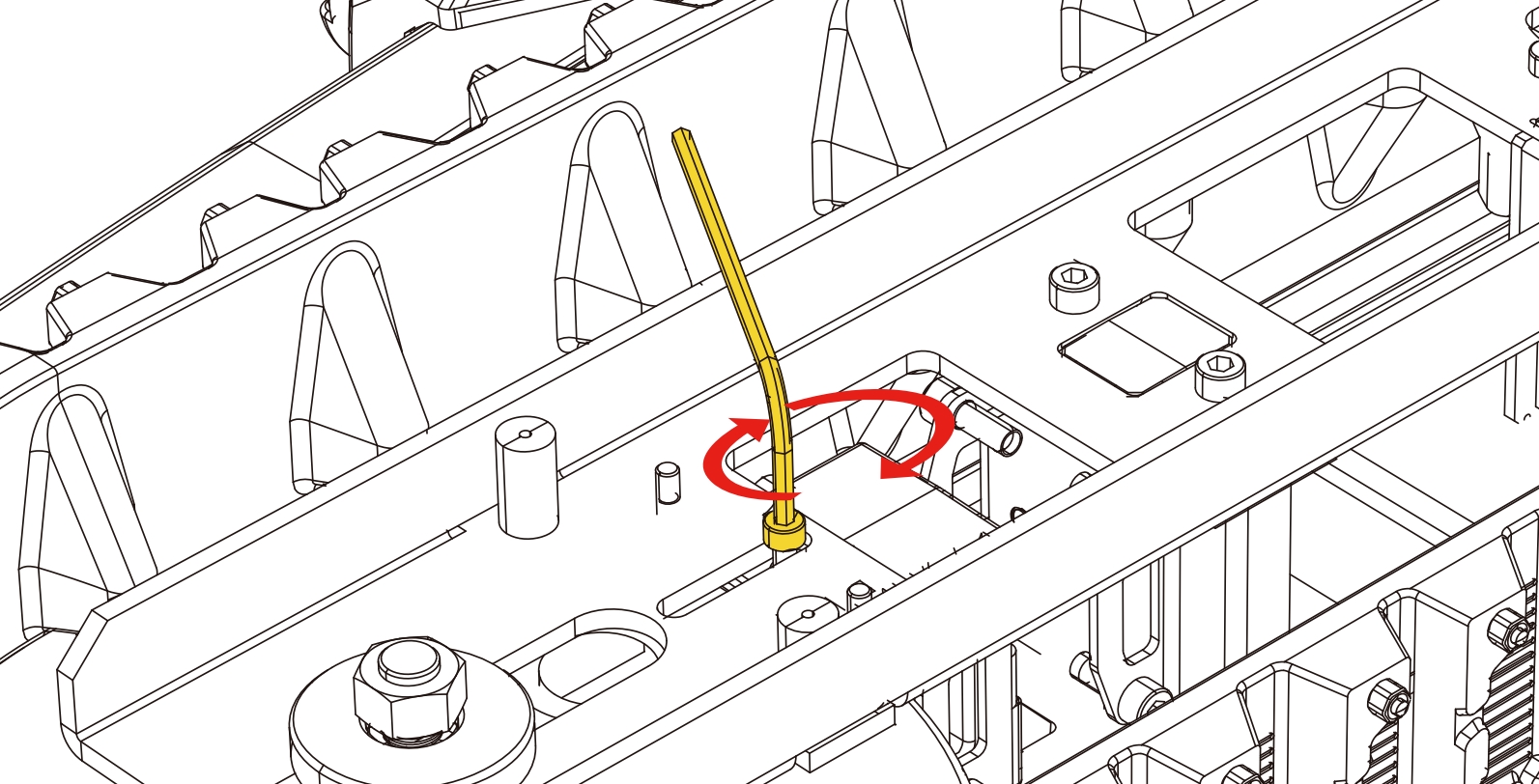

Next, take Allen Key #3 and fully unscrew the track fixing structure. Make sure to set these screws aside safely.

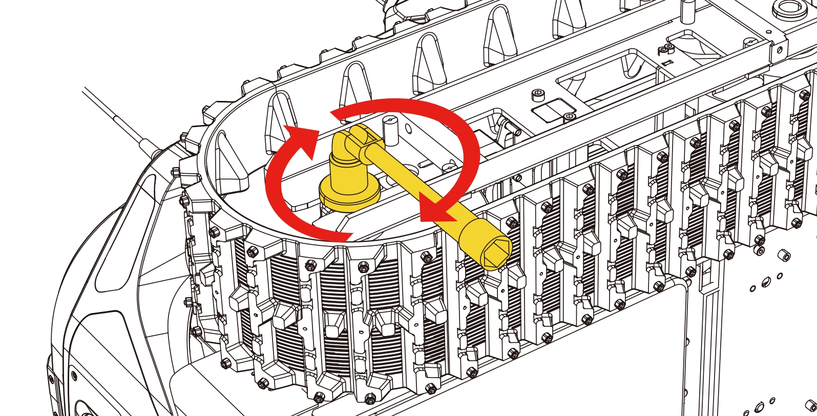

Using the track wrench, loosen the remaining screws that hold the track in place, do not remove the screws completely yet.
This step will help release tension in the track

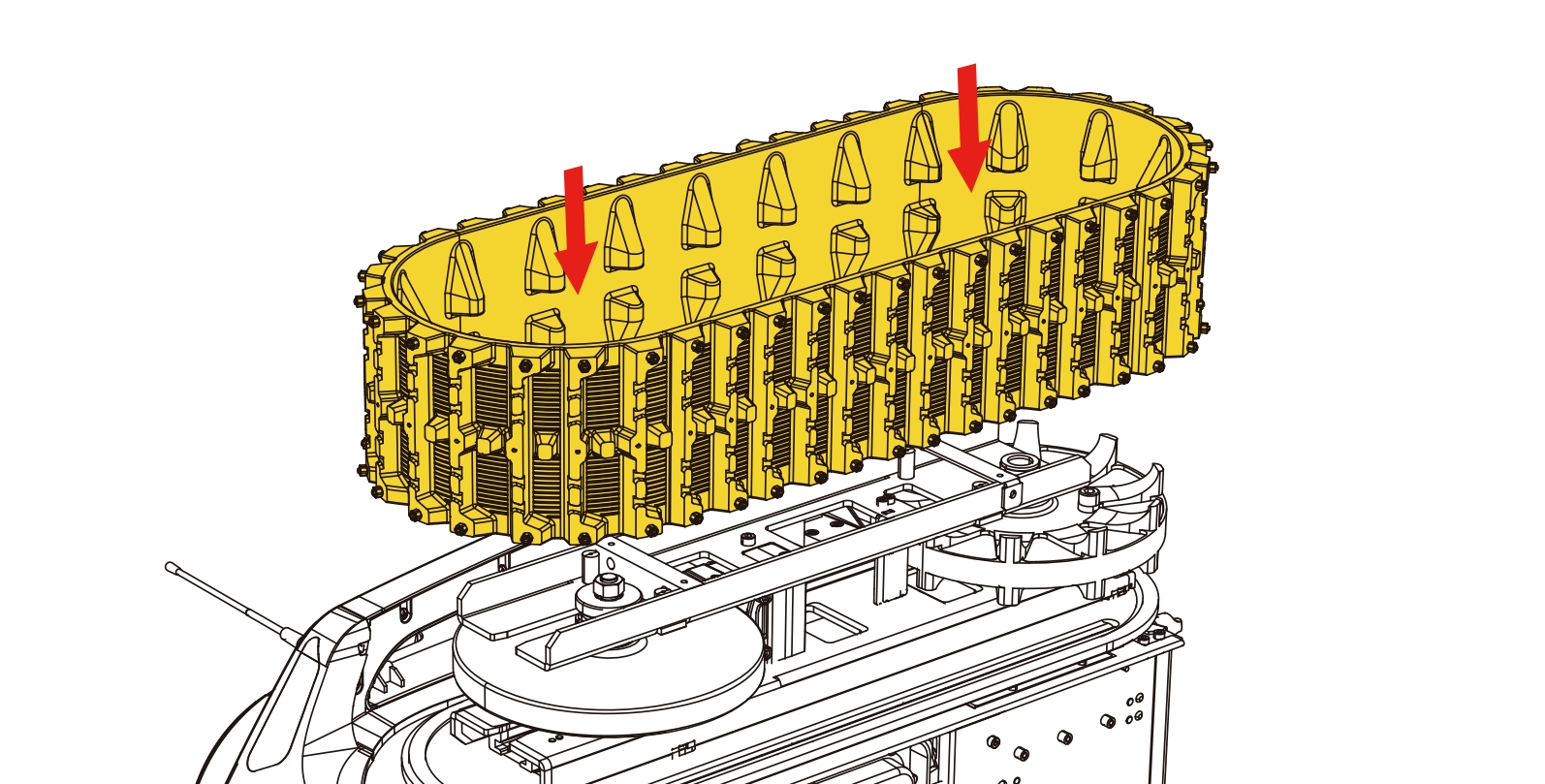

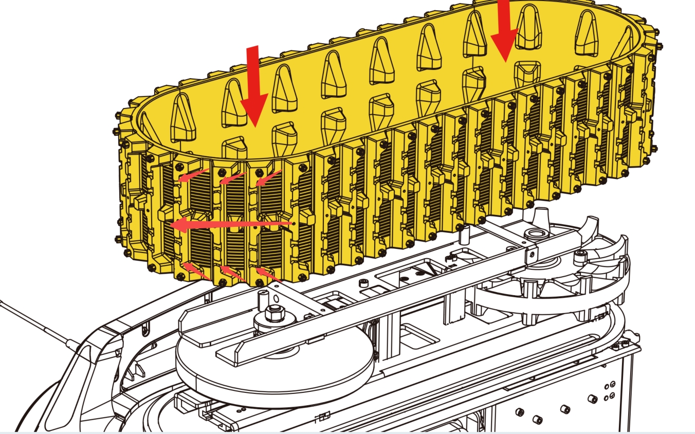

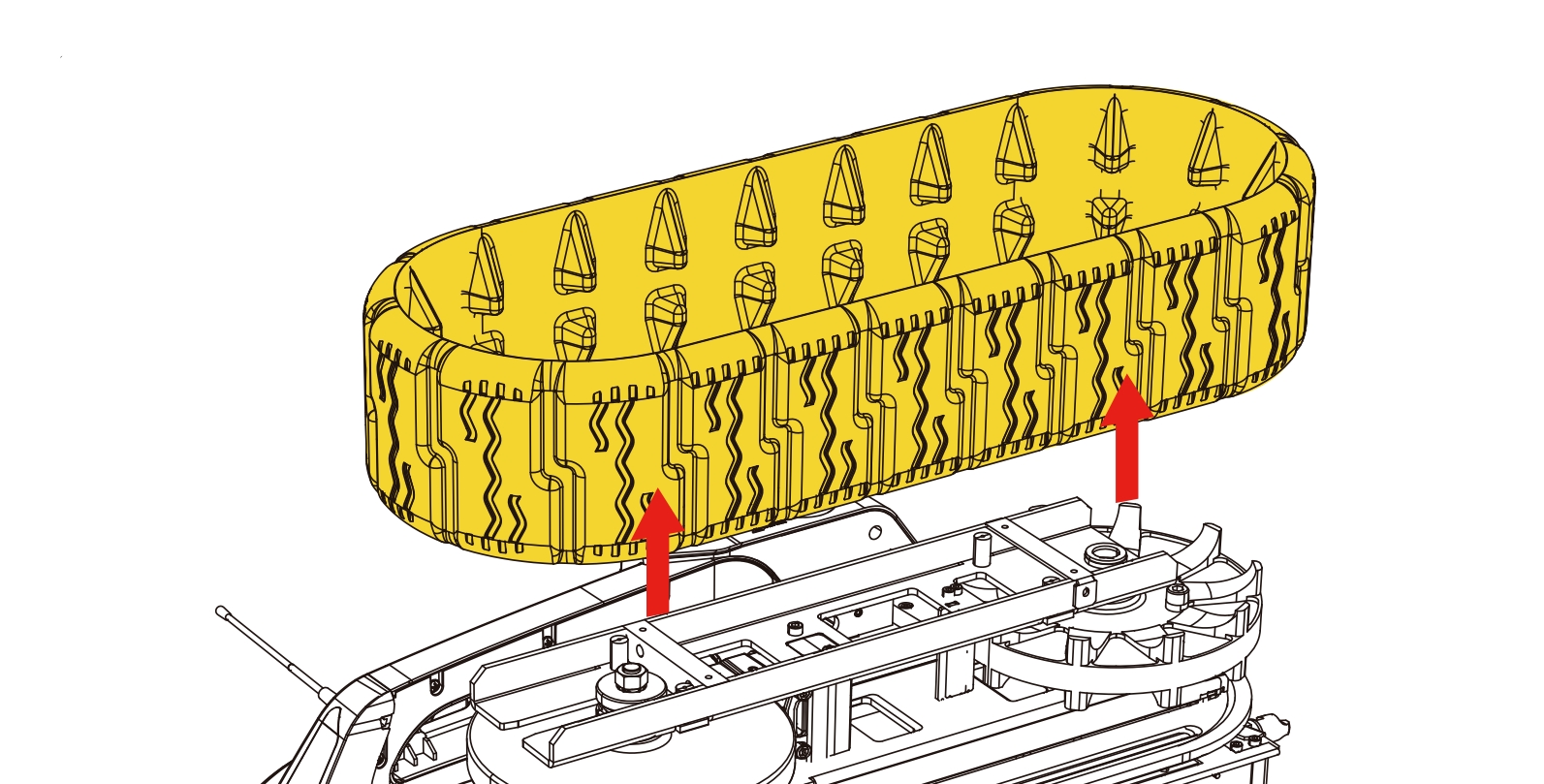

Now, carefully remove the old track from the Yarbo Core. If you encounter difficulty, repeat steps 4 and 6 to further loosen the screws and adjust the track tension. Once the old track is fully removed, install the new snow track in the same position, ensuring it is aligned as shown in the diagram.
Make sure snow tracks are installed in the correct direction. Refer to this article for detailed instructions:
Please be advised that it is essential to distinguish the correct track orientation when replacing the tracks. The diagram below illustrates the method for determining the track direction. Kindly pay close attention to this detail.

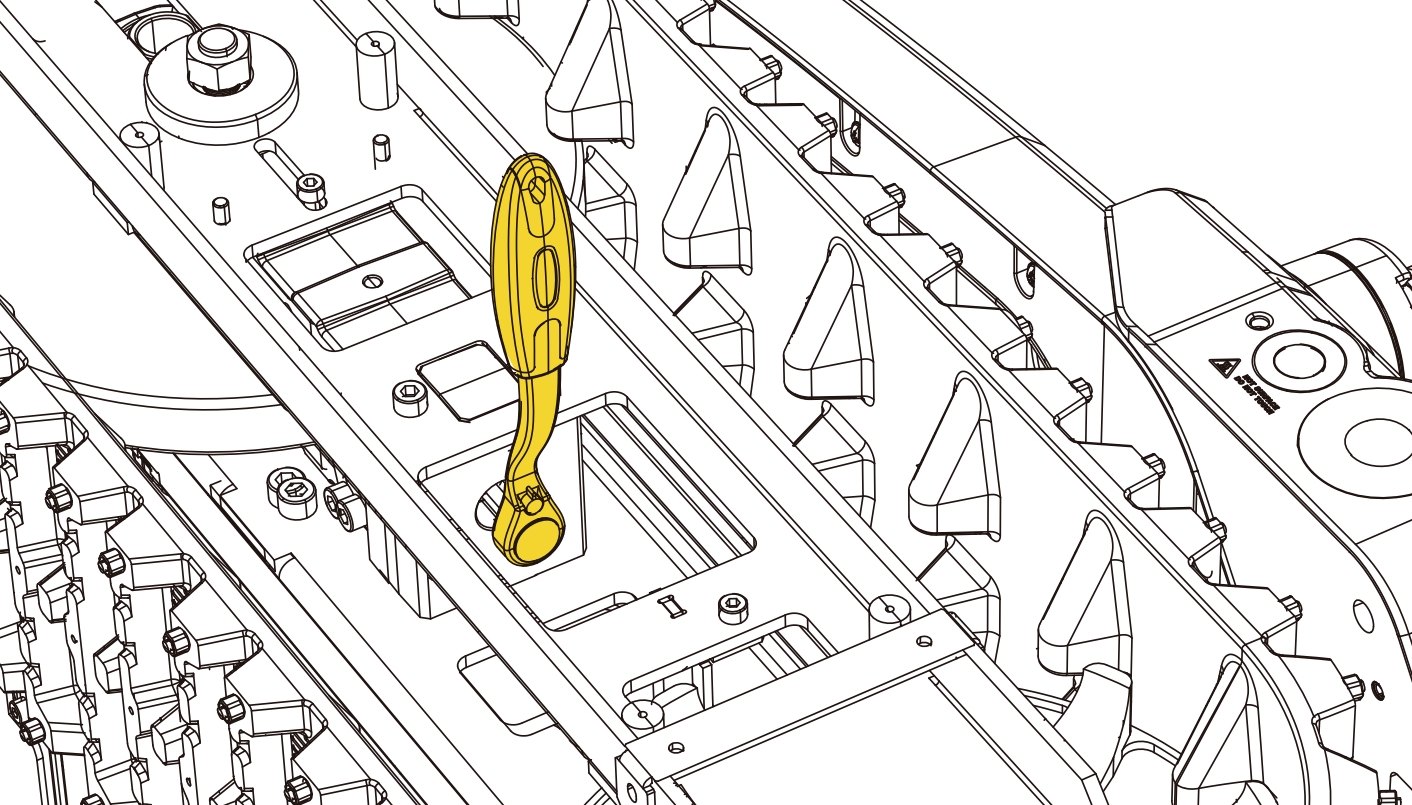

Just as during the removal process, use the track wrench, Allen Key #3, and L-shaped socket wrench to securely fasten the screws of the track fixing structure. Ensure all screws are properly tightened, and remember to use the L-shaped socket wrench to reinstall the nuts, maintaining the integrity of the track installation.
