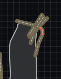

If you can, have your areas overlap around the perimeter an area it can’t destroy such as an asphalt entryway, concrete pathway.
If 2) is possible for you, make your pathways finish in that area. Yarbo has a tendency (that we all hope will be cured some day) to do zero-turns at start and end of pathways. If you can start and end pathways on areas that are not land, this helps protect against those unwanted zero-turns;
When you can’t make your pathways start/finish on such areas, make sure that the start and end are not too close of the edge to reduce the odds that Yarbo decides to do a dreaded zero-turn (at least in my situation, I noticed that if the pathways is far from the perimeter, zero-turns occur less frequently).

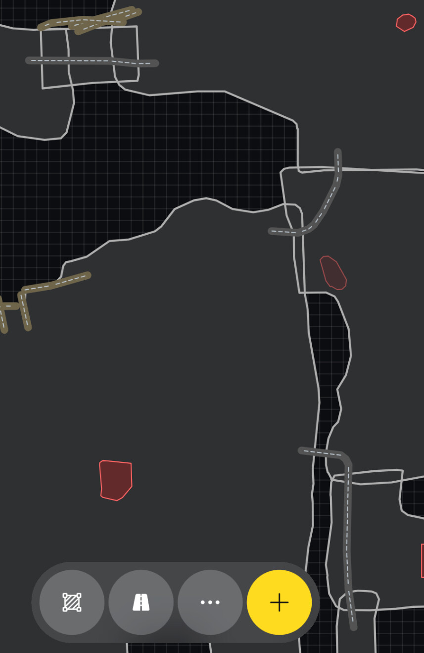

This one may not be for everyone, but vary your pathways if you can’t make them on concrete, asphalt or hard ground… Every week I change slightly the pathways that start and finish on grass, mainly between areas. Takes me about 10 minutes (I only have to redraw 3, the rest are either hidden or I don’t care), much faster than mowing the whole thing and it helps not having tracks around pathways (and in fact when you do that you don’t even see them anymore).
Hide as many pathways as you can behind garages, threes, bushes…

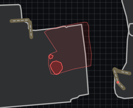

For areas you know are weak GPS spots, make sure that the robot will see the sky rapidly after entering those zone. I do that by either activating a NGZ when the orientation of the mow will make that zone be too long in this area, or by increasing the speed of mow.

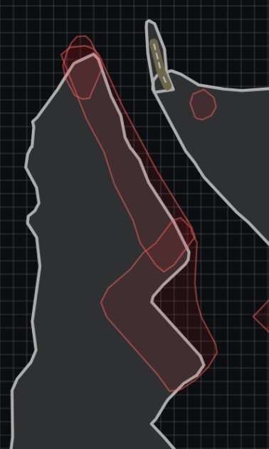

I have one area with weak GPS that was very problematic. I “solved it” by drawing a NGZ(No-go Zone) around it, and then starting a deadend in an area close by with good GPS and then draw that deadend to go into that weak zone and finish again in an area with good GPS, setting the speed at high… It works for this situation as it is close to the edge, can have a straight lines and I have strong GPS at start and finish… May be a “trick” to try if need be?

24 - Use a dead-end to poke the M1 under shrubs and bushes without putting the antennas in there. Start a decent distance away.
25 - if you’re lazy like me, one pathway can connect multiple areas. Yarbo will happily hop on or off when it needs to.
