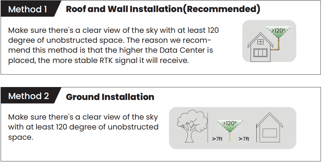

The key consideration when installing the Data Center Set is to ensure it has an unobstructed 120° view of the sky. This is essential for optimal operation. Please select the installation method that best suits your home environment.
Additionally, the Data Center requires a wired network connection. We provide a 30-meter Ethernet cable, but it’s important to choose a location that is close enough to your router while still maintaining the required 120° clear view of the sky.

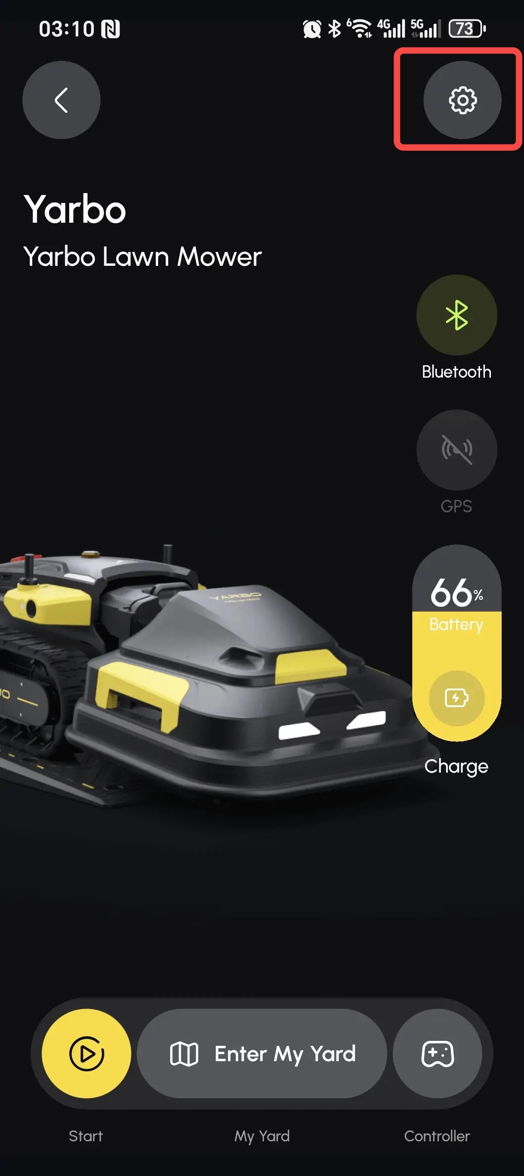

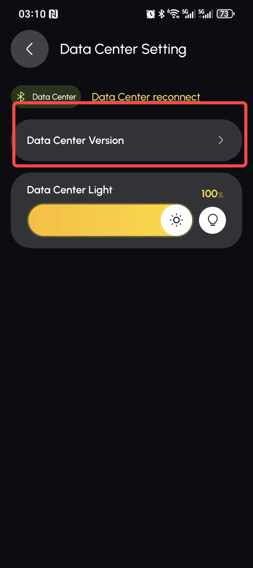

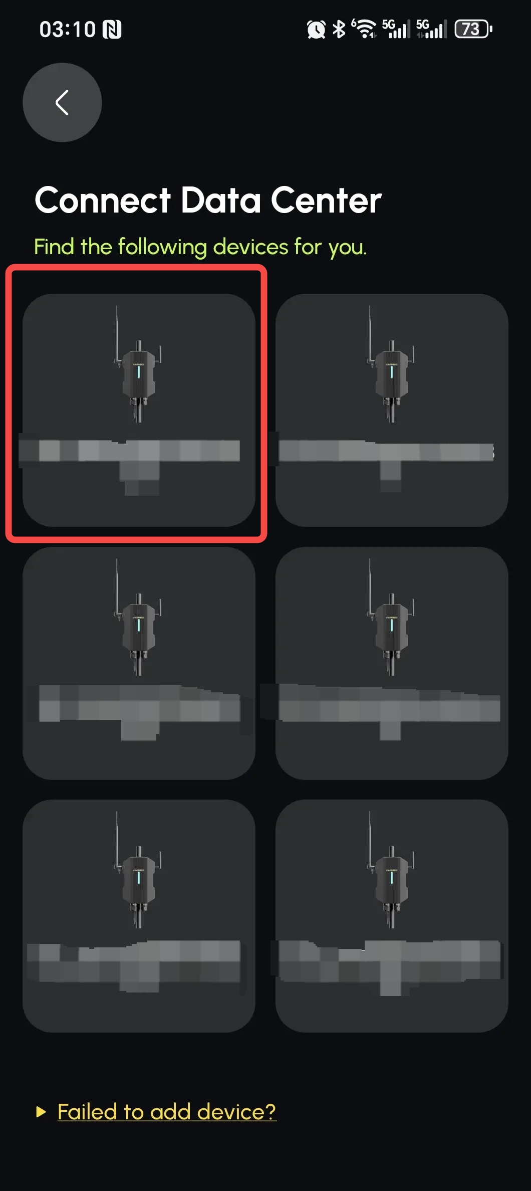

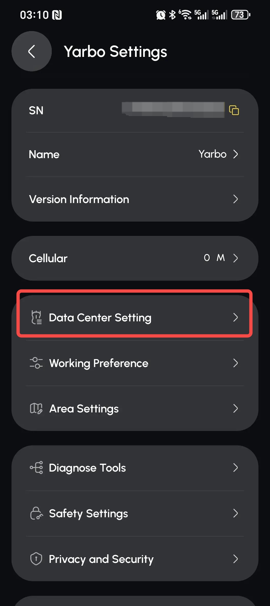

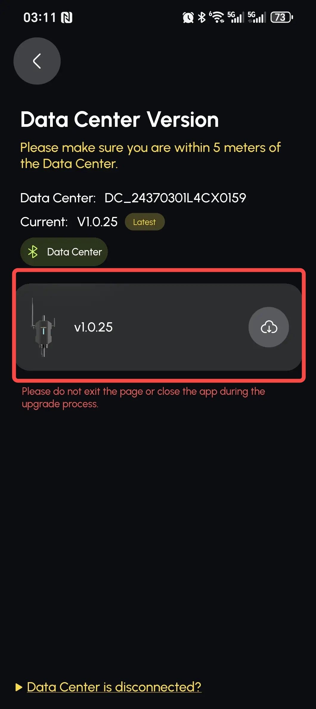

Main page -> Setting Icon-> Data Center Setting-> Data Center Version
Note: Please be aware that during the Data Center update process, all connected Yarbo will temporarily halt their operations.
