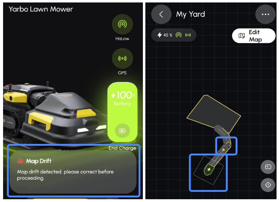

Under normal circumstances, the map within the app should accurately reflect Yarbo's relative position in the real environment. However, there may be instances where GPS signal instability causes a discrepancy between Yarbo's displayed position on the app and its actual location in the real world.
There's a map drift issue with the Yarbo in the app; however, the Yarbo is accurately stopped at the docking station.

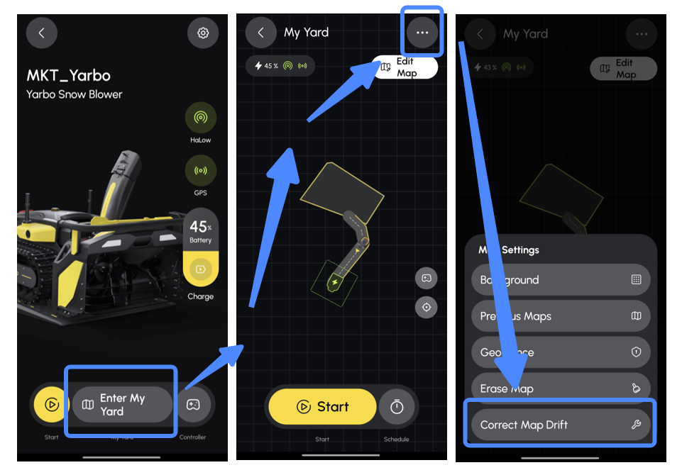

By taking these steps, you can work towards ensuring that the app's map more accurately represents Yarbo's true position.
