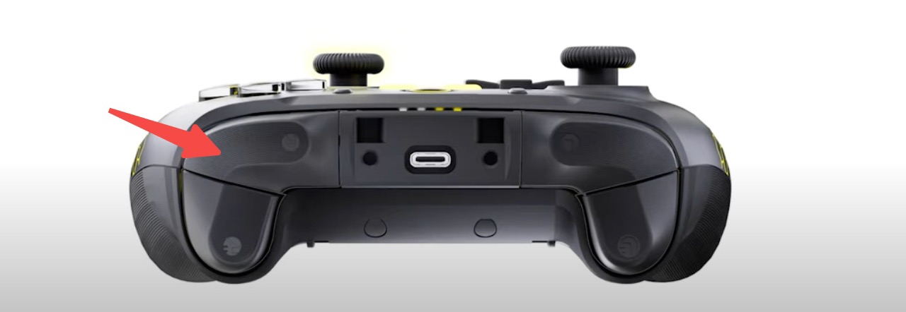

On the back of the controller, make sure the glide switch is pushed to the right side.
