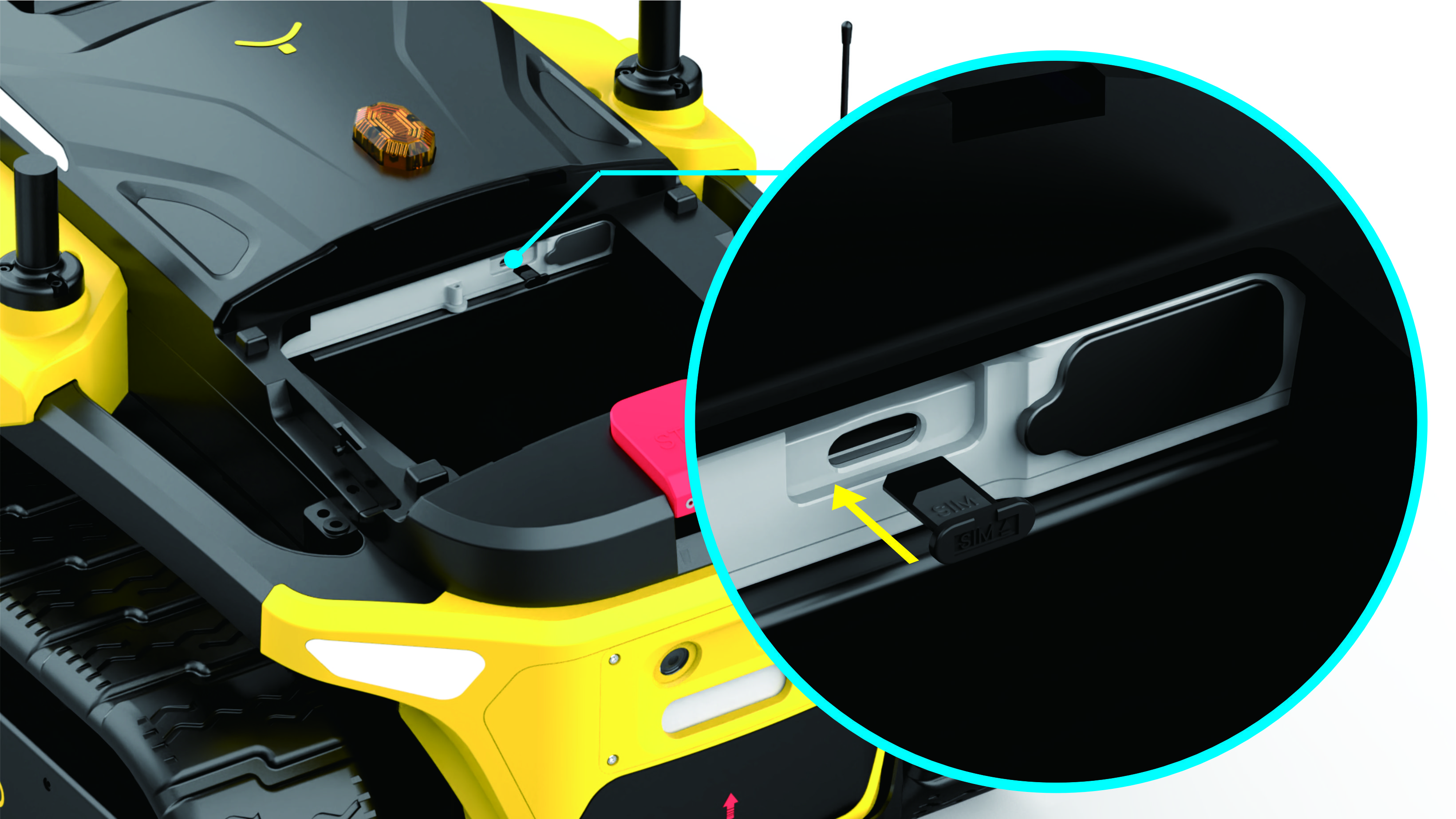

The first step in troubleshooting a non-detected SIM card is to physically inspect the SIM card slot on your device. Here’s what you should do:
After reinserting the SIM card, power on your Yarbo. Sometimes, a simple reboot can resolve connectivity issues. During the power-on process, the device will attempt to reinitialize the SIM card and establish a connection with the network.
