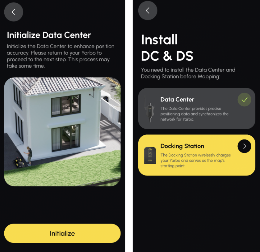

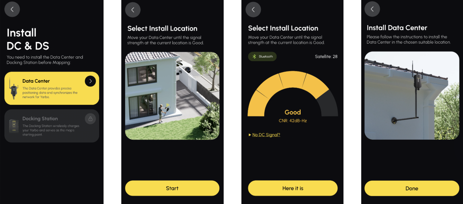

The key consideration when installing the Data Center Set is to ensure it has an unobstructed 120° view of the sky. This is essential for optimal operation. Please select the installation method that best suits your home environment.
Additionally, the Data Center requires a wired network connection. We provide a 30-meter Ethernet cable, but it’s important to choose a location that is close enough to your router while still maintaining the required 120° clear view of the sky.
To ensure the safety of the Data Center when installed on rooftops, it is essential to implement robust lightning protection measures to prevent damage from lightning strikes. In regions where lightning is common, the risk of damage significantly increases. We highly recommend users in high-risk areas purchase a grounding cable, which safely redirects excess electrical current into the ground, thereby minimizing the risk of damage to the Data Center.
