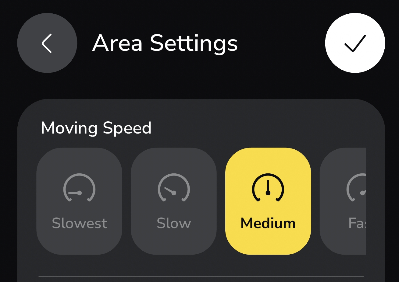

In the “Area Settings” page, you can adjust the moving speed of your Yarbo lawn mower, with five speed levels ranging from 0.3m/s to 0.65m/s:
▸ Slowest/Slow/Medium/Fast/Fastest
Increasing the moving speed reduces the overall mowing time. However, it’s important to note that mowing speed can affect the cutting quality: faster speeds may reduce precision, while slower speeds typically result in a cleaner, more precise cut.

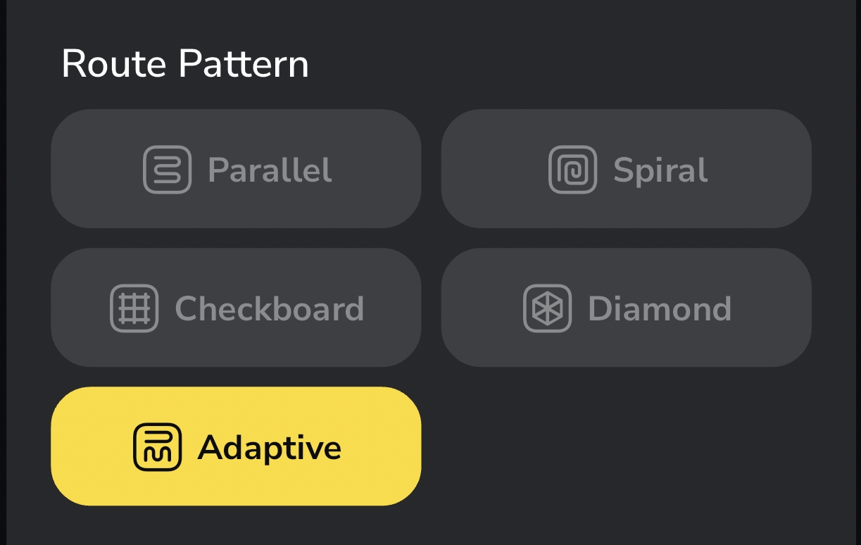

The Adaptive Route Mode has been introduced to provide more flexible area routing options.
📍 To enable it, go to Area Settings and switch the route pattern to Adaptive Route Mode.
When selected:
The Yarbo Lawn Mower will automatically choose the nearest starting point to begin mowing.
Instead of mowing around each no-go zone perimeter separately, it will mow the perimeter of a no-go zone when it naturally reaches it along the set route.
Reduces unnecessary travel lines that cut across an area.
Minimizes lawn wear by applying adaptive routes that reduce frequent turns in narrow spaces.\

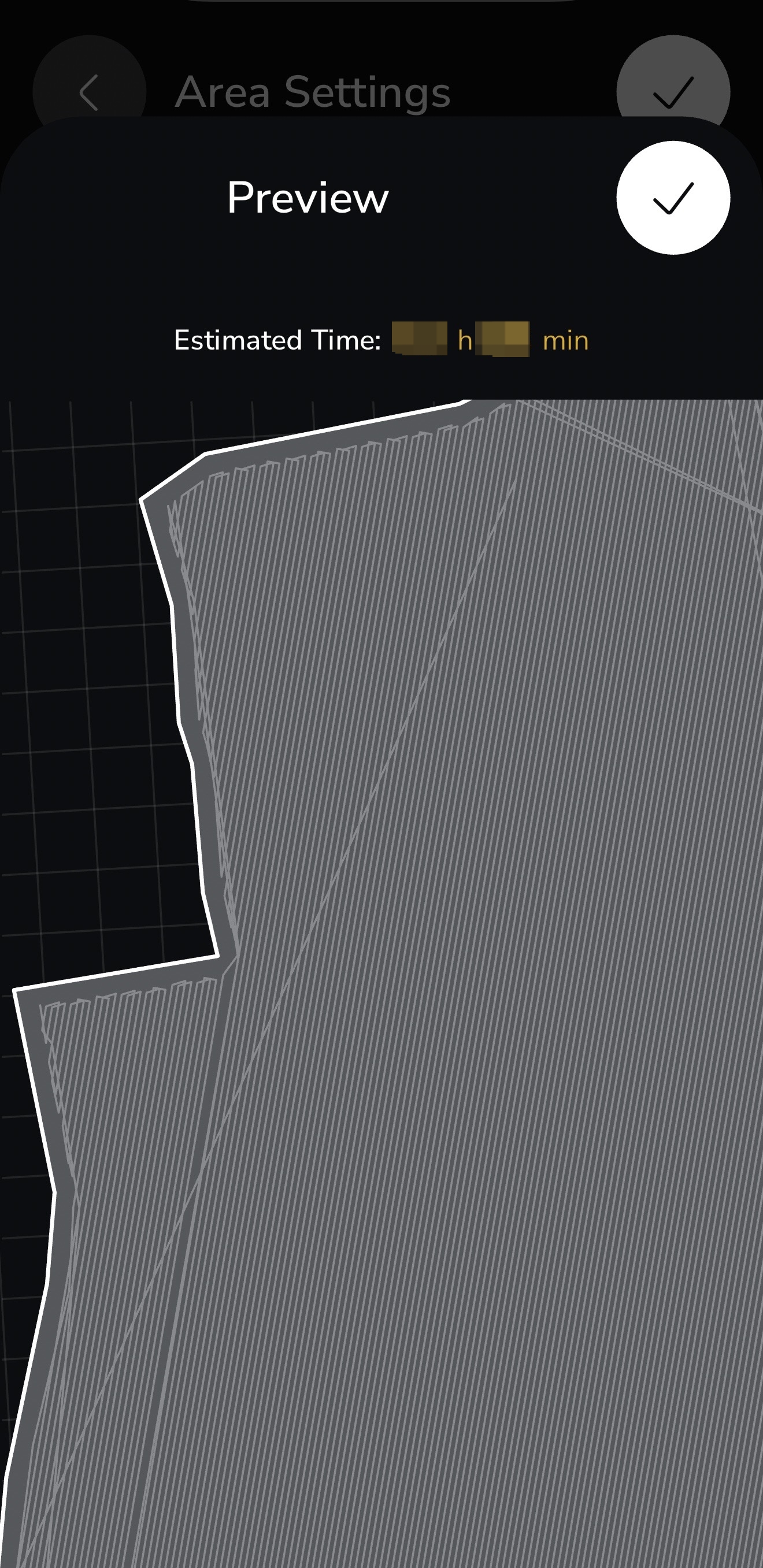

Explanation: This setting allows you to manually adjust the angle of the mowing path to match your preferences. By setting a fixed angle, you ensure that the mowing direction aligns with your desired lawn design and overall aesthetic.
Adjustments: Each time you modify the angle, the change will be shown in preview mode, enabling you to visualize the adjustments before applying them to your mowing session.
The following picture illustrates the path adjustment when the route angle is set to 90°.

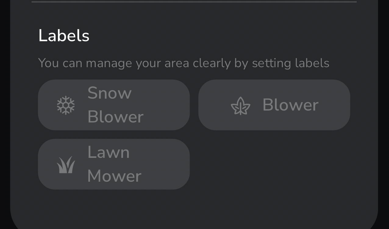

We’ve introduced label-based weighting to guide how the rover chooses its travel path. When moving between different areas or traveling to and from the docking station, the system now prioritizes area labels in addition to other routing factors.

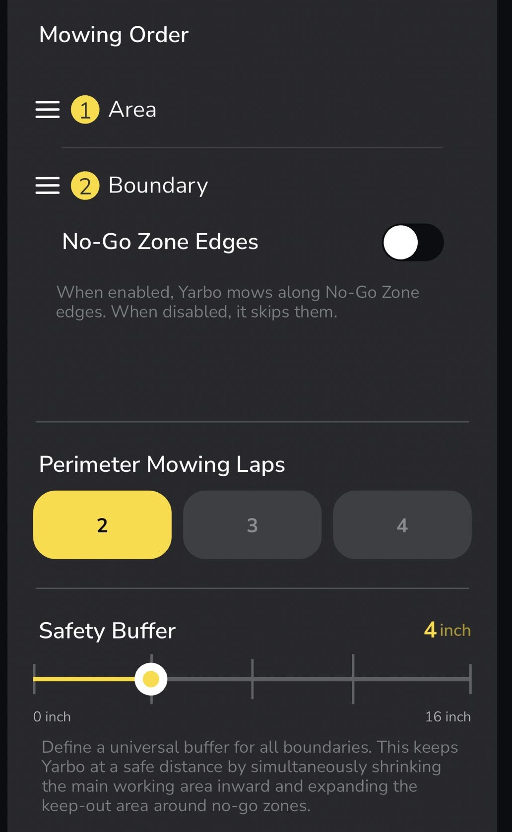

Zone-Specific: The Perimeter Mowing Laps setting applies only to the selected area and does not affect the boundaries of No-Go zones.
Automatic Plans: This setting cannot be modified in auto plans; it must be set manually in the area settings.
Pattern Dependency: The Perimeter Mowing Laps count is only available when the mowing pattern is set to "zigzag". If the mowing pattern is set to "Spiral," the Perimeter Mowing Laps option will not be displayed.
Improved Coverage: Increasing the number of Perimeter Mowing Laps ensures that the edges of your lawn are thoroughly mowed, reducing the likelihood of missed spots.
Customizable: Users can tailor the number of laps to their specific lawn conditions and preferences.
Efficiency: While increasing laps can extend the mowing time, it ensures a more comprehensive and neat finish.
Imagine you have a rectangular lawn with a complex border. By setting the Perimeter Mowing Laps to 3, you can ensure that the mower makes multiple passes along the edges, effectively covering any difficult-to-reach areas and maintaining a uniform appearance.

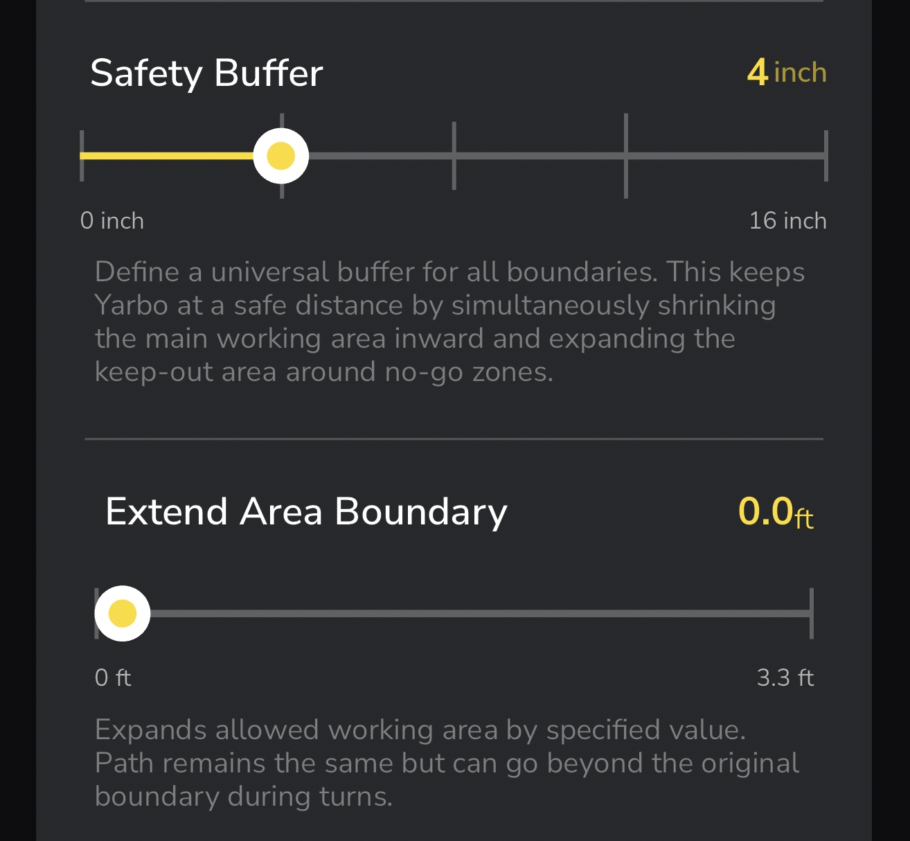

Expands allows working area by specified value. Original path remains the same but allows user to customize how far Yarbo can extend beyond the boundaries during turns. Available range: 0 to 3.3 feet.
