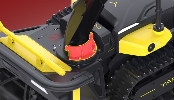

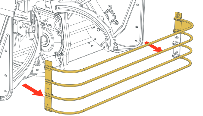

For better airflow, remove the snow plume diverter and the lower bars of the protection fence.
This helps prevent snow buildup and improves clearing efficiency.
| Plume Diverter |
| Protection Fence |
