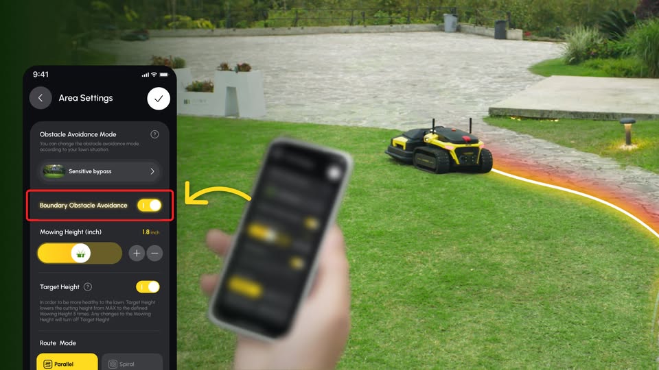

When Boundary Obstacle Avoidance is ON Yarbo will intelligently bypass obstacles along the boundary using both visual and ultrasonic sensors—based on the Obstacle Avoidance Mode you select (Sensitive / Moderate / Gentle Contact / Custom).
When It's OFF Yarbo will turn off visual and ultrasonic obstacle detection near boundaries, but still rely on its physical bumper bar for basic collision response.
This gives you more control over how Yarbo reacts to complex edges like fences, trees, or garden decor. Test it out and adjust for the perfect balance of caution and confidence!

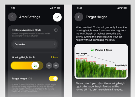

Want a thriving, stress-free lawn? Yarbo’s Target Height is here to help!
This smart feature gradually lowers your mowing height over five sessions-giving your grass time to adjust and recover between trims. E.g, set your target at 3 inches, and Yarbo will start from 4 inches, trimming just 0.2 inches at a time until your lawn hits the ideal height.
If you manually change the mowing height during the process, the system will turn off Target Height automatically.

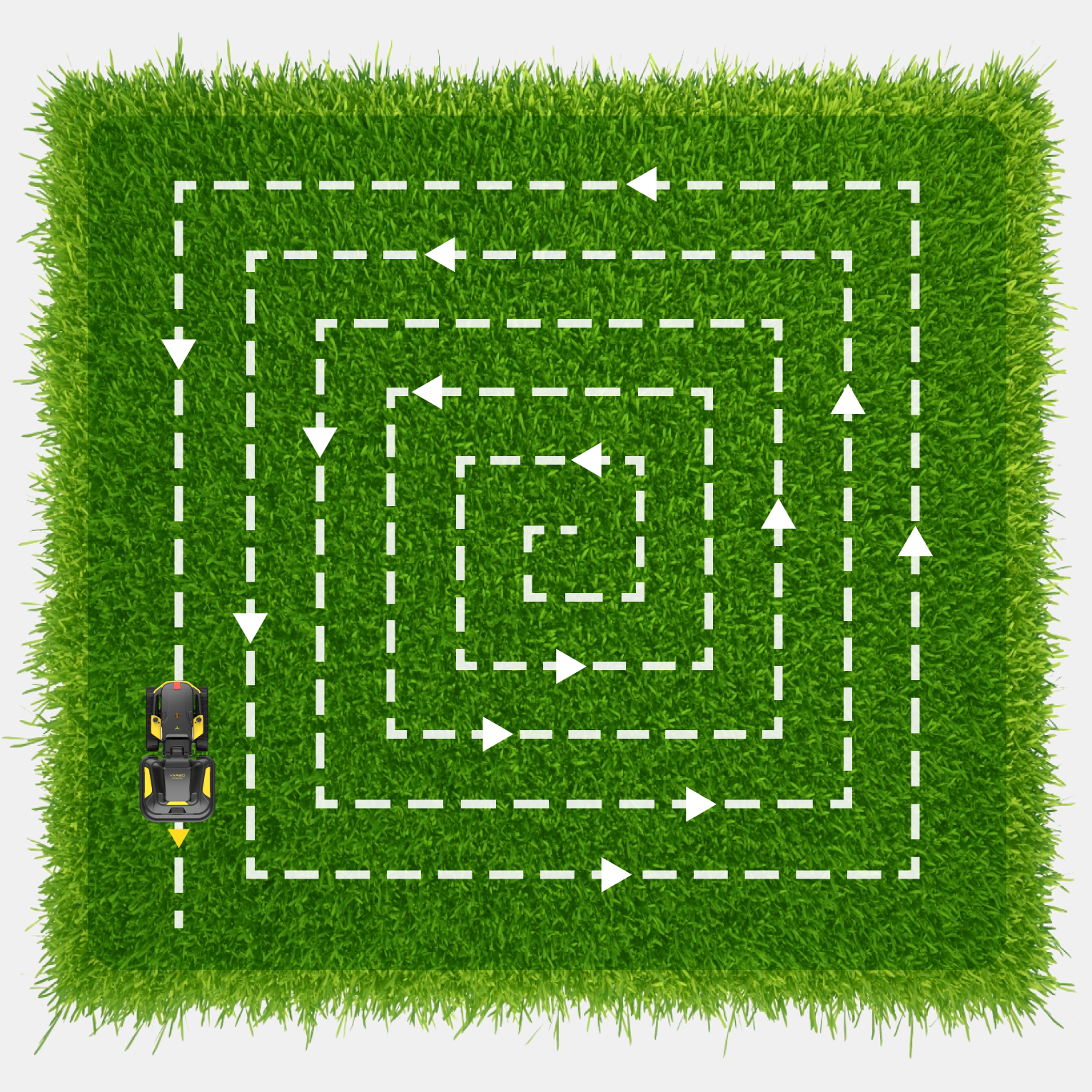

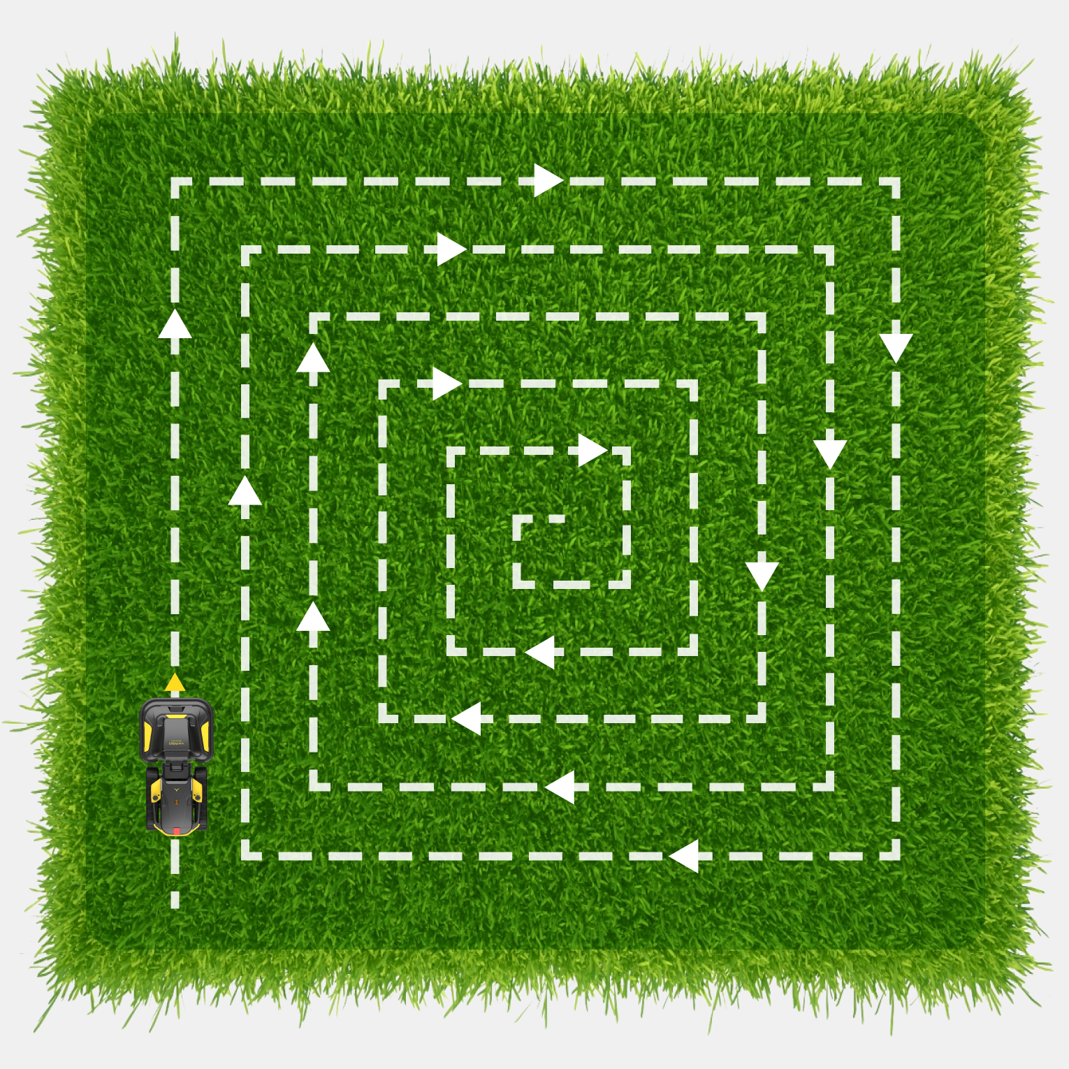

A pattern that follows an automated spiral route based on the algorithm (so the sequence of whether it starts from outer to the center or from center to the outer may vary), ensuring a smooth and consistent mowing experience.

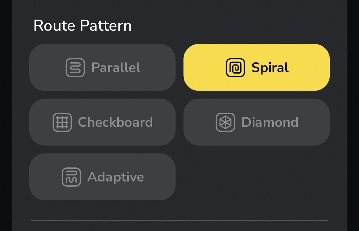

The Adaptive Route Mode has been introduced to provide more flexible area routing options.
📍 To enable it, go to Area Settings and switch the route pattern to Adaptive Route Mode.

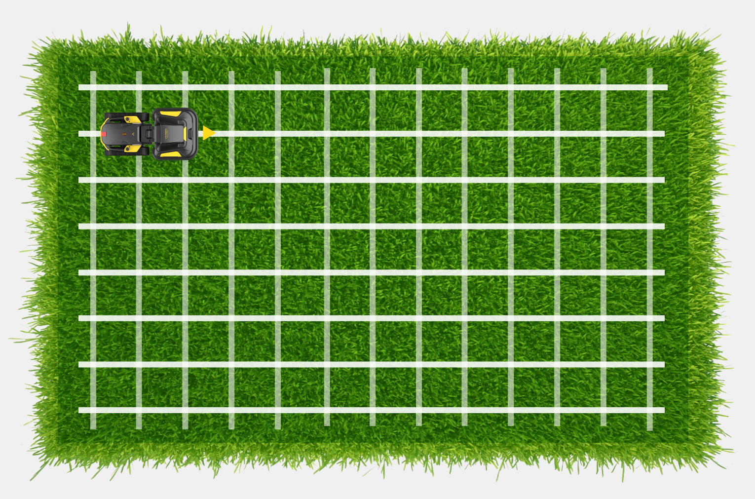

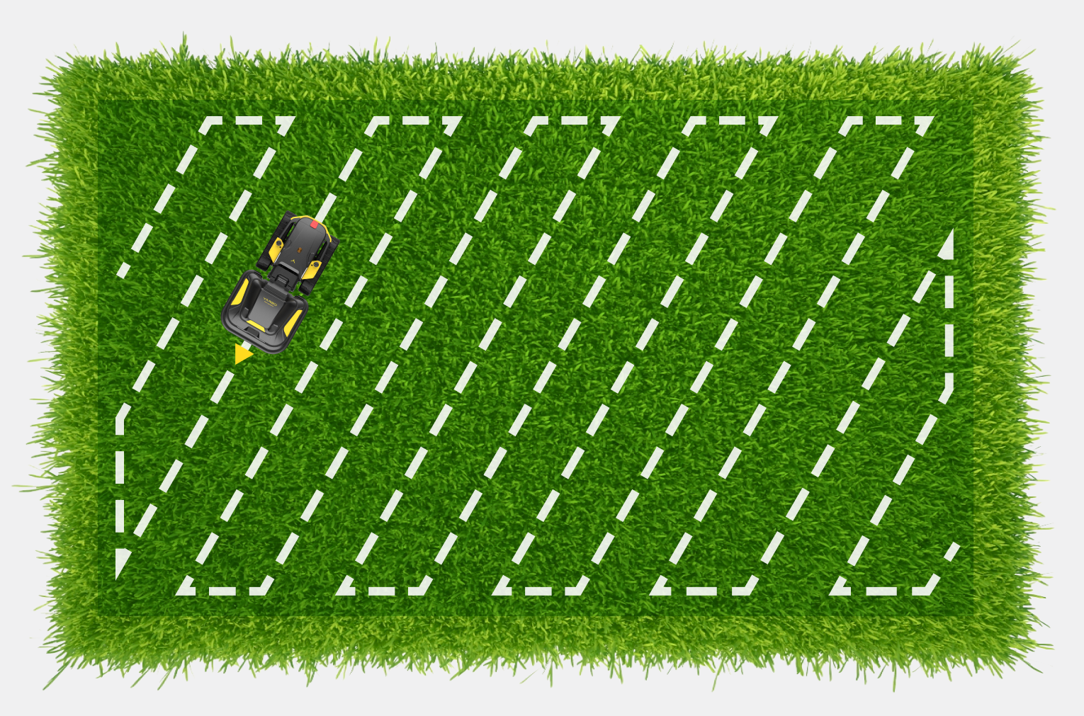

Explanation: This setting allows you to manually adjust the angle of the mowing path to match your preferences. By setting a fixed angle, you ensure that the mowing direction aligns with your desired lawn design and overall aesthetic.
Adjustments: Each time you modify the angle, the change will be shown in preview mode, enabling you to visualize the adjustments before applying them to your mowing session.
The following picture illustrates the path adjustment when the route angle is set to 90°.

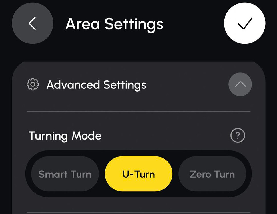

Turn modes are automatically adjusted in specific situations. For example:
Spiral Mode disables U-Turn and enforces Smart Turn.
In tight spaces or when the rear camera detects obstacles, Yarbo will automatically switch to Zero Turn for maneuverability (e.g., when the path is narrower than one Yarbo length).

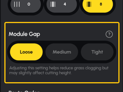

In the Area Settings, you can adjust the overlap, which impacts mowing efficiency:
A lower overlap reduces overall working time.
However, a lower overlap increases the risk of uncut grass. We recommend experimenting with the overlap setting to find the balance that works best for your lawn.
Loose (Default): Provides the most precise mowing performance.
Medium: A balanced setting for effective mowing with improved resistance to clogging.
Tight: Ideal for uneven terrain, thick grass, or less-maintained areas such as hillsides, rocky patches, or wild zones. Helps reduce clogging. Note: Selecting “Tight” may slightly affect mowing height precision.

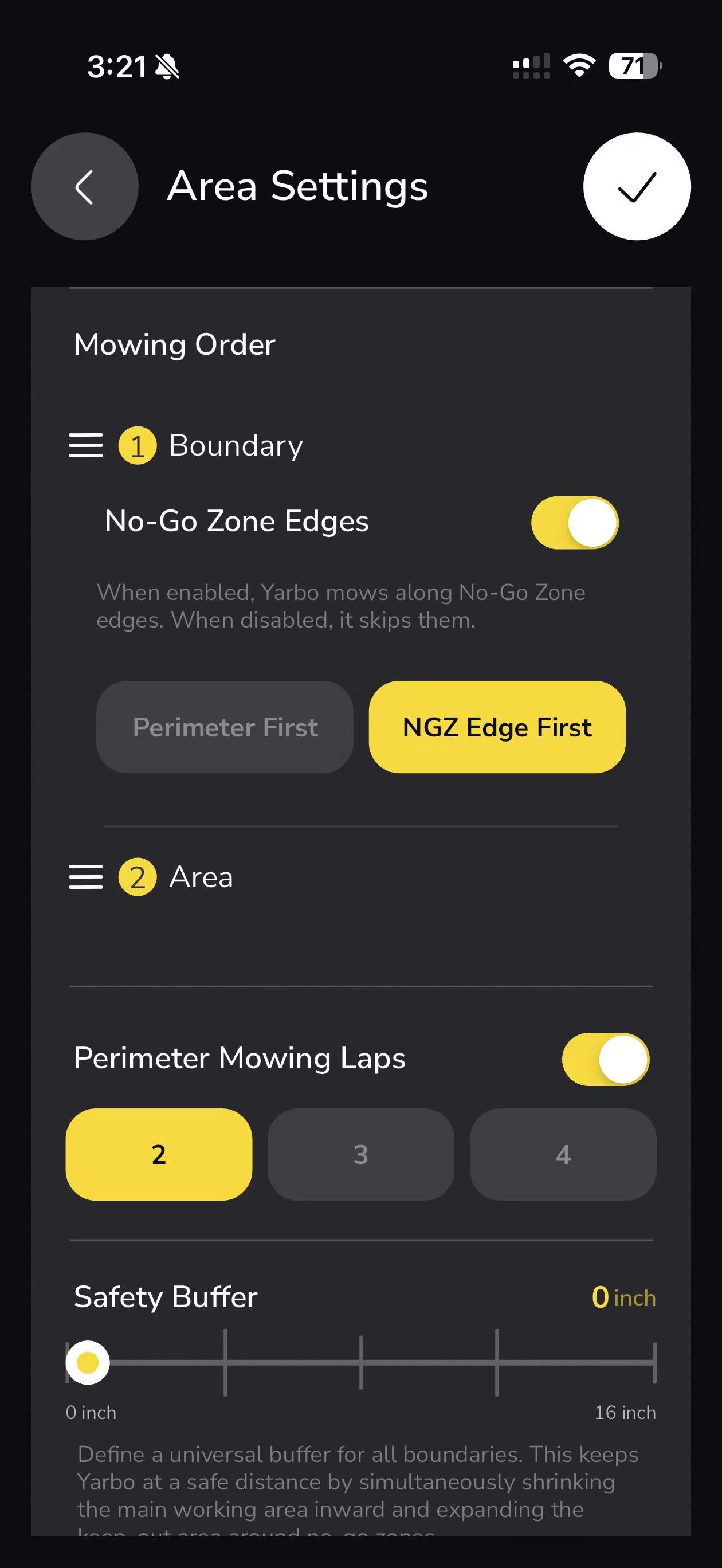

Zone-Specific: The Perimeter Mowing Laps setting applies only to the selected area and does not affect the boundaries of No-Go zones.
Automatic Plans: This setting cannot be modified in auto plans; it must be set manually in the area settings.
Pattern Dependency: The Perimeter Mowing Laps count is only available when the mowing pattern is set to "zigzag". If the mowing pattern is set to "Spiral," the Perimeter Mowing Laps option will not be displayed.
Improved Coverage: Increasing the number of Perimeter Mowing Laps ensures that the edges of your lawn are thoroughly mowed, reducing the likelihood of missed spots.
Customizable: Users can tailor the number of laps to their specific lawn conditions and preferences.
Efficiency: While increasing laps can extend the mowing time, it ensures a more comprehensive and neat finish.
Imagine you have a rectangular lawn with a complex border. By setting the Perimeter Mowing Laps to 3, you can ensure that the mower makes multiple passes along the edges, effectively covering any difficult-to-reach areas and maintaining a uniform appearance.
