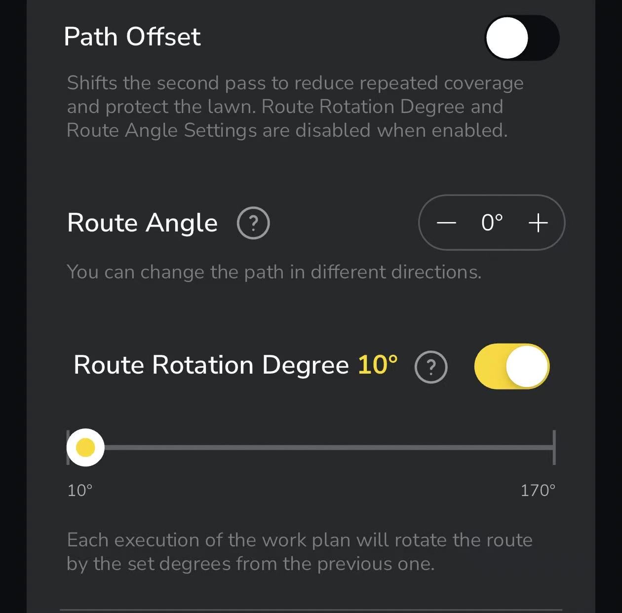

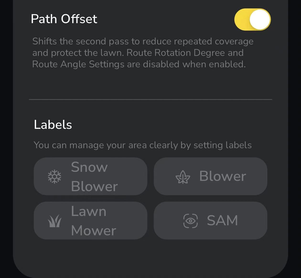

The Path Offset feature shifts Yarbo's working path slightly with each task cycle, preventing the rover from repeatedly traveling on the exact same lines within a work area. Over time, repeated passage on identical paths can cause turf damage and rutting — Path Offset distributes the wear across a wider zone to keep your lawn healthier.
When Path Offset is enabled, Yarbo automatically shifts its planned working path by 4 inches (10 cm) each cycle. Shifting continues progressively until the cumulative offset reaches your Overlap setting — at which point it returns to the original path and the cycle repeats.
