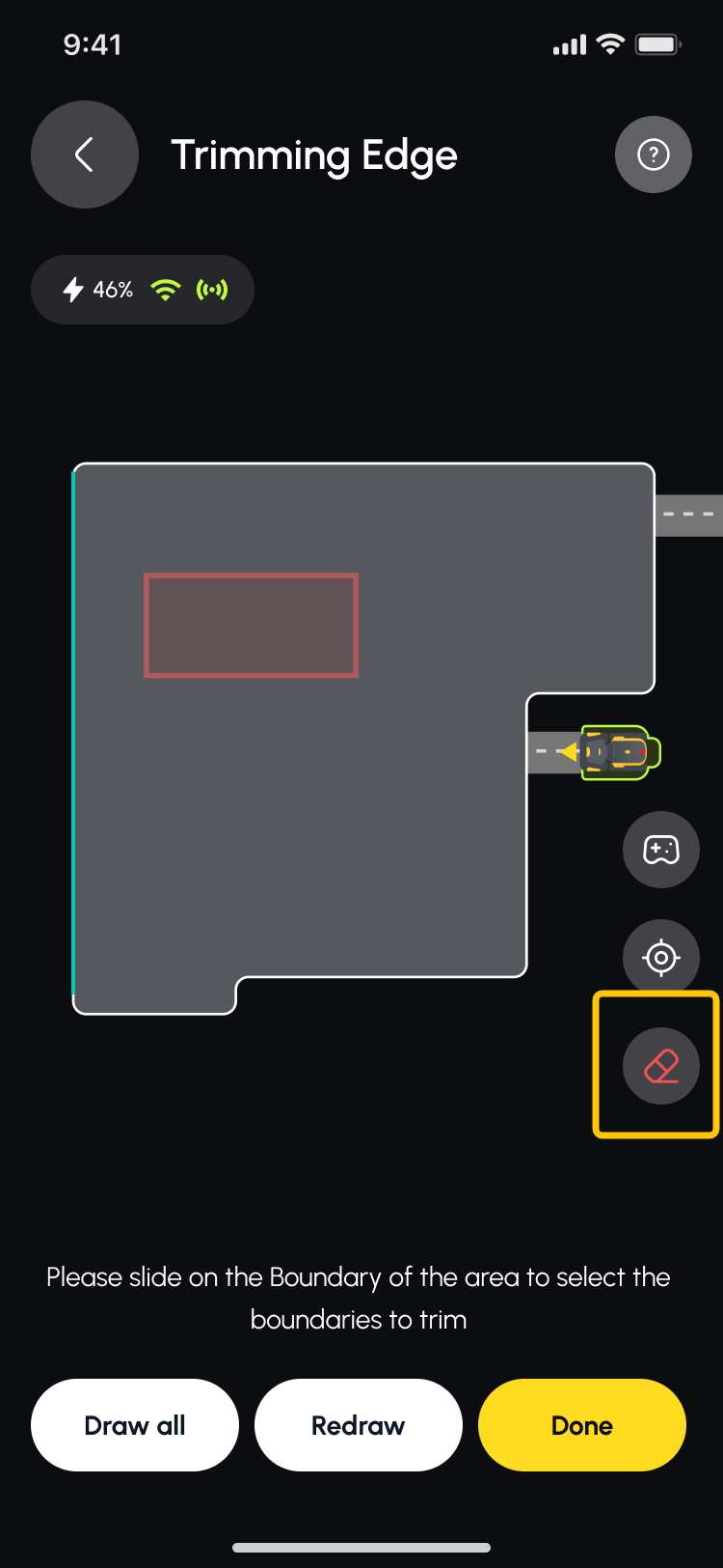

| While drawing the trimming edge, you can tap the eraser icon to enter delete mode. Once in delete mode, simply slide along the boundary of the area to select and remove the trimming edge you want to delete. |

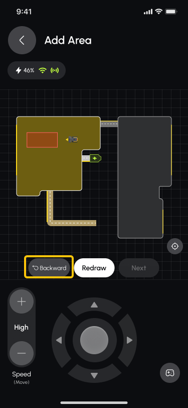

When drawing a map, you can now use the backward feature to retrace sections of the path you’re not satisfied with or where GPS signal was lost. Press and hold the backward button to make the rover follow the most recently drawn path in reverse, and release the button to stop the movement. Please note that obstacle avoidance is disabled while using the backward feature, so keep the unit within sight during operation. |

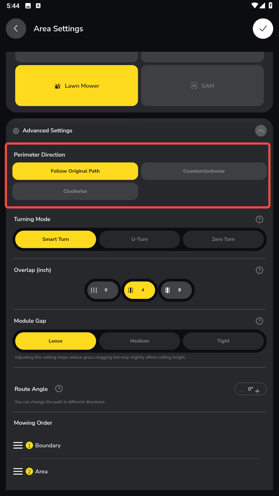

| You can now select the perimeter direction for operations with the Lawn Mower, Lawn Mower Pro, and Smart Assist module. Available options include Follow Original Path, Clockwise, and Counterclockwise. |

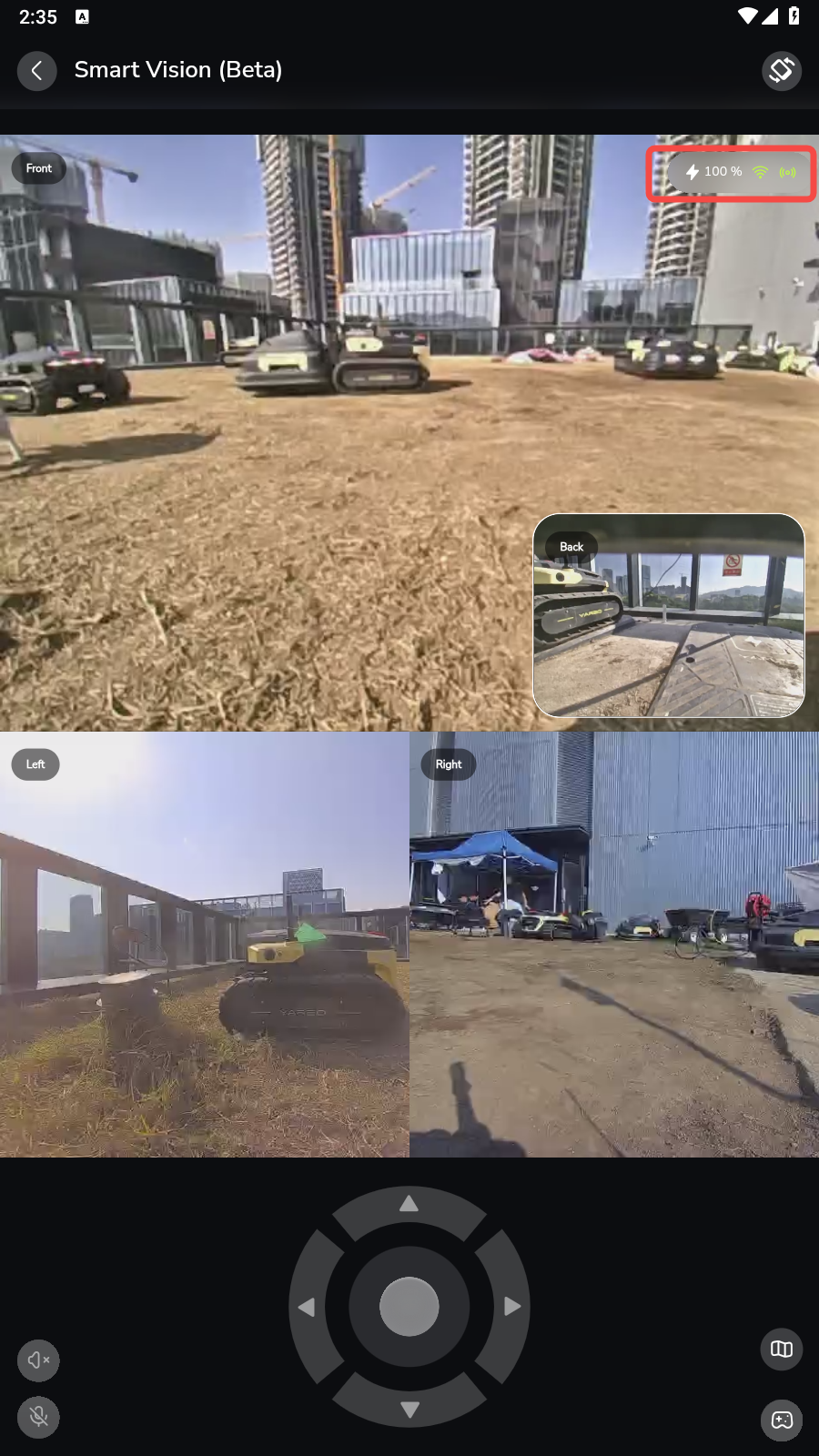

| In the Smart Vision interface, you can now see Battery /Network / RTK status directly on screen, so you don’t need to go back to the main screen to check basic state. |

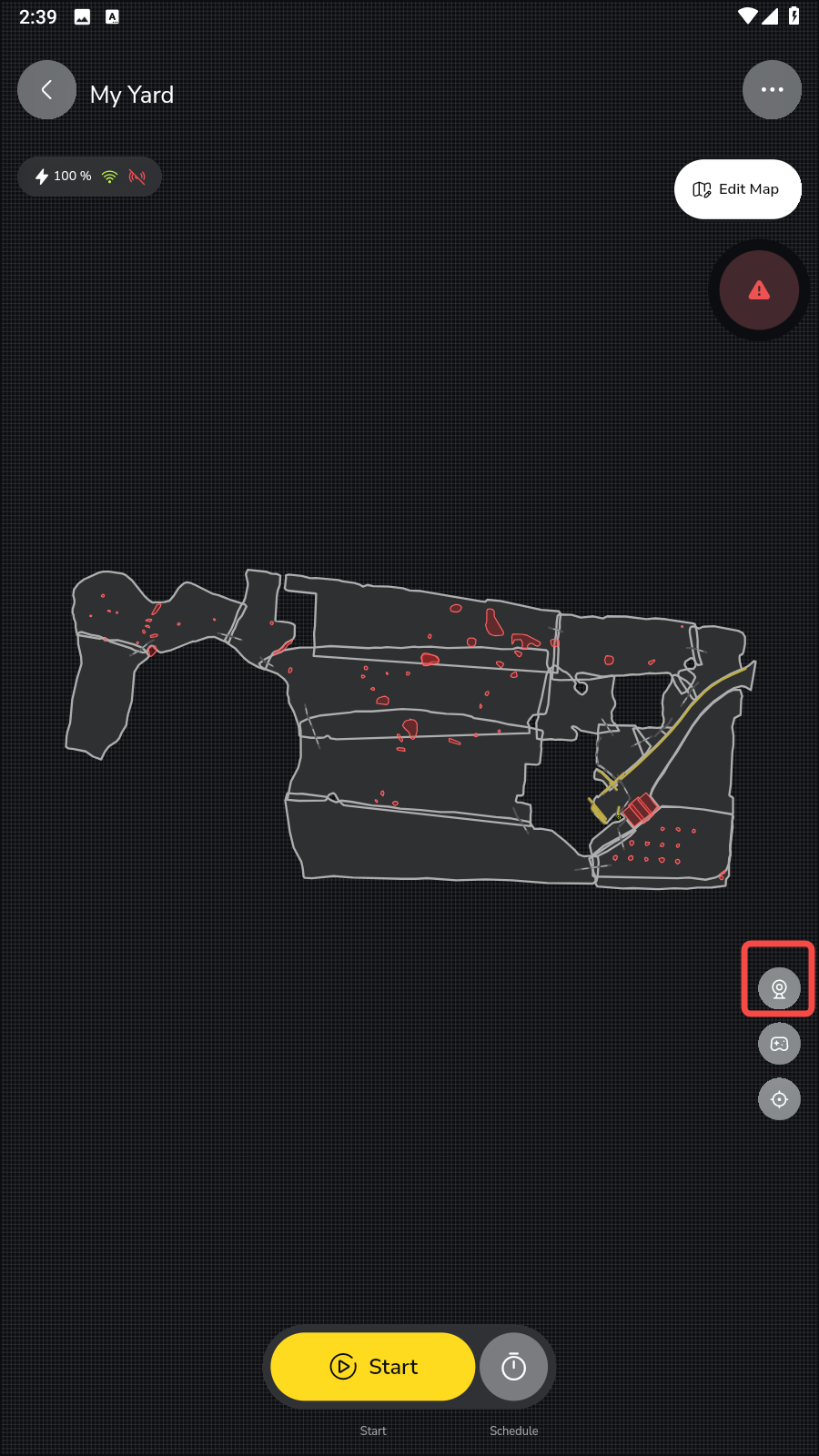

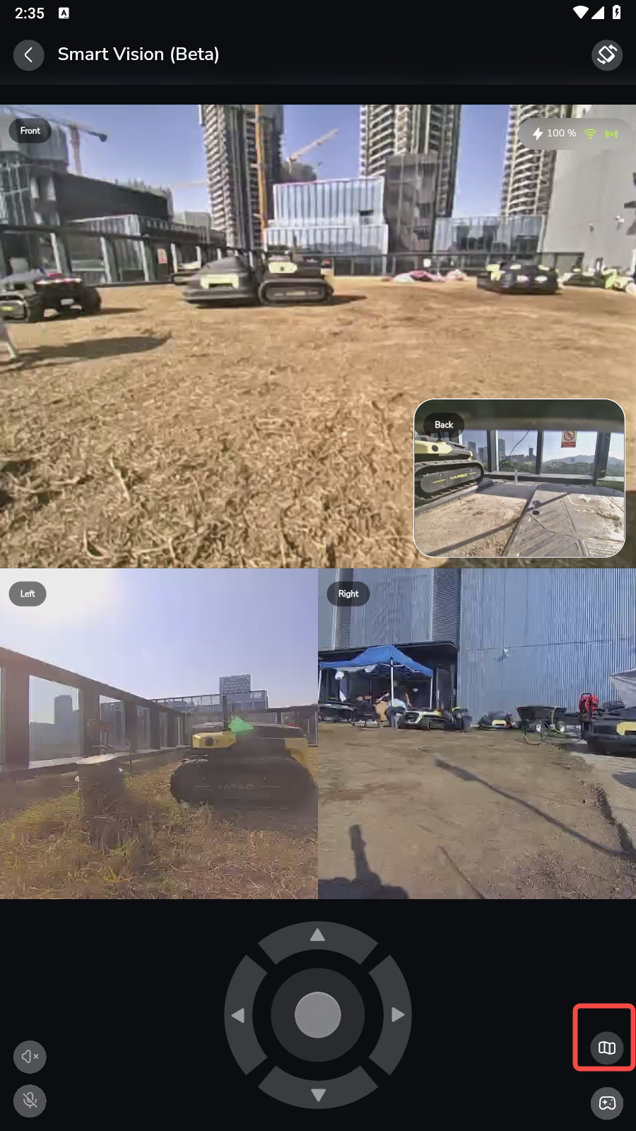

A Jump button has been added in both Smart Vision and Map View. From Smart Vision view, tapping this button during an autonomous plan takes you straight to the map view. Conversely, there is a button in map view that allows you to jump directly to Smart Vision. |

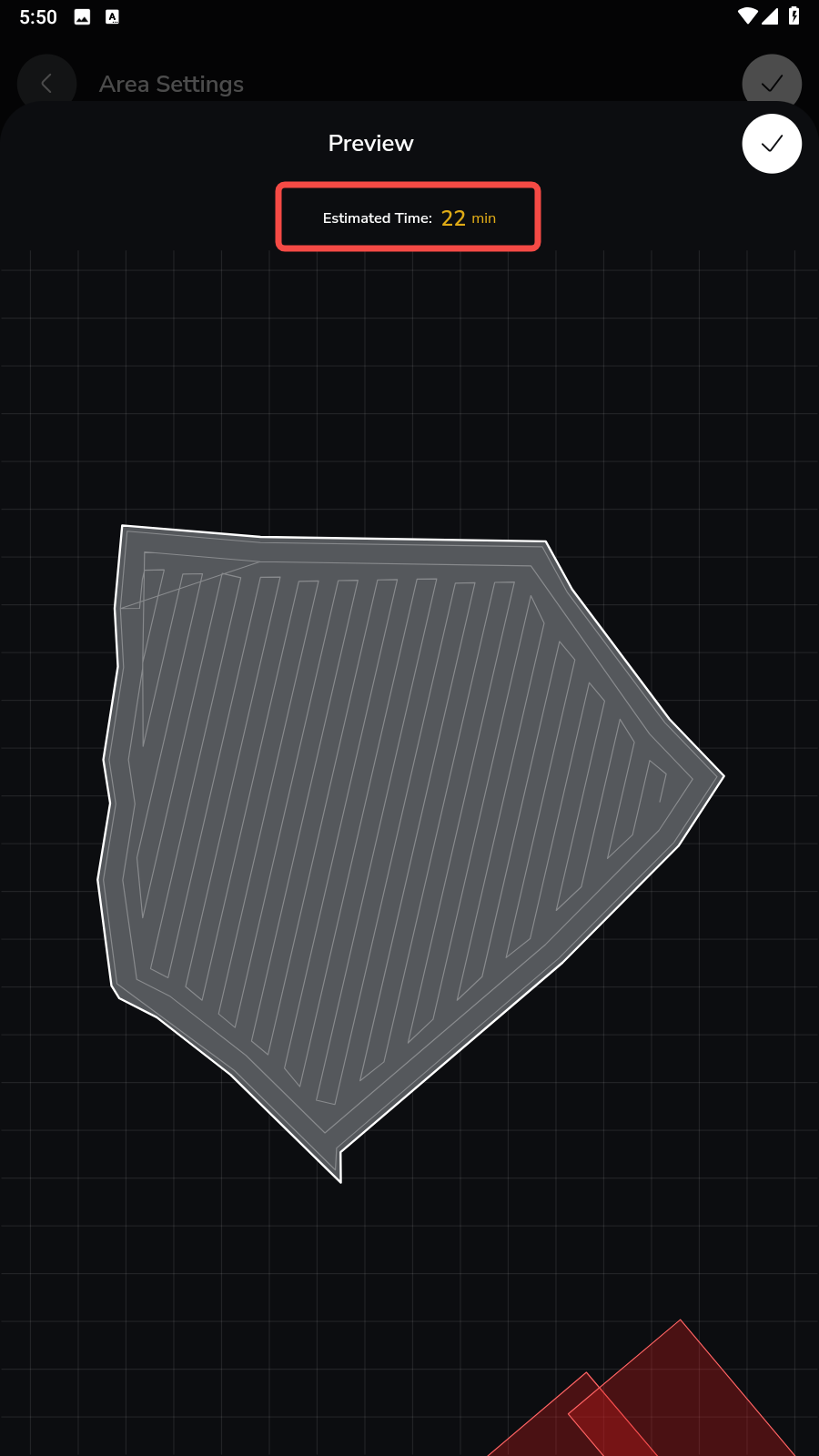

| In the area settings preview page, you can now view the estimated operation time. |
