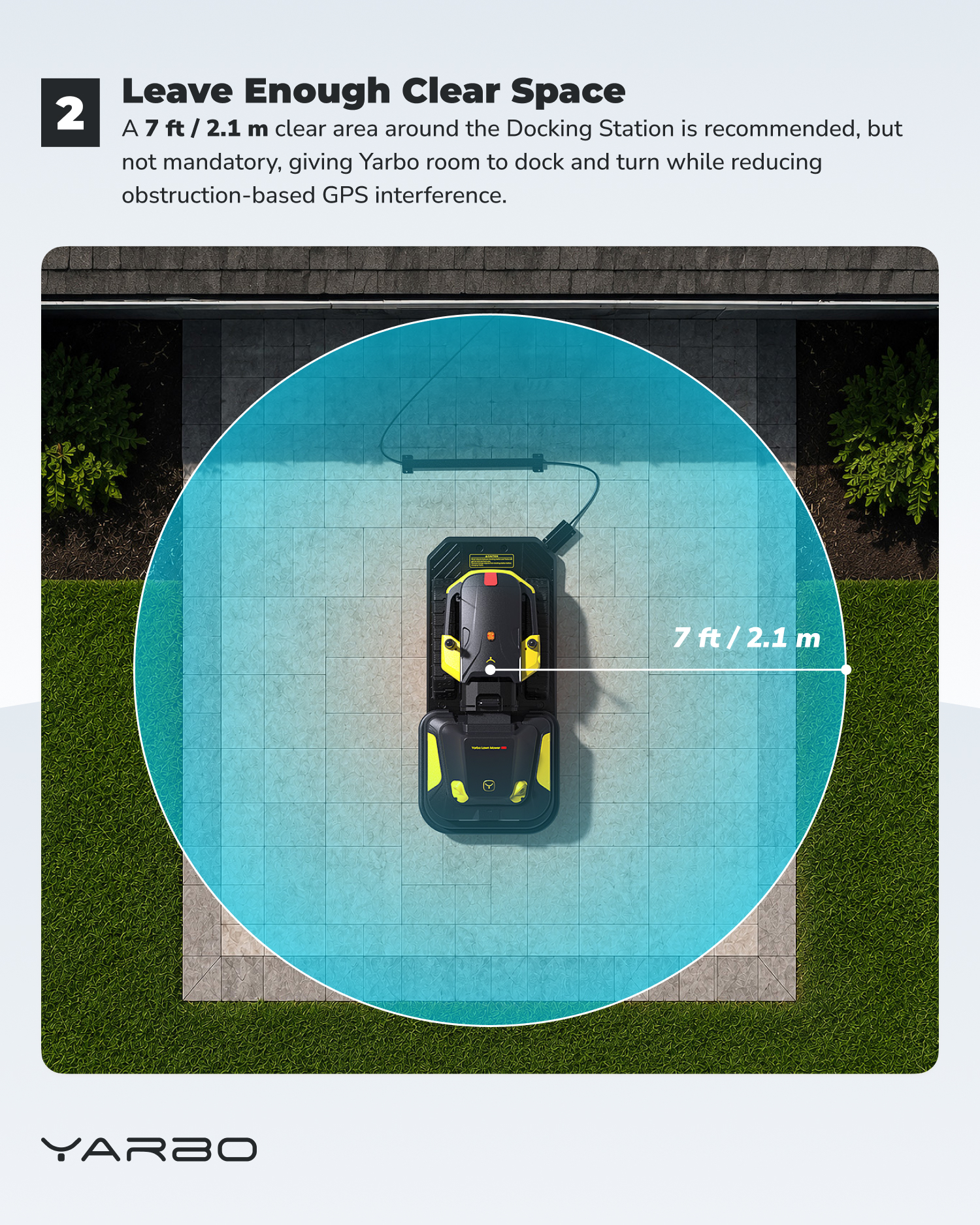

- Clear Space: Leave about 7 ft / 2.1 m around the Docking Station when possible.

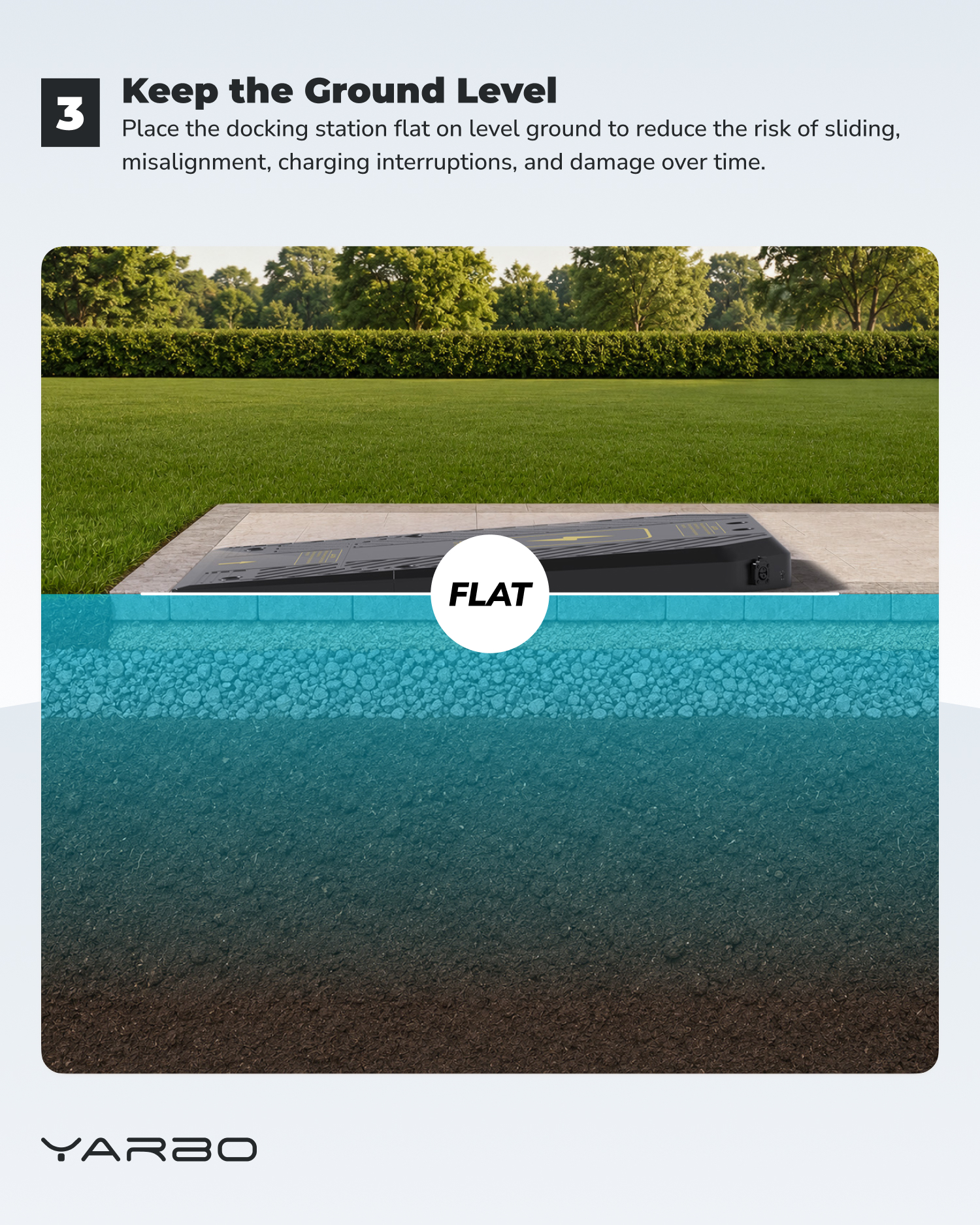

- Level Ground: Place the Docking Station on a flat, level surface.

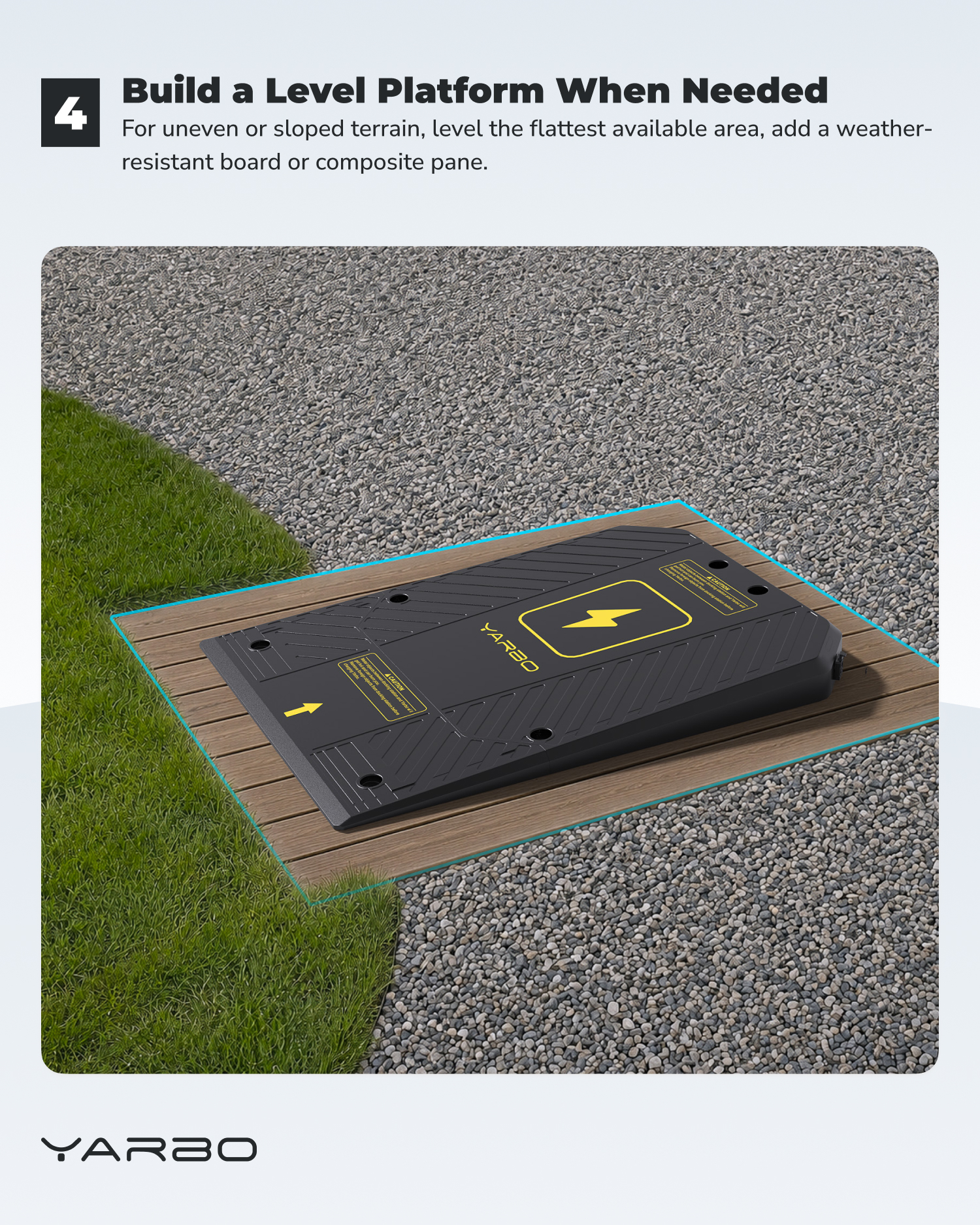

- Uneven Terrain: Build a level, weather-resistant platform if needed.

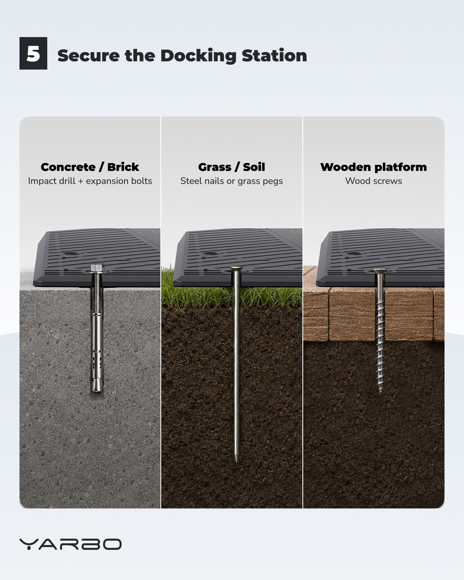

- Secure Installation: Use the appropriate hardware for concrete, brick, grass, soil, or wood.
