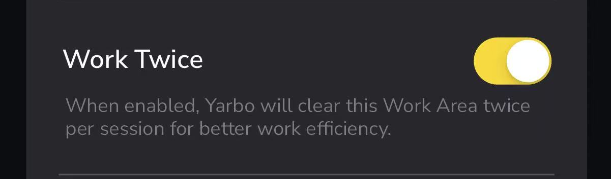

When Work Twice is enabled, Yarbo performs two consecutive passes over the same work area in a single session. The first pass handles bulk snow removal, while the second pass cleans up any residual snow for a smoother, more complete result.
Work Twice is especially useful for heavy, wet, or layered snow where a single pass may leave thin strips or uneven coverage.
Note: Work Twice is off by default and is not supported on slopes.

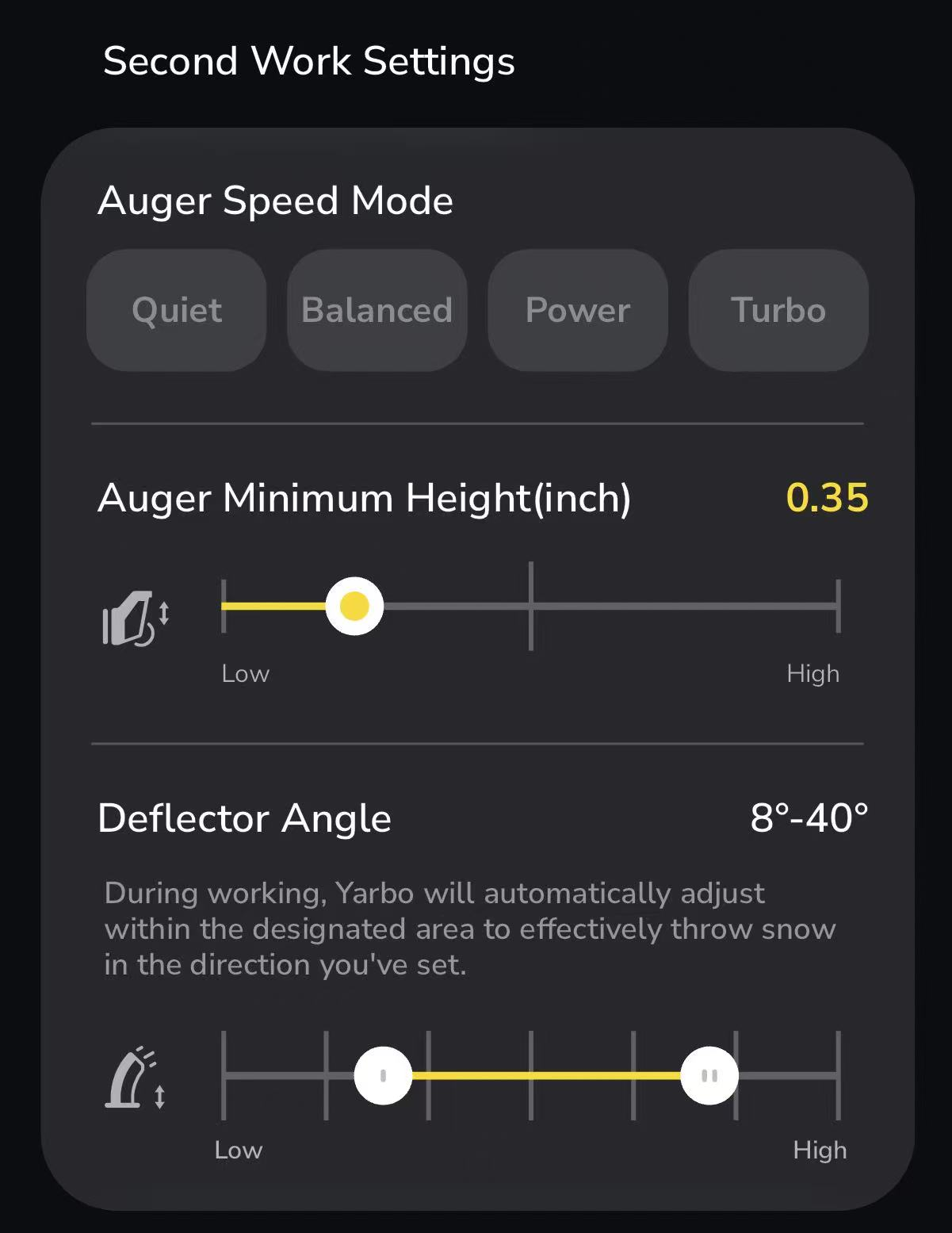

These settings work the same way as the standard area settings, but apply only to the second pass — letting you fine-tune second-pass behavior separately from the first.

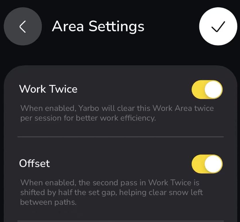

The Offset feature shifts the second pass laterally relative to the first pass, allowing Yarbo to clear the strips between the first pass's tracks rather than retracing the exact same lines.
When Offset is enabled, Yarbo's second pass is automatically shifted by half the first pass's path spacing (Gap). This places the second pass directly between the first pass's tracks, covering any narrow strips of snow that the first pass may have missed.
