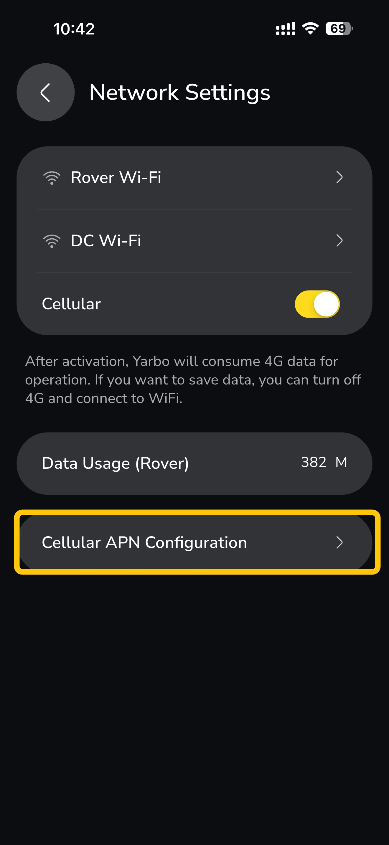

Manually configure the APN (Access Point Name) settings for your SIM card. |

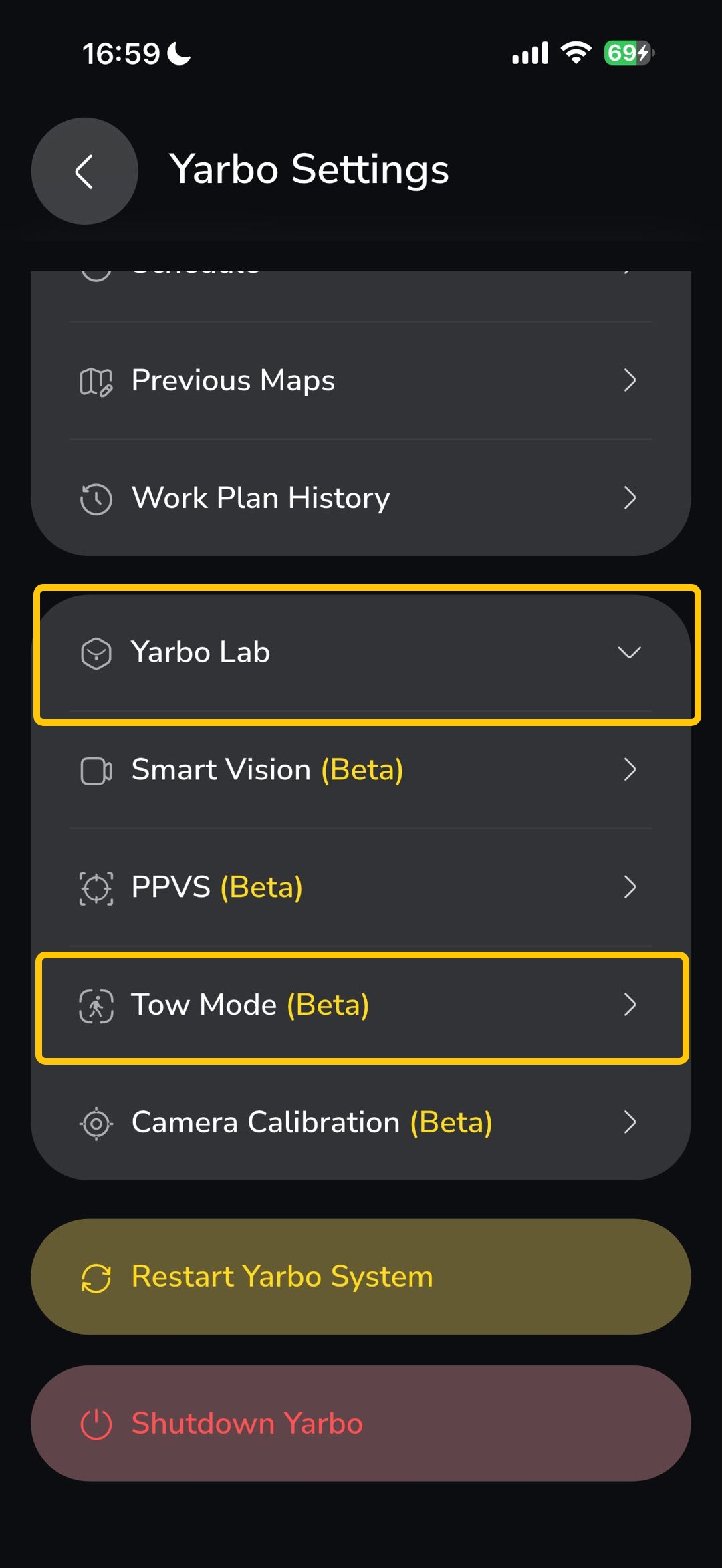

With Tow Mode (Beta), Yarbo can tow compatible tools and equipment to perform various towing tasks, such as lawn maintenance and yard care operations. |

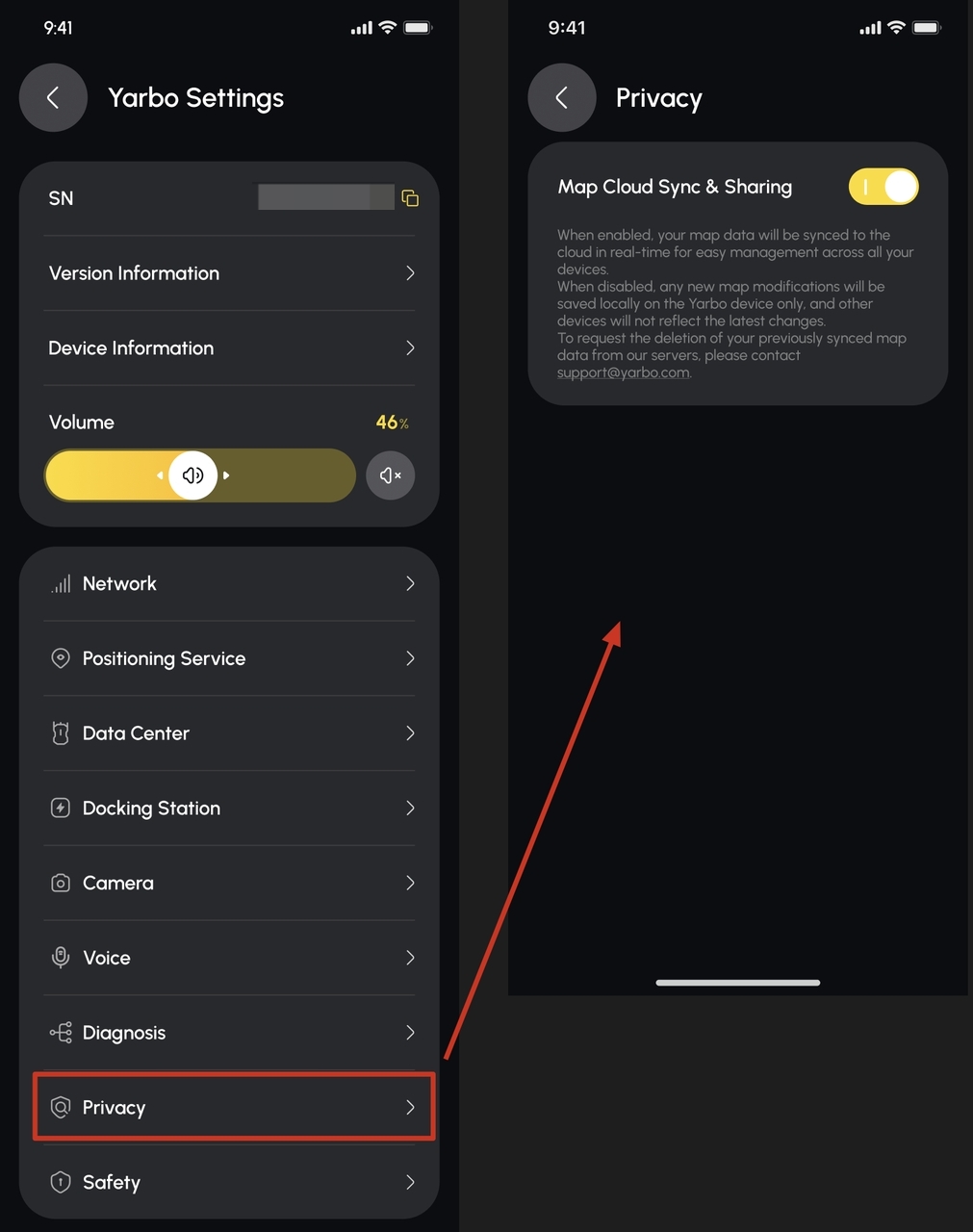

You now have more control over your data. We've added a specific privacy toggle for uploading your map backups.
